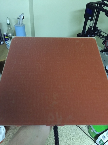

I have seen the same PEI bubbling issue on my machine. Replacement bed being sent out under warranty. Thanks for the excellent customer support.
Mine when cold, looks even worse once up to temp.

**Author:** ![MikeO](https://avatars.discourse-cdn.com/v4/letter/m/b487fb/32.png) [@MikeO](https://forum.lulzbot.com/u/MikeO)\
**Post date:** [August 3, 2015, 10:35pm UTC](https://forum.lulzbot.com/t/taz-5-pei-plate-bubbling/1658/33 "2015-08-03T22:35:53Z")
Mine looks similar to yours when cold, and you’re right it gets worse when hot. I’d been printing every day recently without blistering problems, then took a 2-week break to go attend to family matters. When I got back, I immediately started getting blistering with a similar pattern, primarily around the outside edges, and it got worse with every heating/cooling cycle. It may be that my daily use kept the problem at bay until the 2-week break, I don’t know.
I sent them an email with a picture today, and got a reply within about five minutes! I supplied them with the info they requested, and they will get a replacement on the way out to me quickly. SUPER customer support!
[edited:] Within 24 hours of my first email to them I had an RMA # and a FedEx tracking link showing FedEx already had the part and was processing it. Support doesn’t get better than that!

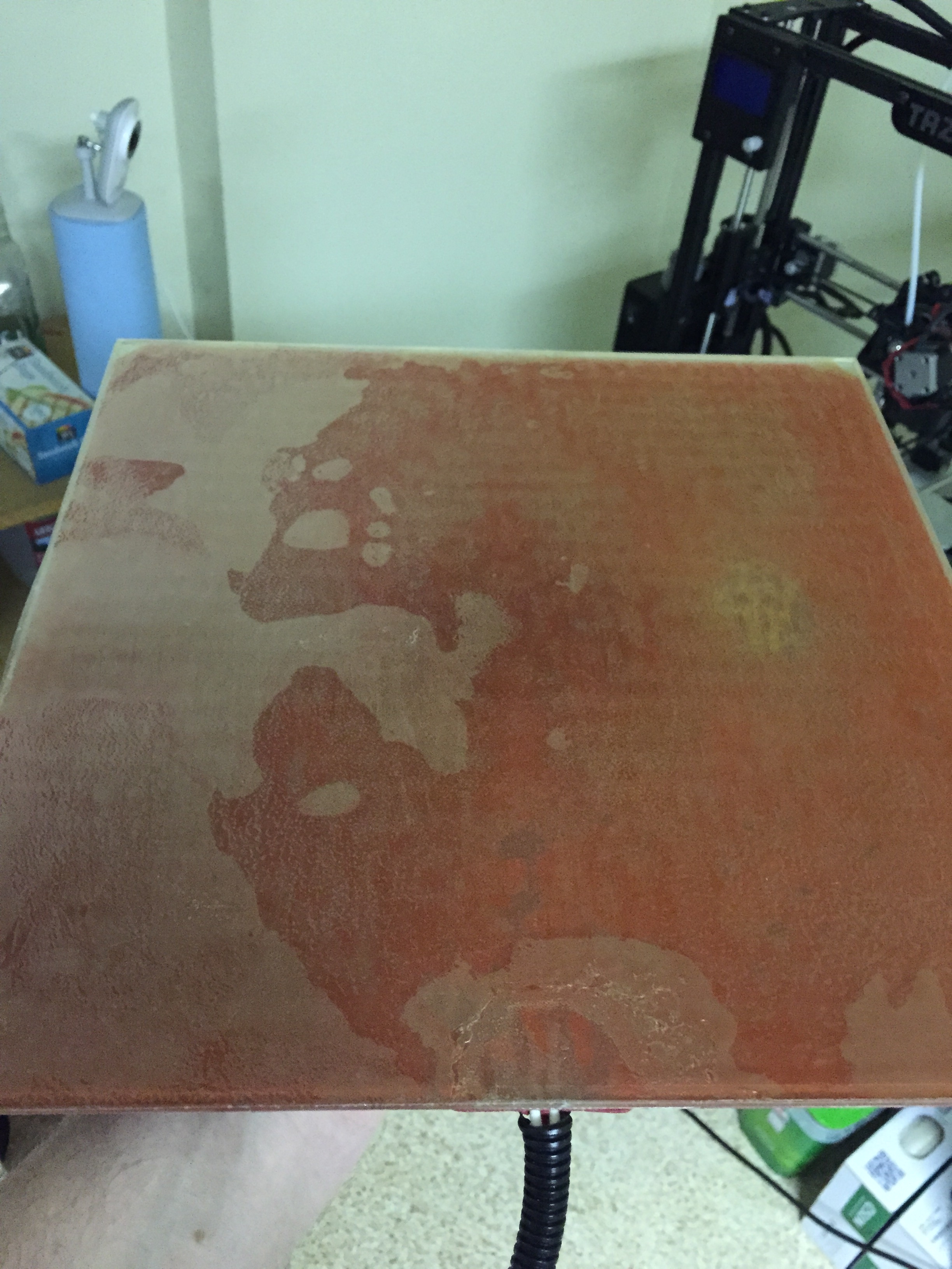

**Post date:** [August 7, 2015, 1:01pm UTC](https://forum.lulzbot.com/t/taz-5-pei-plate-bubbling/1658/34 "2015-08-07T13:01:39Z")
I received my replacement bed yesterday and upon opening the box discovered the bed was broken in half. It was very poorly wrapped in bubble wrap. Waiting to hear back from support.

**Post date:** [August 7, 2015, 4:30pm UTC](https://forum.lulzbot.com/t/taz-5-pei-plate-bubbling/1658/35 "2015-08-07T16:30:27Z")
