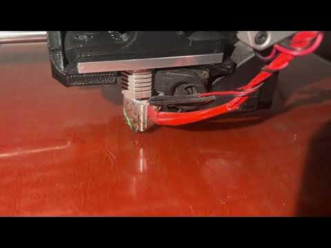

Working with my Taz 5 that I inherited awhile back and running into issues. I replaced the PEI sheet and had good success with prints. I haven’t used the printer in a few months and just tried using it again. I got one good print using PLA then the next print won’t even start printing. It looks like the first layer is almost clear then if there’s color it starts to drag it around. How can it change between one print to the next?
i read somewhere here about sanding the PEI. Is this a possible solution? I’m printing PLA at 230 with the bed at 60 I believe. Should I change my temps?
any help is appreciated.

![IMG_7914](https://us1.discourse-cdn.com/flex020/uploads/lulzbot/original/2X/9/90a6b3ac8f96e9f702ea620ea96ba4f775686080.jpeg)Here’s a couple videos.
[](https://www.youtube.com/watch?v=gdAEjUEsR1Y)
[![](https://us1.discourse-cdn.com/flex020/uploads/lulzbot/original/2X/2/2cd398eae7965bd71d8a32e93adfb2188edf2758.jpeg "Bad adhesion 1") ](https://www.youtube.com/watch?v=c6nvMsvHc4M)

That’s heat creep causing underextrusion.
PLA with that toolhead is a bad match. 2.85mm with a hard, brittle filament. Single hobbed bolt for a drive gear with a brittle filament. Bad part cooling with that single axial fan. Bad heatbreak cooling with the small blower fan…
The Taz 5 in stock configuration works pretty good with ABS, it was not designed for PLA (which wasn’t even that common that long ago).

Ah…. That makes sense then why there was a bunch of ABS with it and not PLA. I will try to print some ABS instead and see if that is part of the problem.
Also, I was checking the esteps with the PLA and only 20mm extruded when I commanded 100mm. Would that be because of the single drive extruder and PLA combo?
**Post date:** [January 12, 2026, 8:52pm UTC](https://forum.lulzbot.com/t/taz-5-poor-adhesion/27836/13 "2026-01-12T20:52:26Z")
You should still have 100mm of filament go through when trying to do 100mm. Single drive gear doesn’t affect that unless it’s malfunctioning due to heat creep, or the gears fill of chewed up filament from heatcreep jams.

Okay. I got rid of the PLA, cleaned the gear, and loaded some ABS. Gonna give it a shot.
