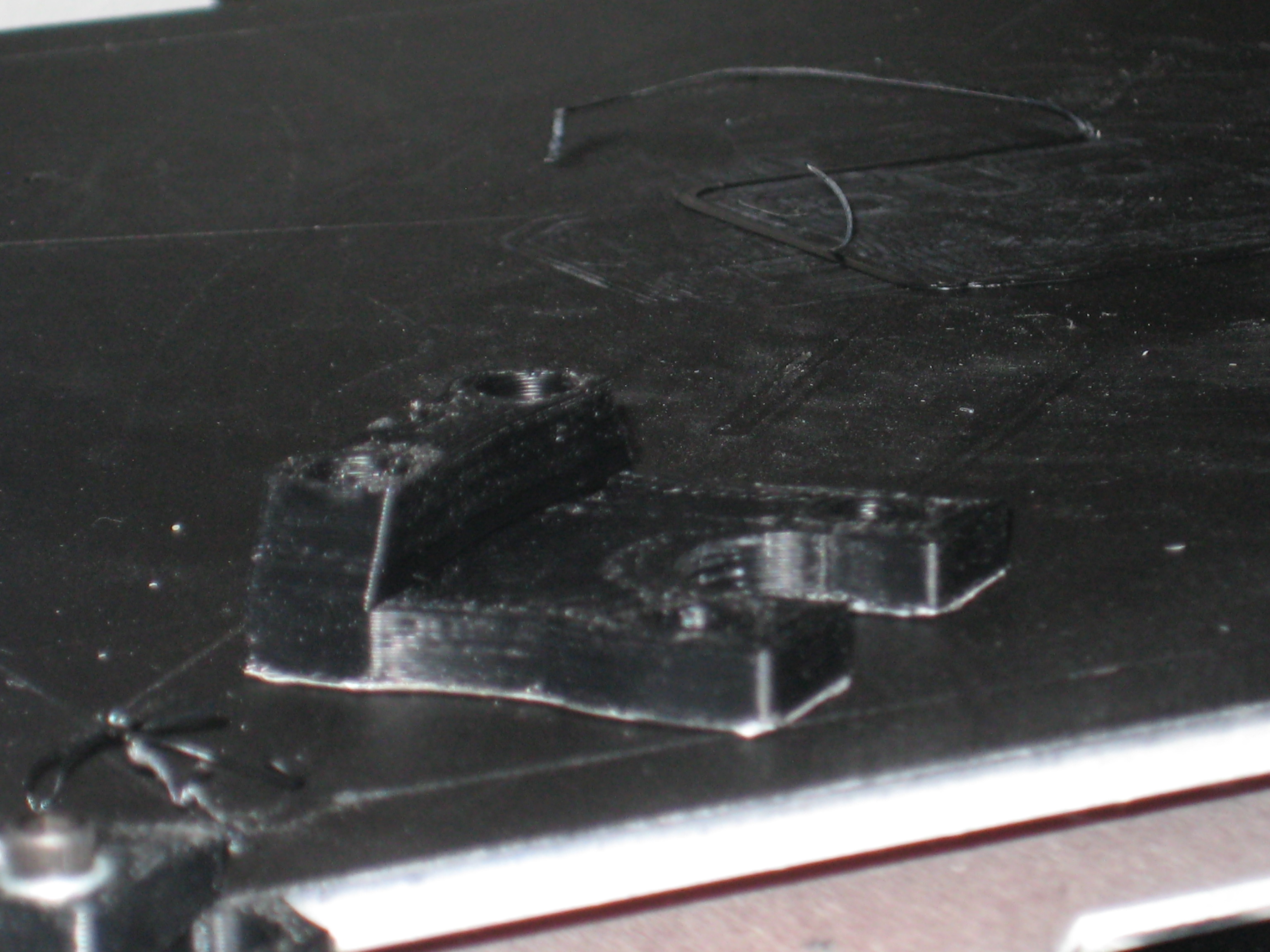

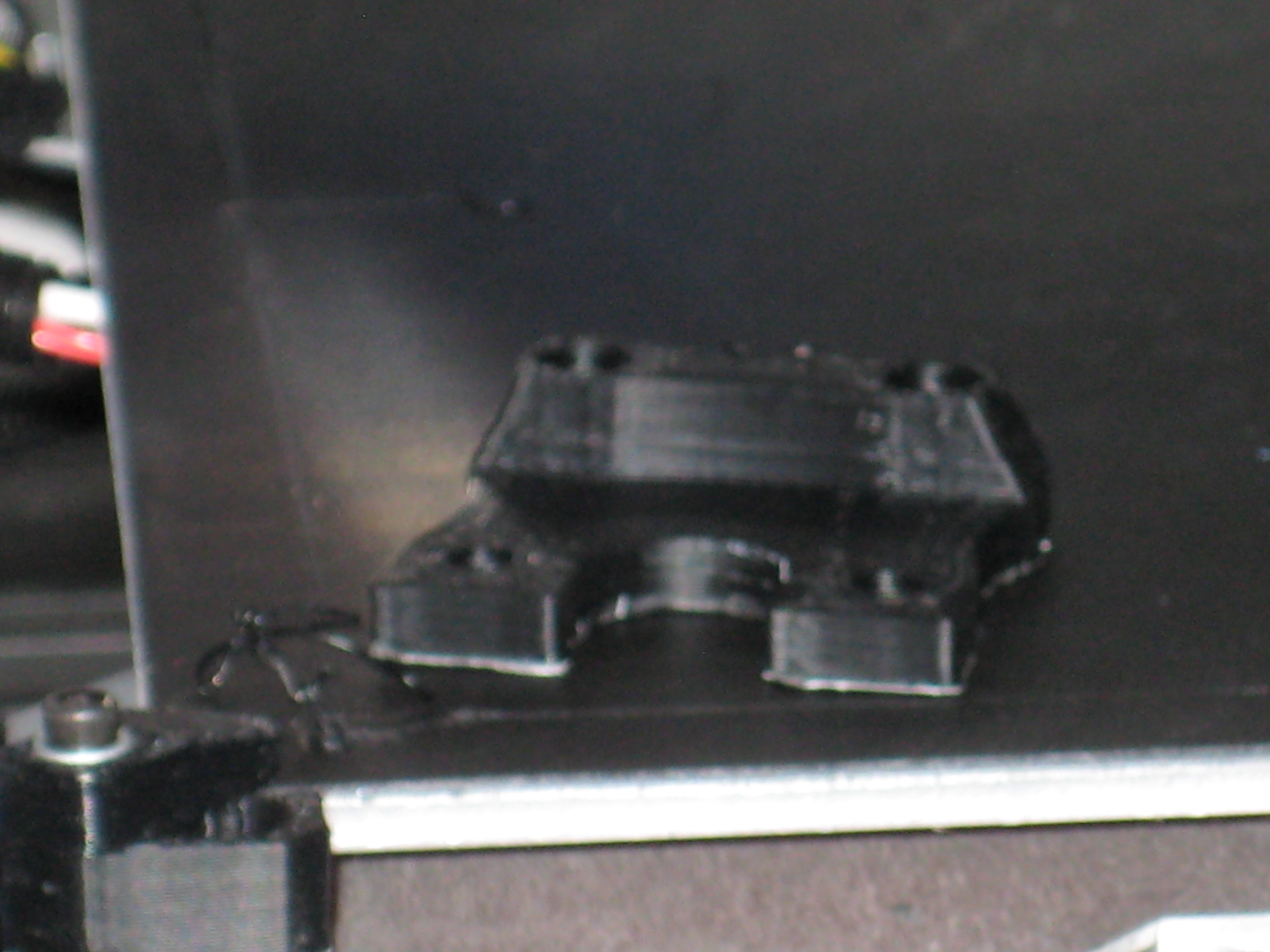

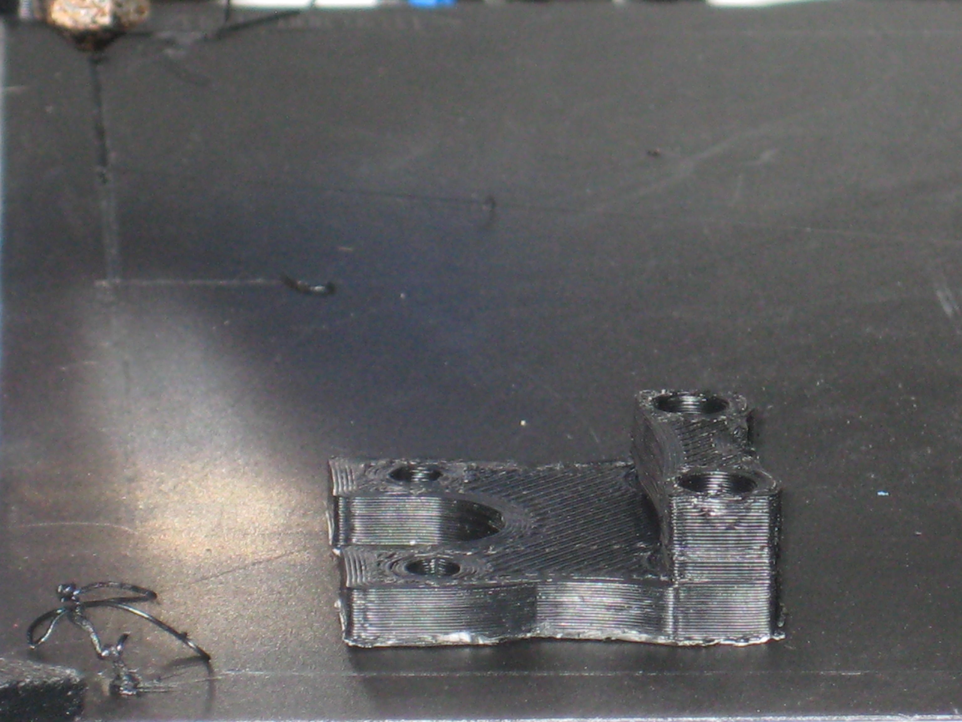

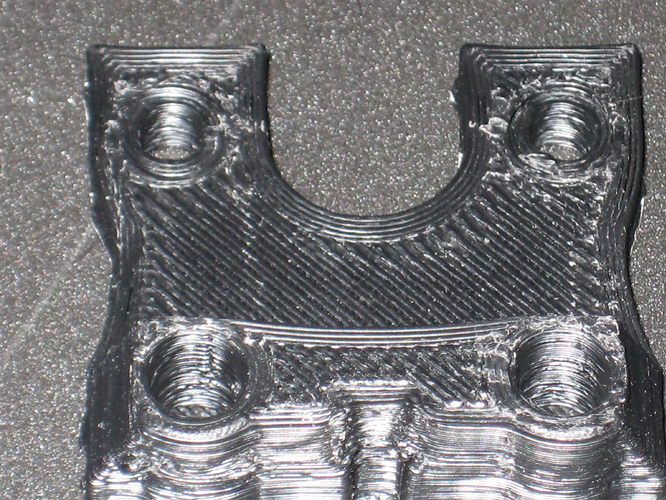

Sure, looks about like this:
 ![IMG_1998.JPG](https://us1.discourse-cdn.com/flex020/uploads/lulzbot/original/2X/c/c0bf1cecbdf6e316984a90dfd6eac6481be51bae.jpeg)
 ![IMG_1997.JPG](https://us1.discourse-cdn.com/flex020/uploads/lulzbot/original/2X/9/9177fd99e999b795327643eb6b7746dcdd042cf9.jpeg)
 ![IMG_1996.JPG](https://us1.discourse-cdn.com/flex020/uploads/lulzbot/original/2X/b/b310b0fd108193226c8f835cdfbad5b0d0c9bbf5.jpeg)
 ![IMG_1995.JPG](https://us1.discourse-cdn.com/flex020/uploads/lulzbot/original/2X/9/979ee3b4e0ec9a01725c5a7403afb5ceea4b7e79.jpeg)
 ![IMG_1993.JPG](https://us1.discourse-cdn.com/flex020/uploads/lulzbot/original/2X/9/9c024bb5c816bea579a331c9855ad259f1bb72cb.jpeg)
As you can see by that stray bit of 0.5mm extrusion, its a pretty small part. ABS, no cooling fan, so the upper layers with the notch cutout didn’t turn out so well. This is also the first print with my Anti Z wobble nut installed, and interestingly that has eliminated 100% of my Z wobble. It’s introduced a minor Z lifting error in corners which I am working on fixing, but even then, that’s less of an issue than the banding was. I’ll print a larger item with a large flat vertical surface once I make a few tweeks to the Anti wobble nut. Right now it can rotate too freely (about 1/32nd of a turn) Not bad for a really really fast print though.
