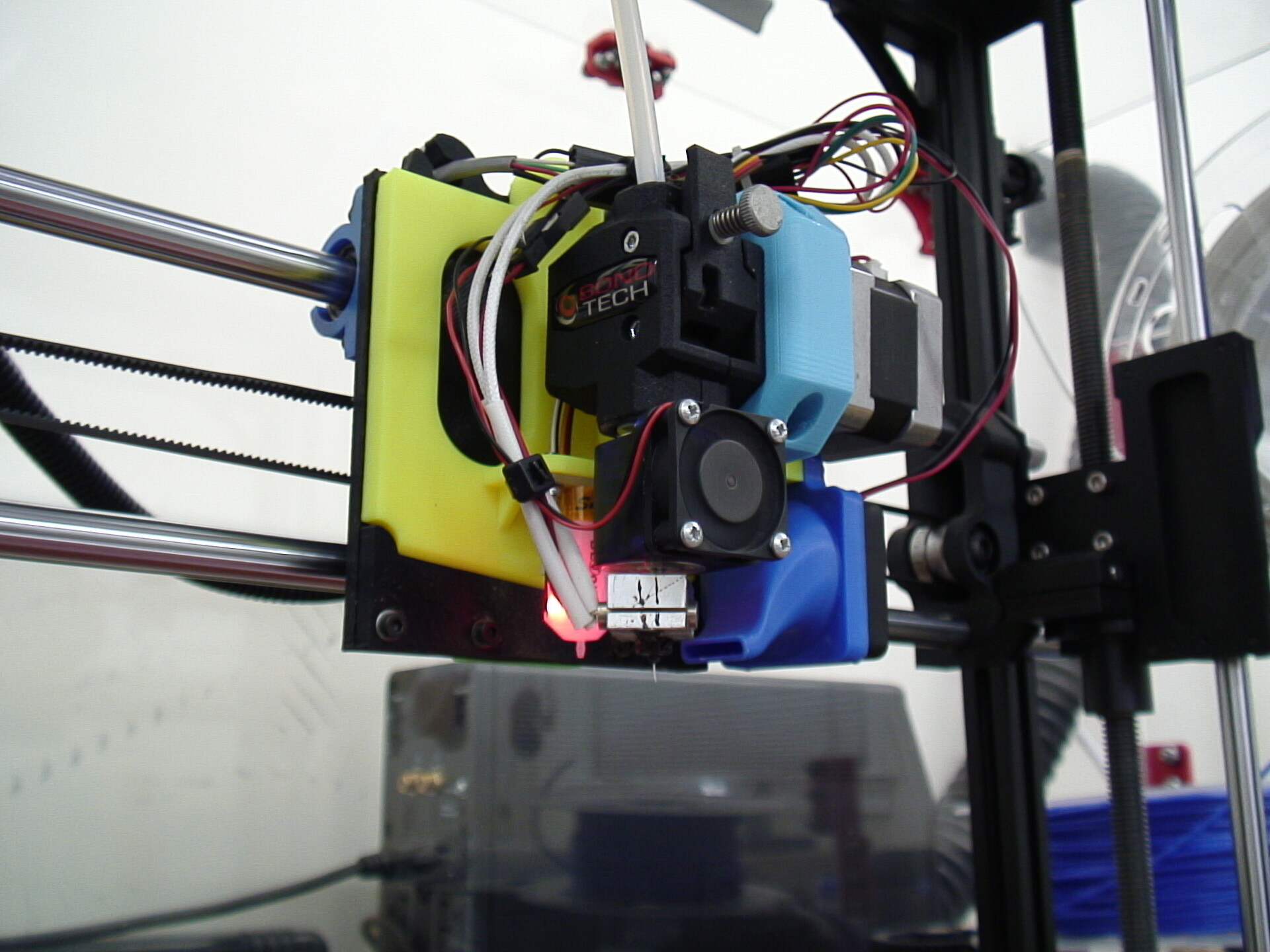

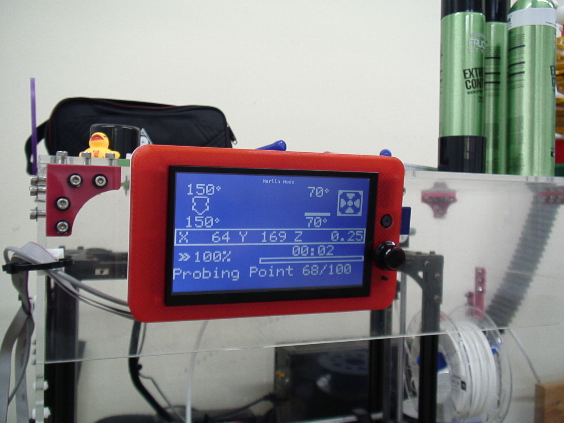

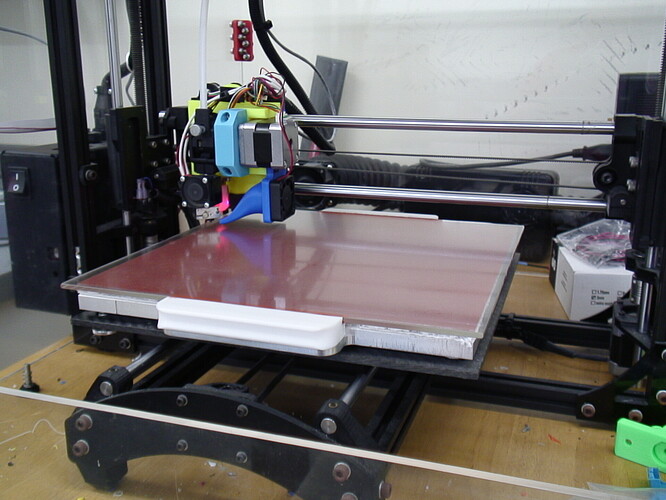

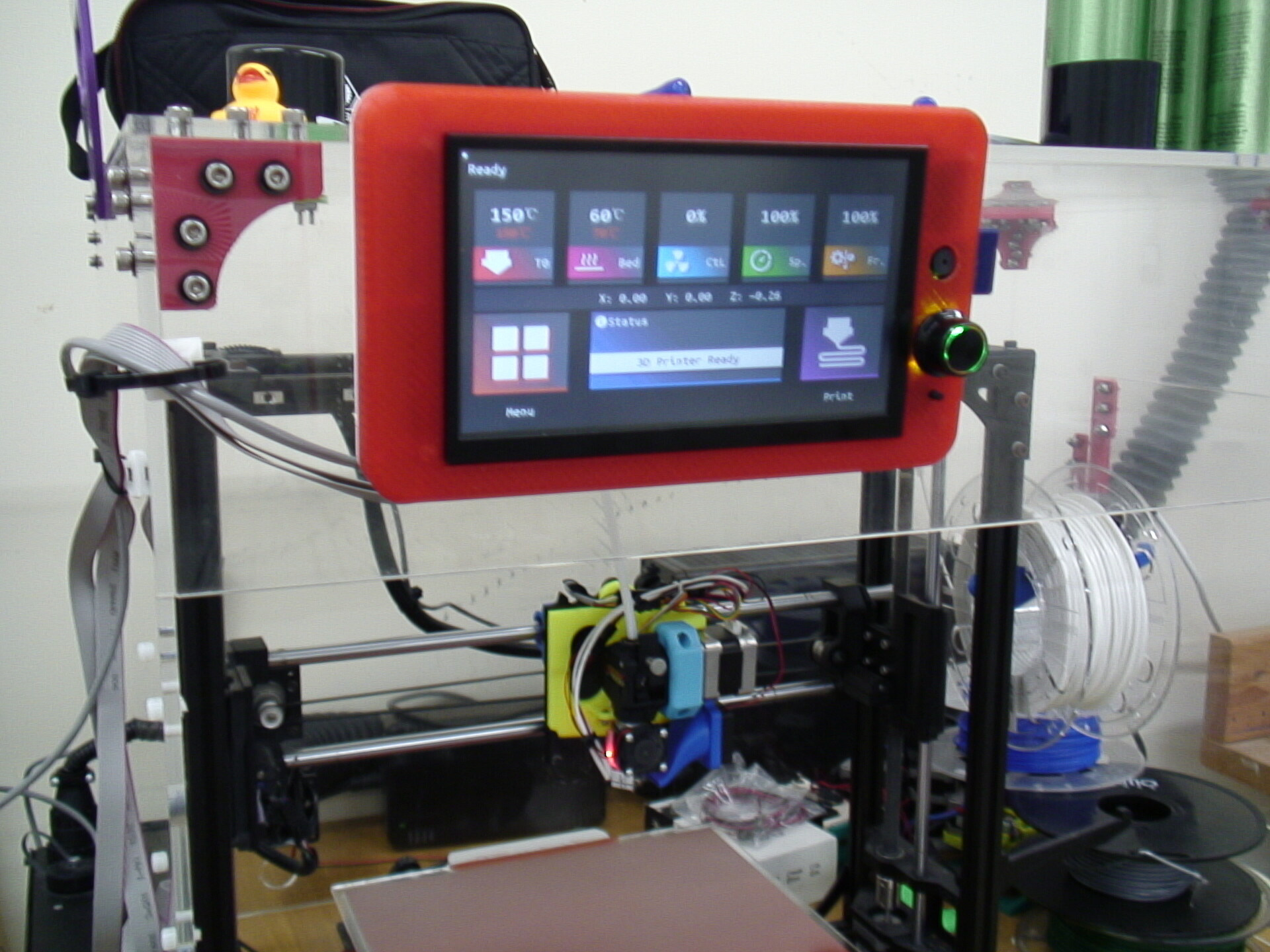

![DSC00699](https://us1.discourse-cdn.com/flex020/uploads/lulzbot/original/2X/b/b2337446a19ca07e2e8f8534d8103b5fe1cdf3d4.jpeg) ![DSC00695](https://us1.discourse-cdn.com/flex020/uploads/lulzbot/original/2X/a/a5b6b371d87ff380426c02f0a4b0af122faf3318.jpeg) ![DSC00697](https://us1.discourse-cdn.com/flex020/uploads/lulzbot/original/2X/4/4ed400a42d586d0b299c5ee92e5d81210dfdcf22.jpeg) ![DSC00694](https://us1.discourse-cdn.com/flex020/uploads/lulzbot/original/2X/2/2ff4ef50c8fbf228e8d7f54f4ebbdc3e897b3044.jpeg)
Attached are a few pictures of my custom mount, removable build bed and bigtreetech tft70 v3 control. I show the color touchscreen mode and then the marlin mode. (12864 emulator). You can see I’ve mounted the bltouch directly behind the extruder, so no X offset. It is 26mm behind in Y so you can mesh the entire bed surface except the first 26mm in Y.

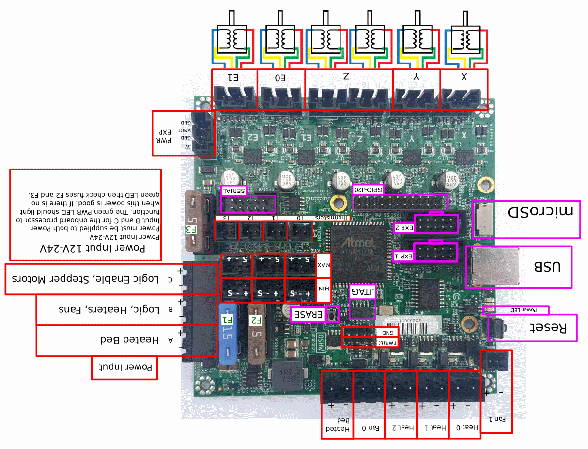

In the pins file I’ve revised a few things to allow the case cooling fan to run off of HEAT2 output of Archim. And also to setup an analog input for the PT100 amplifier output for E0’s temperature sensing. The variant.cpp has some changes as well to achieve this, around line 317. This places the input for the amplifier on pin 20 of the GPIO connector on the archim board. I also switched servo 0 from pin 20 to pin 19 of the same connector, this is where the servo connection for the BLtouch goes. BLtouch gets power from the 5v output at near the upper left of the picture shown. The final connection for BLtouch is the Z stop minimum input. You will no longer use the Z axis endstop and it is replaced by the BLtouch probe. More to come tomorrow. Note the picture is upside down because that is how it is mounted in the taz5 case.
 ![Archim2_connections](https://us1.discourse-cdn.com/flex020/uploads/lulzbot/original/2X/e/ed2ac823d1240e83a4ac81c39562b27f124dbbfa.png)

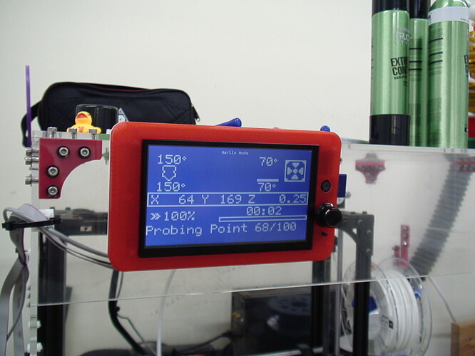

Update. I am struggling with this touchscreen. The marlin emulator mode works perfectly. But the touchscreen relies on a serial connection and I haven’t been able to get it reliable. So currently I can’t recommend this screen. The easy thing to do would be to just keep the stock Taz5 controller. But I like to beat my head against the wall, so I haven’t given up yet!
**Author:** ![billyd](https://avatars.discourse-cdn.com/v4/letter/b/ed655f/32.png) [@billyd](https://forum.lulzbot.com/u/billyd)\
**Post date:** [April 28, 2021, 12:43am UTC](https://forum.lulzbot.com/t/taz-5-with-archim2/23263/7 "2021-04-28T00:43:30Z")
Ok great news I have it fully working now. Attached are the finalized config files I used, please ignore previous ones. In the first post, you will also need to refer to the changes I made to the archim2 pins file as well as the changes made to variant.cpp (also found in the first post). This is assuming you are copying my configuration exactly, which consists of a BLtouch, the Taz 5 printer, the BTT touchscreen, a bondtech qr extruder, and the Archim2 mainboard. Please post any questions and I will try to help.
