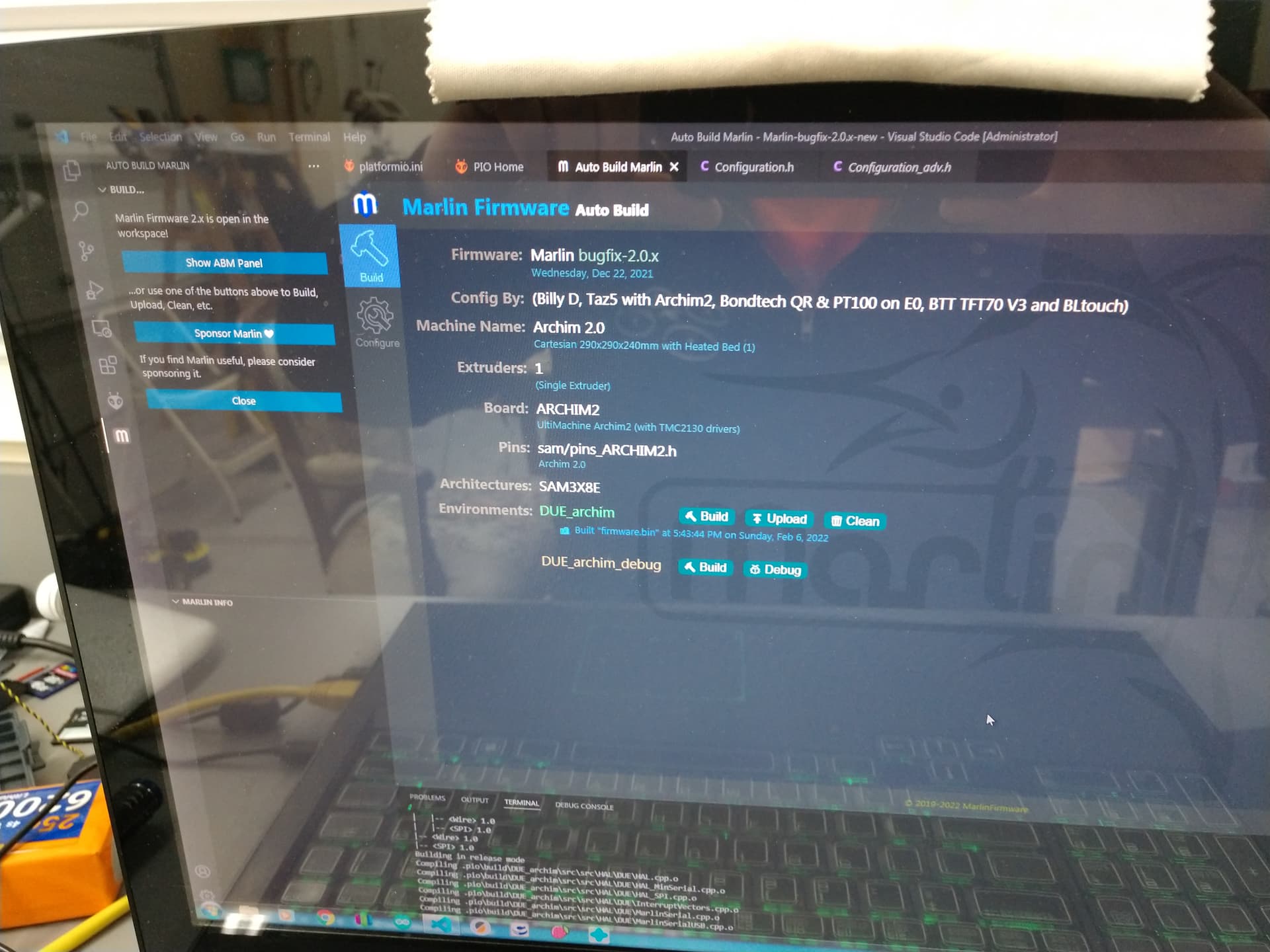

Alright so I am now attempting to upload to the printer over vs code, and I am running into more issues. When I go to upload to the printer after I erase the firmware on the printer The code is compiling, but I am getting this error when it goes to upload to the printer:
Looking for upload port…
Auto-detected: COM6
Uploading .pio\build\nanoatmega328\firmware.hex
avrdude: stk500\_recv(): programmer is not responding
Could there be an issue with my board? I have a feeling I am doing some thing dumb and I just cannot figure what it is.
### Author: ![billyd](https://avatars.discourse-cdn.com/v4/letter/b/ed655f/32.png) [@billyd](https://forum.lulzbot.com/u/billyd)
#### Post date: [February 6, 2022, 10:50pm UTC](https://forum.lulzbot.com/t/taz-5-with-archim2/23263/32 "2022-02-06T22:50:08Z")
No it’s trying to build nanoatmega328. That’s not right. It should say something like .pio/build/Due\_Archim Are you using auto build marlin? Also make sure that after you do the erase/reset you disconnect the usb from your computer. Also power cycle the archim2 (turn your printer off and on) then reconnect usb to your computer. Check in device manager and tell me what it calls the device now connected to that usb port.
Also the file it should be creating is a .bin file, not a .hex file
#### Post date: [February 6, 2022, 10:58pm UTC](https://forum.lulzbot.com/t/taz-5-with-archim2/23263/33 "2022-02-06T22:58:30Z")
Should look something like this when you are running Auto Build Marlin:

Okay I am now using auto build Marlin. For some reason though i I cannot get it to load your .ino file. It just keeps compiling for that incorrect printer platform. I figure it is an issue with where im compling the code so hopefully I can figure it out.
### Author: ![TheShike01](https://avatars.discourse-cdn.com/v4/letter/t/4bbf92/32.png) [@TheShike01](https://forum.lulzbot.com/u/TheShike01)
#### Post date: [February 6, 2022, 11:59pm UTC](https://forum.lulzbot.com/t/taz-5-with-archim2/23263/35 "2022-02-06T23:59:50Z")
I am getting this error now when I compile just the .ino file:
Error: Unknown environment names ‘DUE\_ARCHIM’. Valid names are ‘include\_tree’
Am i missing a driver or library possibly?
#### Post date: [February 7, 2022, 12:19am UTC](https://forum.lulzbot.com/t/taz-5-with-archim2/23263/36 "2022-02-07T00:19:26Z")
You don’t have the marlin project loaded into platform io. Watch the teaching tech video again and follow as he opens up the marlin folder.
You don’t need my ini file. Just open the platformio marlin project per the teaching tech video. The change the platformio.ini so the default enviroment is DUE\_ARCHIM. And make sure the directories in the ini file should read Marlin (assuming that’s where your code is and that’s how it unzips). It’s also the folder where your modded configuration.h and \_adv.h files are.
After that open Auto Build Marlin and it should look similar to the photo I posted. Then build and upload.
