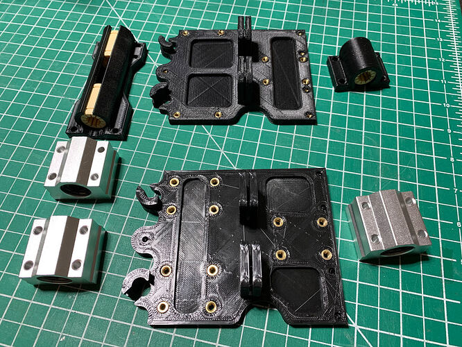

After running for a few years, grinding noise and all, I noticed the prints getting worse and worse. The X pillow block was shot and had a lot of play. The wear is eccentric and diagonal, suggesting bad alignment from the start. I built a new X carrier and replaced the plastic bearing with metal linear bearings, making sure the (M4) thread inserts were perfectly aligned. Night and day.
I had several photos but it will only allow me to upload one…
 ![IMG_1593](https://us1.discourse-cdn.com/flex020/uploads/lulzbot/original/2X/2/2ea508f800a0ea5e14ed18ae87430fb3787ecaa5.jpeg)
