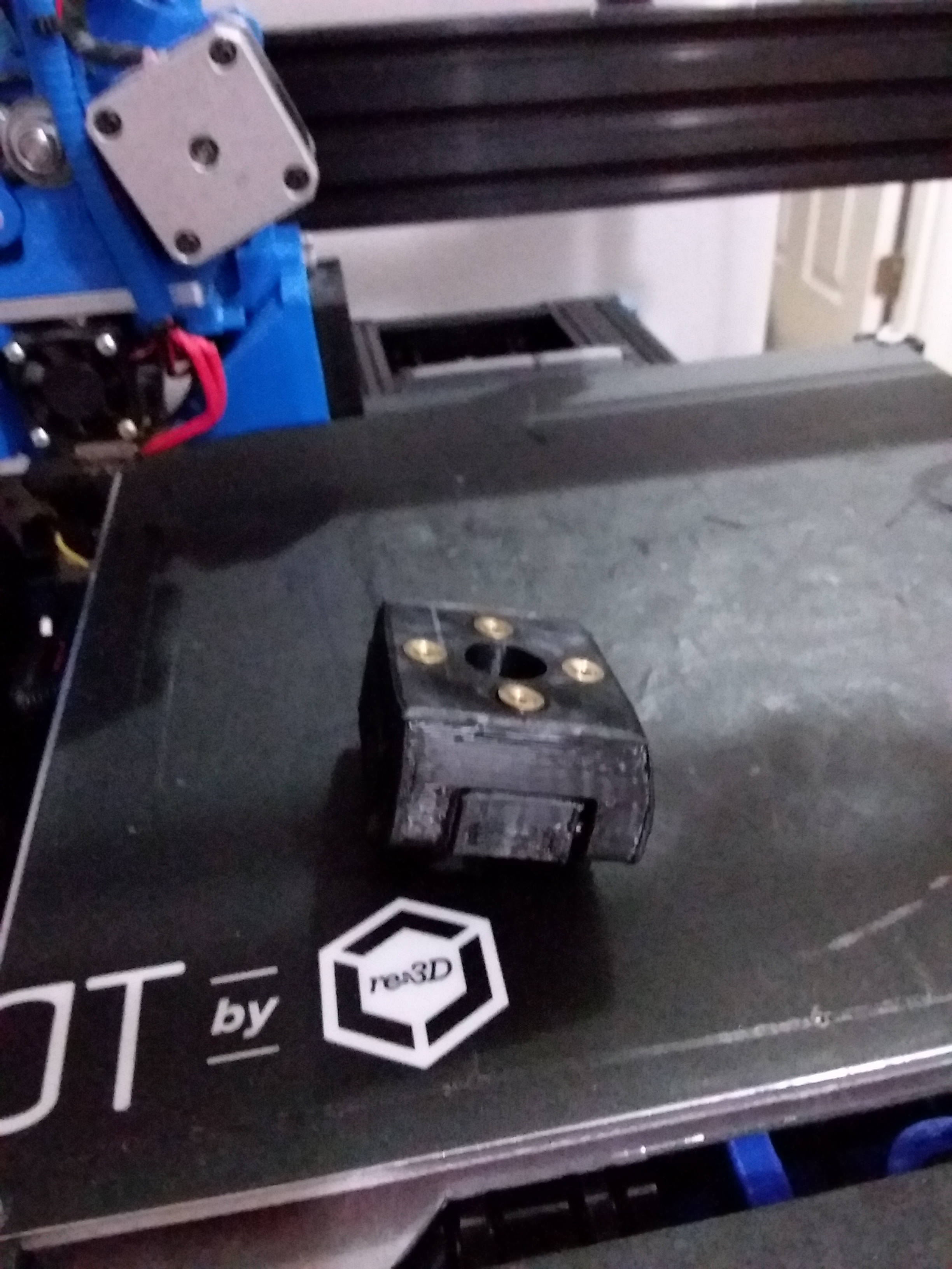

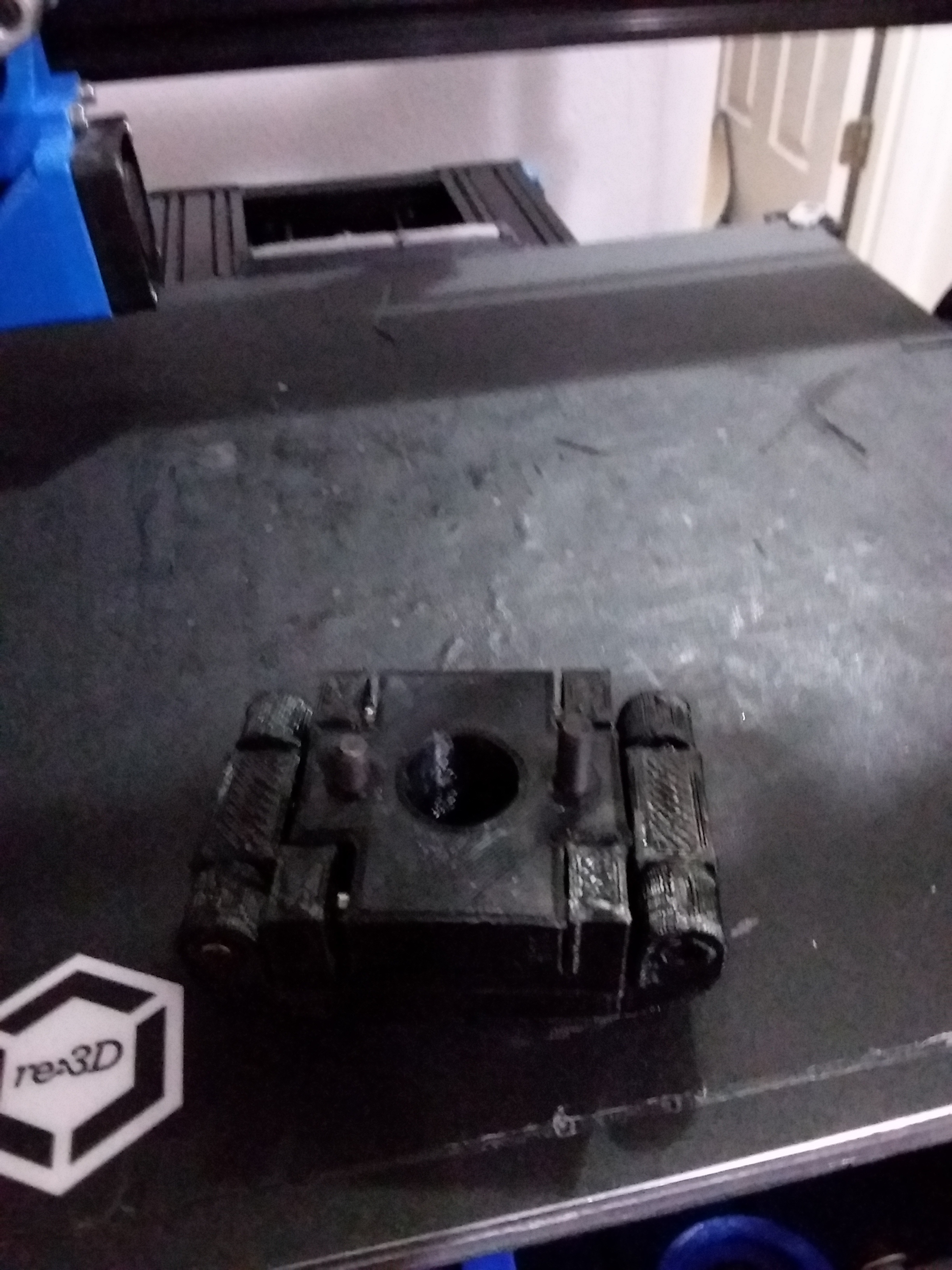

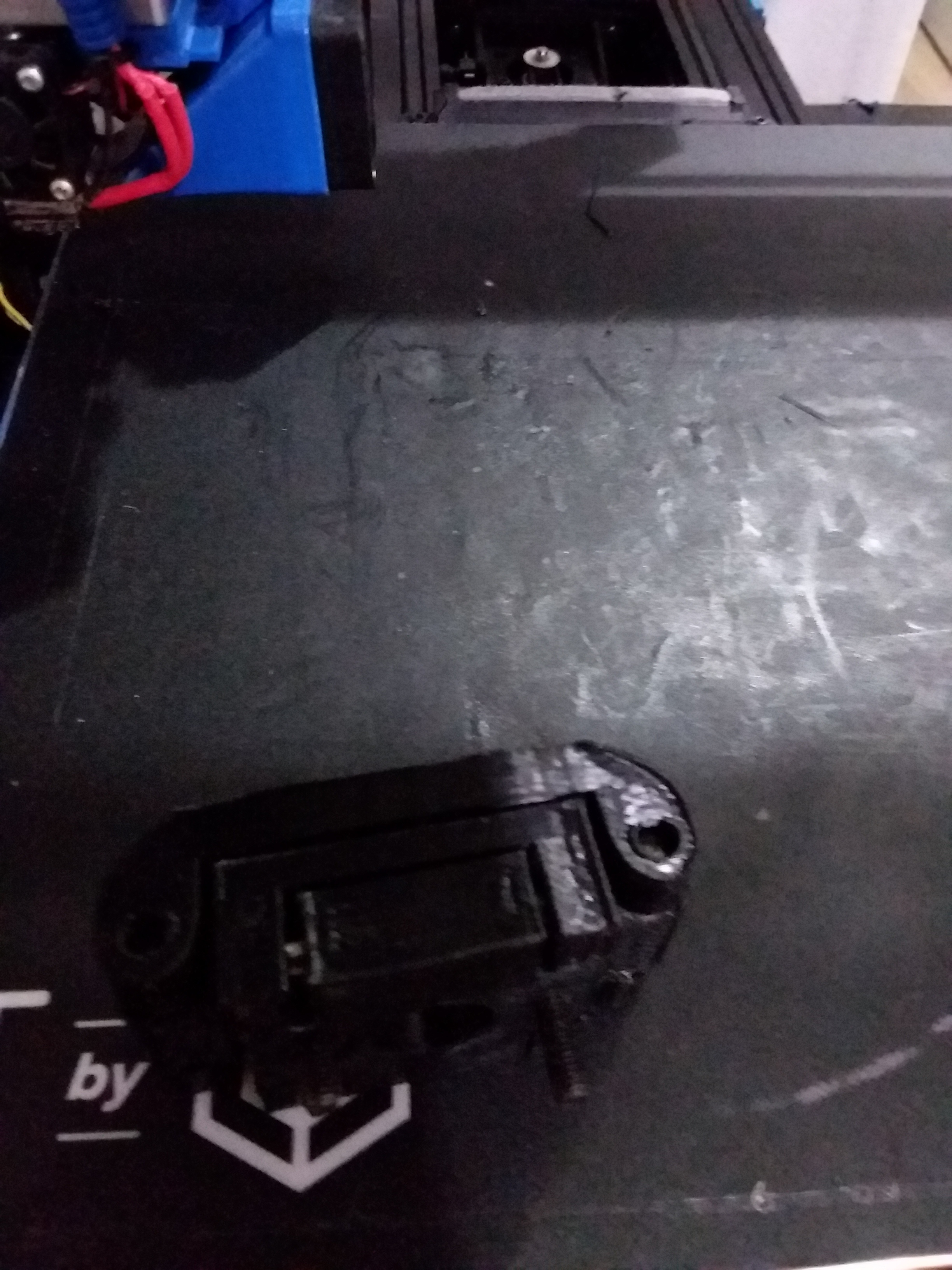

**Post date:** [October 8, 2017, 7:21am UTC](https://forum.lulzbot.com/t/taz-6-anti-wobble-z-nut-mount/5235/3 "2017-10-08T07:21:18Z")
Seems to do the job about as well as my Taz 5 variant. it has a bit more travel built in, I may take about 1mm of that out in the final production variant to make it a little more compact. But it’s smooth, no Z separation movement, no binding, and seems to fit around a leadscrew just fine.
