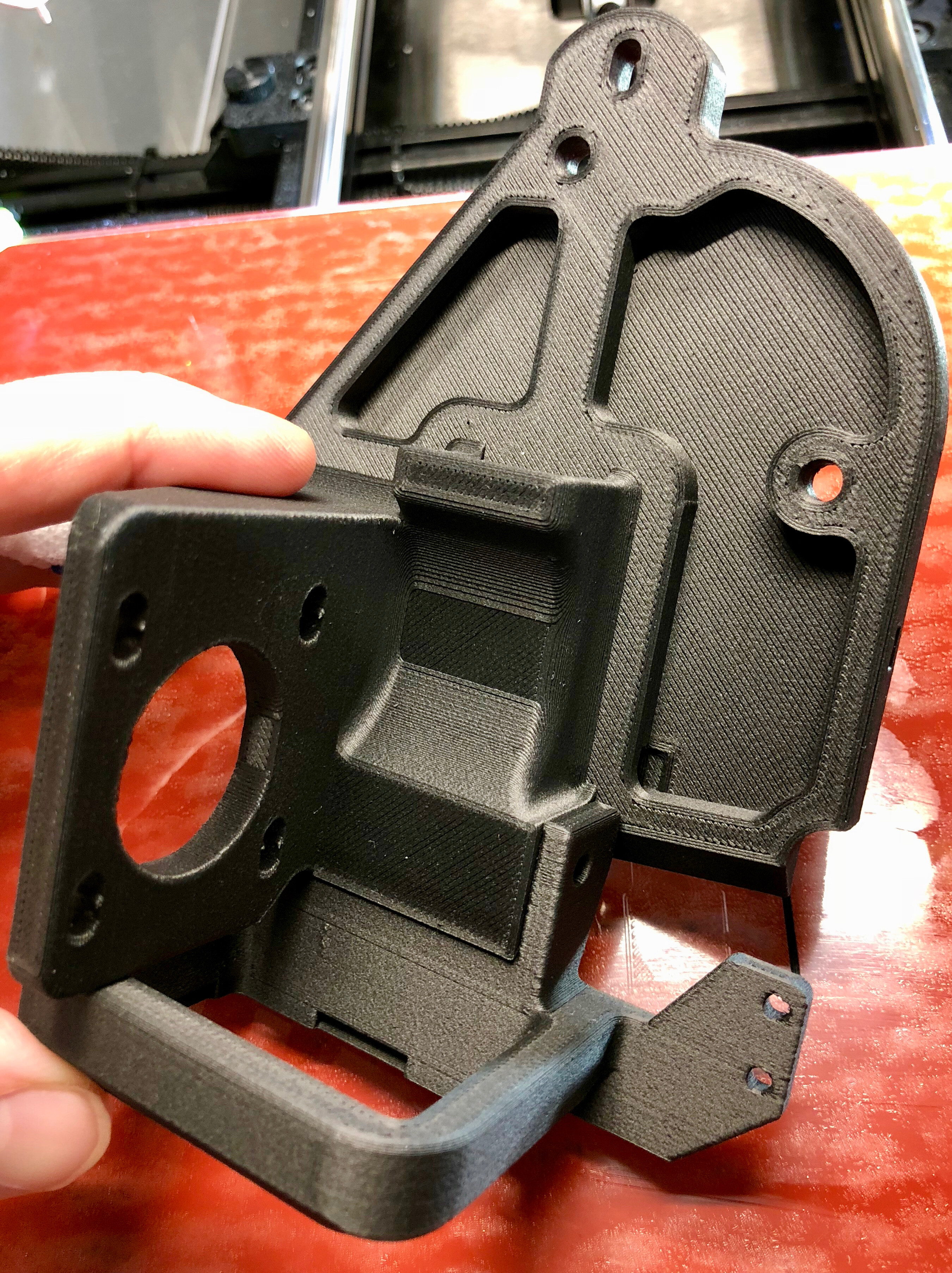

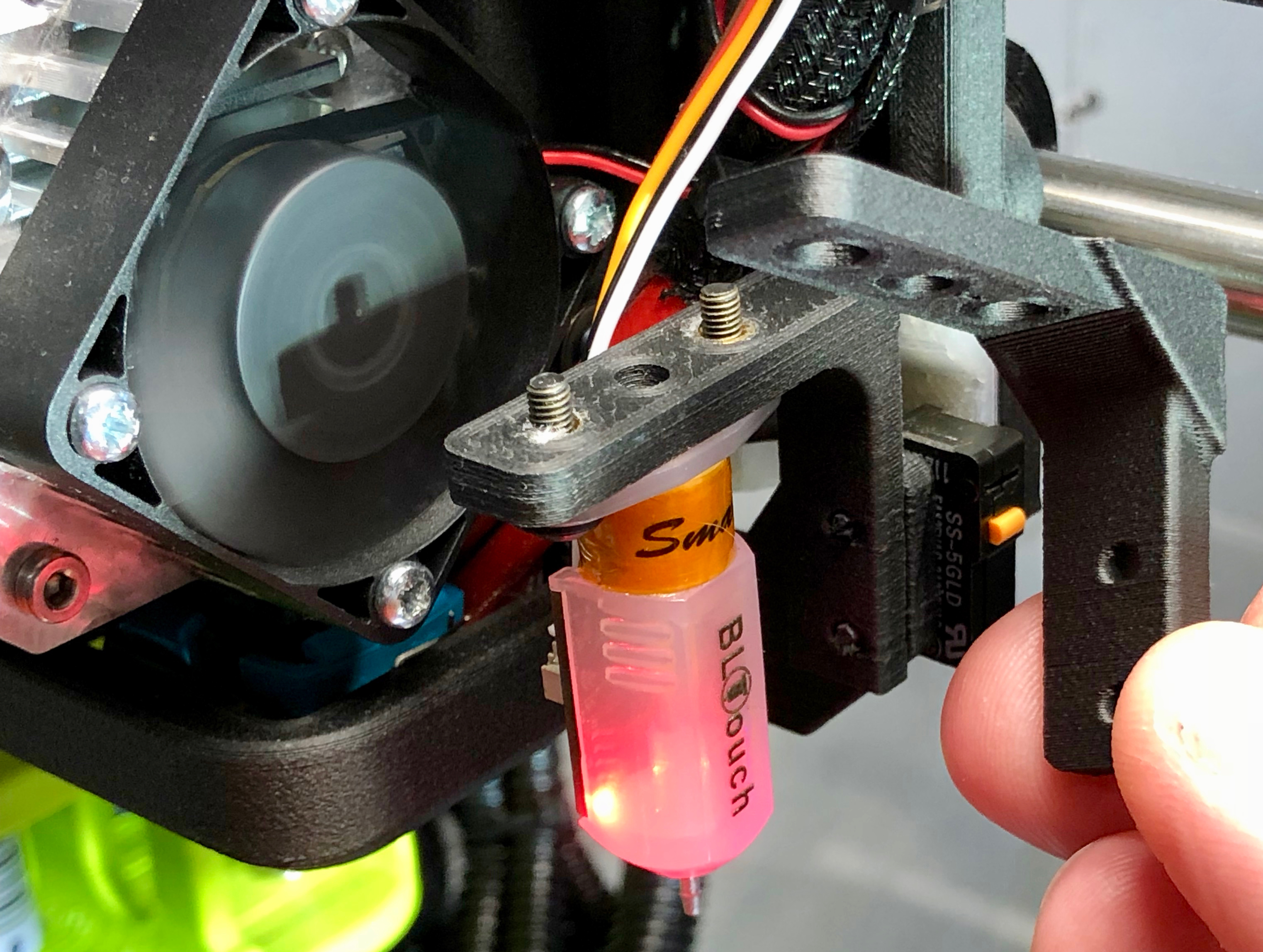

**Author:** ![ocelot27](https://avatars.discourse-cdn.com/v4/letter/o/13edae/32.png) [@ocelot27](https://forum.lulzbot.com/u/ocelot27)\
**Post date:** [March 1, 2018, 2:30pm UTC](https://forum.lulzbot.com/t/taz-6-bltouch-working/5662/6 "2018-03-01T14:30:13Z")
You can download the STL’s for that toolhead design from thingiverse or [itworks3d.com](http://itworks3d.com) - it’s a really, really nice design and not hard to print - the lightest extruder solution I’ve yet found.
I’m still tweaking the BLTouch mount design to make it more stiff for people who may not want to print it in carbon-filled nylon - will upload the stl when it’s perfect.
Mount file:
> **[BLTouch mount for itworks3d.com Taz 6 toolhead by ocelot27](https://www.thingiverse.com/thing:2811436)**
> This is a small and simple mount for the BLTouch for the itworks3d.com Titan Aero extruder for the Taz.
> Mount the BLTouch using M3 inserts and appropriate screws/washers - the z offset will be around -1.0mm - do this before you mount the whole thing....
-john
Here are some pics of a freshly printed toolhead and the final mount in 3DeXtech Carbon-X Nylon - it’s the tits!
 ![IMG_0424.jpg](https://us1.discourse-cdn.com/flex020/uploads/lulzbot/original/2X/7/71a4a676d22d478ef9860bfc4c61853c30002062.jpeg)
 ![IMG_0423.jpg](https://us1.discourse-cdn.com/flex020/uploads/lulzbot/original/2X/5/50585f924e04fe06c3511a090a879995269185d8.jpeg)
