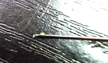

### Author: ![beodd](https://avatars.discourse-cdn.com/v4/letter/b/a698b9/32.png) [@beodd](https://forum.lulzbot.com/u/beodd)
#### Post date: [June 18, 2024, 4:23pm UTC](https://forum.lulzbot.com/t/taz-6-dual-v3-1-will-not-load-filament-on-print-head-1-or-2/26726/8 "2024-06-18T16:23:38Z")
Oh, Something else that seemed to help. I dinged up the needle, like slamming the tip against something hard.
![image](https://us1.discourse-cdn.com/flex020/uploads/lulzbot/original/2X/8/853495d3b65f80d9d5986e45b83a6d99bce0d82e.jpeg)
Then, when I came in from the top, I was able to get in there and spin it around to clean up any other junk on the sides, from the fins down through the hot block. Think of it like a drill.
The needle will not go in from the nozzle with the bend on it.
