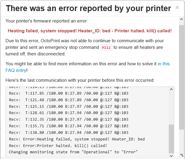

Update, I have verified that I get a temp reading from the heater bed. If I set the bed temp to 60° via the display or software, I get the bed heating failed error. Below is the error from Octoprint. Is there an ohm reading I can get from the bed connectors to verify the bed condition, before chasing possible wire problems?

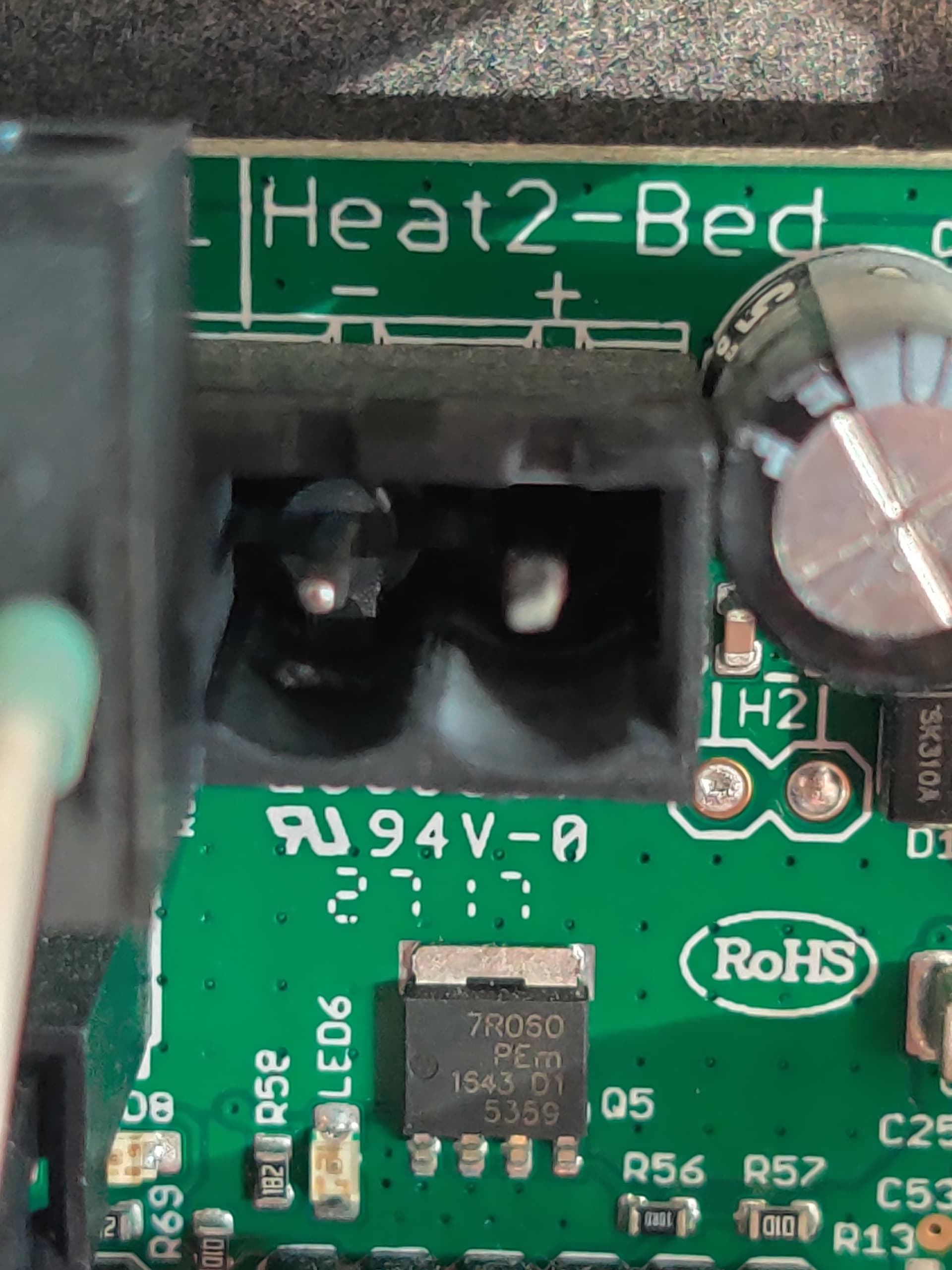

Another update, I started looking at the bed connections to look for obvious problems. I found the cable connector that plugs into the pcb has overheated and melted. Now I have a more questions:
a) Anyone know the manufacturer and part number of the cable connector?
b) Is this common, if so what could have caused this? How to I test to see where the damage is?
c) Can I power up the unit to see if there is any power at the pcb connector pins, if so, what voltage should I get?
Thank you!
 ![IMG_20250712_181119](https://us1.discourse-cdn.com/flex020/uploads/lulzbot/original/2X/7/77739d4fef0425e6c97bd1822f057eb1a3623e34.jpeg)
 ![IMG_20250712_181245](https://us1.discourse-cdn.com/flex020/uploads/lulzbot/original/2X/8/81aa7dd5a32f3d07e0de06d9b033267d3a7b66bc.jpeg)

Just wanted to follow-up. My Taz 6 is back up and running. After all the testing, and not finding anything faulty, I pulled the Rambo out enough to see the backside of the Heated Bed connector. Sure enough, one pin was burned, so I tried this work-around from this thread and it worked.
> [@TAZ 6 Heated Bed Not Heating - Perplexing Puzzle - \[EDIT - SOLVED!! Heater pin melted on RAMBo!\]](https://forum.lulzbot.com/t/taz-6-heated-bed-not-heating-perplexing-puzzle-edit-solved-heater-pin-melted-on-rambo/5178/39):
> Images below. In the first image you can see the board header for the heated bed (the two screw terminals to the left of the large capacitor). The position on the right is the V+ trace that burned out on my board. The large white wire in the foreground is the wire that should be plugged in to this terminal, but is now jumpered to the fuse. You can see that the GND wire returning from the bed heater is still in its original position in the header The white wire in the foregro…
**Post date:** [August 7, 2025, 5:00pm UTC](https://forum.lulzbot.com/t/taz-6-heated-bed-test-procedure/27633/12 "2025-08-07T17:00:37Z")
Sounds like it shouldn’t have passed the first part of the inspection.
 ![image](https://us1.discourse-cdn.com/flex020/uploads/lulzbot/original/2X/2/2db54633f2853ee1b5d60b6815353e8440cd86fe.png)
Considering the age of these boards now, I’d expect to see this more as fatigue sets in, so I would think it a good idea that if anyone has the electrical case opened, to check for signs of this setting in.
