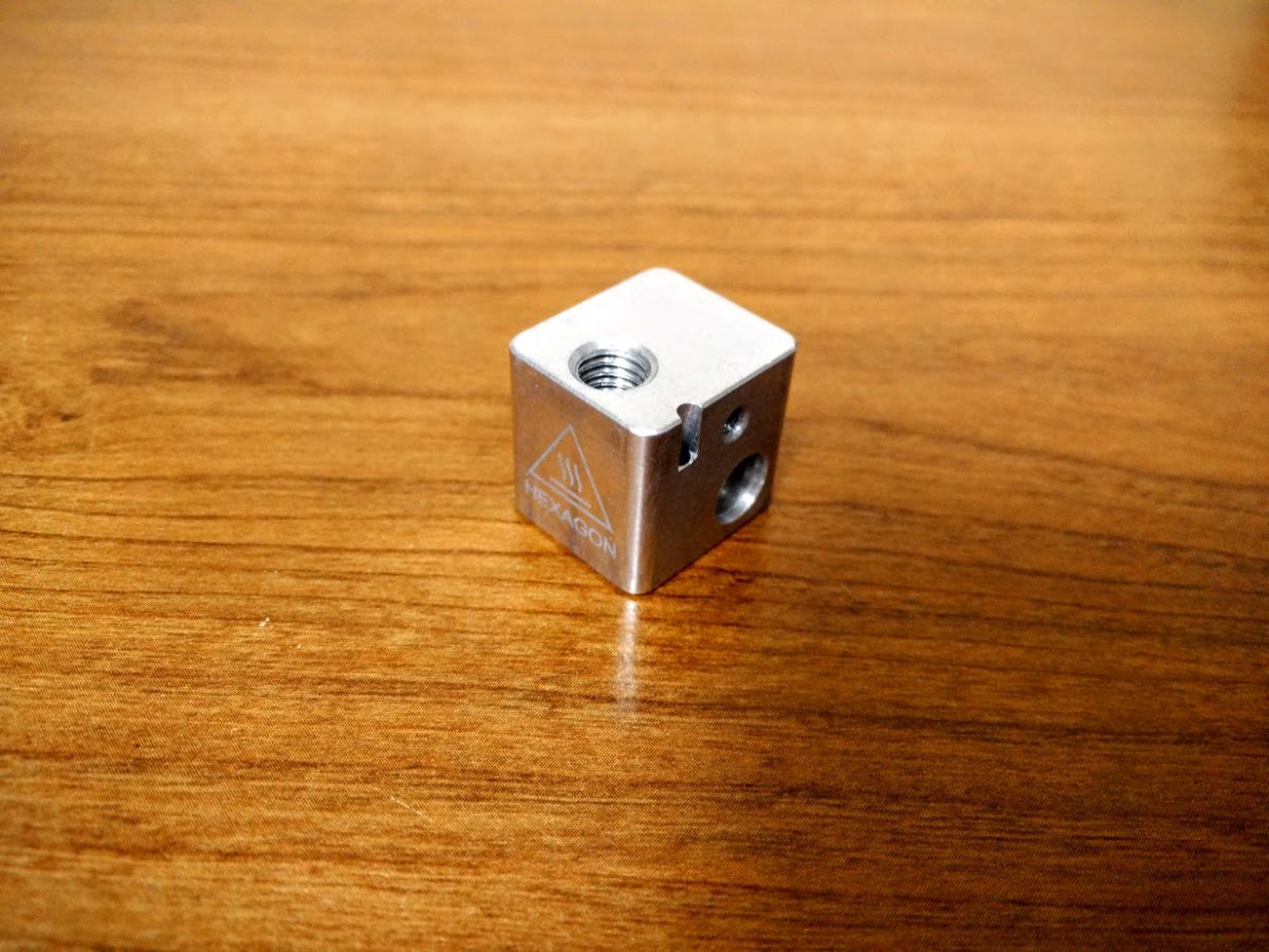

Good afternoon all… I’m having a bugger of a time trying to find a sutable repalcement hotend for a Taz 6. We had a nozzle break off inside and subsequently destroyed the block trying to get it out.
If there is a suitable replacement hotend, or hell, just the block, that can be had today, I love to get it. My searches are coming up short.

Found these on [https://e3d-online.com/](https://e3d-online.com/)
Unless someone knows of an alternative… I may give these a shot.

> **[Hexagon hotend heater block - IT-Works 3D](https://itworks3d.com/product/hexagon-hotend-heater-block/)**

perfect thanks!.. will their heatbreak also work??
i seem to have drilled into mine while trying to he-man it out.
> **[Micro Swiss Plated Wear Resistant Thermal Tube for E3D v6 Hotends - IT-Works 3D](https://itworks3d.com/product/micro-swiss-plated-wear-resistant-thermal-tube-e3d-v6-hotends/)**
> This wear resistant heat break tube is an improvement over the stock E3D heat break. It's made from stainless steel and plated with TwinClad XT coating.
> Available in 3mm and 1.75mm

Perhaps you can confirm which tool head you have, and what nozzle size? Specifically, is it the MoarStruder, or the original hexagon hot-end based toolhead? Or perhaps is it the Aerostruder?

Completely stock
Tool Head: TAZ Single Extruder Tool Head v2.1, 0.50mm nozzle

Sooo… Ended up breaking the heatbreak off in the heatsink so now I need an entire assembly.
Would this work? Or is there a better alternative?
> **[Amazon.com: RepRapDiscount Hexagon AO Hotend 3mm Kit with 24v Heater Cartridge:...](https://www.amazon.com/dp/B00W4AIFBK/ref=cm_sw_r_sms_apa_i_U8MvEbF40RC3Q)**

Probably beyond what you’re looking to spend, but I just bought a V2.1 that had been converted E3D V6 by [waterproofpaper](https://www.ebay.com/usr/waterproofpaper?_trksid=p2047675.l2559), I’m liking it a lot better.
