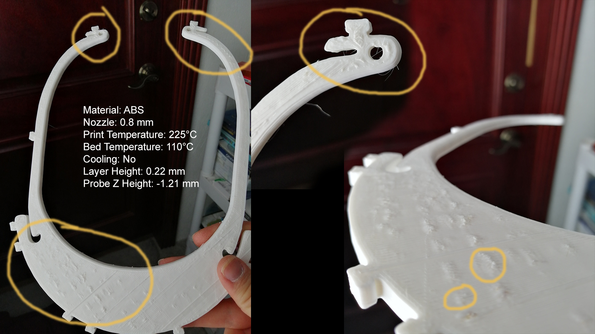

I printed a model with the following settings:
Material: ABS
Nozzle: 0.8 mm
Print Temperature: 225°C
Bed Temperature: 110°C
Cooling: No
Layer Height: 0.22 mm
Probe Z Height: -1.21 mm
This model had some lumps and as the nozzle moved over those lumps, all the hotend moved up and down making a lot of noise. See this pic:

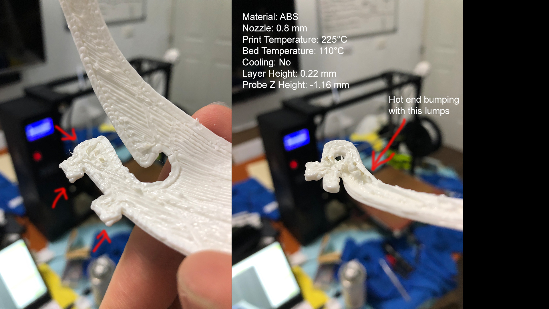

**Author:** ![mzendejas](https://avatars.discourse-cdn.com/v4/letter/m/dc4da7/32.png) [@mzendejas](https://forum.lulzbot.com/u/mzendejas)\
**Post date:** [May 25, 2020, 1:57am UTC](https://forum.lulzbot.com/t/taz-6-lumps-and-or-model-not-sticking-to-bed/21745/2 "2020-05-25T01:57:33Z")
This is the pic of the lumps of the -1.16 mm Z Height:
 ![1.16](https://us1.discourse-cdn.com/flex020/uploads/lulzbot/original/2X/2/2a7bb53f36b01f2bee34995f3b1a41a286e1f9fd.jpeg)
Also when the Z Axis goes down it makes some noise, check [this video](https://www.youtube.com/watch?v=cYYW-9gn8Ck).
Thanks in advance,
Manuel
**Post date:** [May 25, 2020, 2:36am UTC](https://forum.lulzbot.com/t/taz-6-lumps-and-or-model-not-sticking-to-bed/21745/3 "2020-05-25T02:36:12Z")
225 sounds low for ABS. Check the recommended temps on the side of the spool. 240-260 is a typical range for ABS.
Just making sure I follow… You’re printing 1.75mm filament through the 1.75mm hotend. Check that you changed the filament size in the slicer to 1.75 from 2.85. If that checks out, reduce the flow rate (multiplier)… try 95% or 93%.

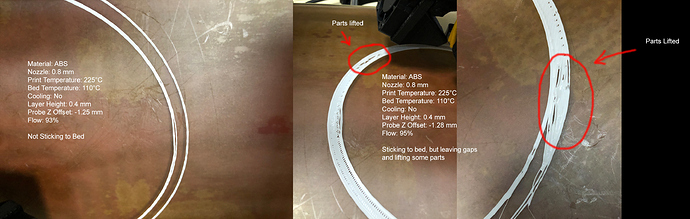

**Post date:** [May 26, 2020, 12:29am UTC](https://forum.lulzbot.com/t/taz-6-lumps-and-or-model-not-sticking-to-bed/21745/5 "2020-05-26T00:29:44Z")
So I changed from -1.21 to -1.25 the Probe Z Offset and it made a better print, but now I changed the model to print and started to making a lot of lumps, so I tested with 93% flow (did not stick to bed) and then I changed the Probe Z Offset to -1.28 and 95% flow (it stick to bed, but has some gaps and the nozzle is lifting already printed material), see this pic of both scenarios:
 ![1.28](https://us1.discourse-cdn.com/flex020/uploads/lulzbot/original/2X/4/4e7ef2d4ab028e5afce5f6143f7805b5479203fc.jpeg)
**Post date:** [May 26, 2020, 12:36pm UTC](https://forum.lulzbot.com/t/taz-6-lumps-and-or-model-not-sticking-to-bed/21745/6 "2020-05-26T12:36:56Z")
Also level your x axis to the machine frame.

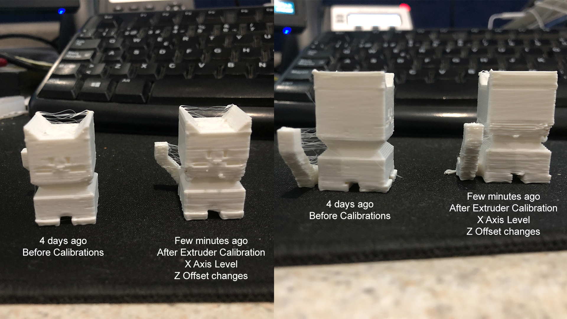

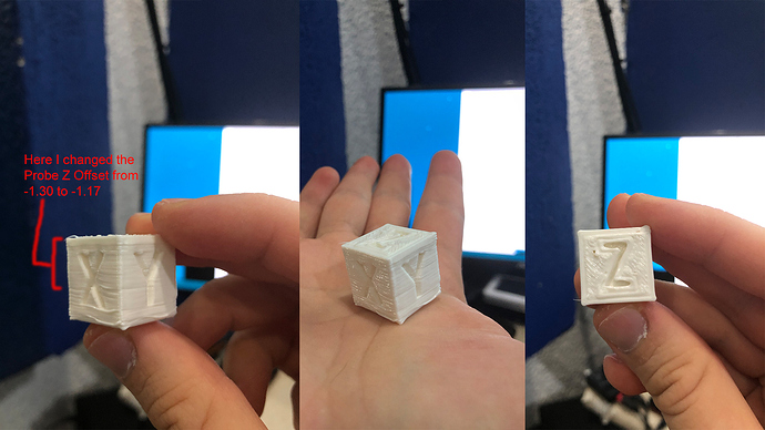

**Post date:** [May 28, 2020, 3:41am UTC](https://forum.lulzbot.com/t/taz-6-lumps-and-or-model-not-sticking-to-bed/21745/9 "2020-05-28T03:41:36Z")
Ok, I leveled the X Axis and the weird sound that the printer made when the Z Axis was probing is gone. Also I calibrated the steps for the extruder.
But I still have some printing issues, I have to change the Z offset with each model, the boat I could not print it, the problems happens with the overhangs, it starts to print outside the printable area and down.
Look at the first few layers of the boat:
 ![boat](https://us1.discourse-cdn.com/flex020/uploads/lulzbot/original/2X/8/8c7d1fef022e6ed66db427ee10cfa1e768785293.jpeg)
The cube I had to change the Z Offset in the middle of the print from -1.30 to -1.17:
 ![cube](https://us1.discourse-cdn.com/flex020/uploads/lulzbot/original/2X/0/00a71344224163baf10ce9df7bf022d7e6fcba51.jpeg)
And a few days ago I printed a cat when the bed adhesion issue started to appear, it was ok and now after the Z offset change, X Axis level and extruder calibrated is even worse…
 ![cat](https://us1.discourse-cdn.com/flex020/uploads/lulzbot/original/2X/5/54b6633c3f8e6feda6e4d71470f82882d77a2438.jpeg)
With the extruder calibration the infill is pretty good, but now I have issues in the angles like with the cat (neck) and the boat.
Also the filament goes up to a side of the nozzle instead of straight down.
