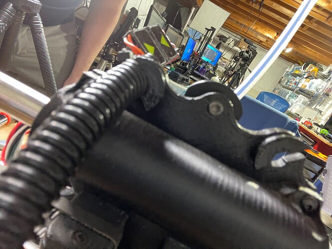

Hi
As mentioned previously, I acquired this used Taz 6 with several issues.
Many resolved!
But one big one.
Previous student users inserted the mounting screw from behind instead of the front. They also over torqued the heck out of it. I have tried using various means of heating to get the brass insert heated up to reattach to the X carriage. The minute I try to loosen that screw out, we’re back to the brass insert spinning in place.
One option is to upgrade the x carriage to something newer, like the linear rail from IT-Works.
But I am curious if anyone else has encountered this issue and ideas how to resolve?
The screw portion that sticks out the front is barely 1mm, so securing the print heads in place is a real struggle with so few threads showing.
Thanks

### Author: ![WhereNerdyIsCool](https://sea2.discourse-cdn.com/flex020/user_avatar/forum.lulzbot.com/wherenerdyiscool/32/11794_2.png) [@WhereNerdyIsCool](https://forum.lulzbot.com/u/WhereNerdyIsCool)
#### Post date: [June 18, 2022, 1:11am UTC](https://forum.lulzbot.com/t/taz-6-print-head-screw-mount-replacement/24615/4 "2022-06-18T01:11:01Z")
Well there isn’t much to show, just that instead of the screw going in the front, they put it in the back…over torqued it so anytime you try to unscrew it, the brass insert spins
 ![IMG_5991](https://us1.discourse-cdn.com/flex020/uploads/lulzbot/original/2X/6/630b318ff7e776bf28ed59fa3a39d39a90cb3624.jpeg)
 ![IMG_5992](https://us1.discourse-cdn.com/flex020/uploads/lulzbot/original/2X/0/0d53781193fd9bfc3dcd70e5fa60950a6a875501.jpeg)
### Author: ![b-morgan](https://sea2.discourse-cdn.com/flex020/user_avatar/forum.lulzbot.com/b-morgan/32/11517_2.png) [@b-morgan](https://forum.lulzbot.com/u/b-morgan)
#### Post date: [June 18, 2022, 1:33pm UTC](https://forum.lulzbot.com/t/taz-6-print-head-screw-mount-replacement/24615/5 "2022-06-18T13:33:23Z")
Thanks for the pictures. I just wanted to make sure we were talking about the same thing. The tool head’s position is primarily determined by the wedge at the bottom. The screw at the top just keeps the tool head flat against the x carriage.
Can you use a longer M3 screw and a nut on the back?
You could try to epoxy the brass insert into position. Maybe insert a M3 hex nut instead.
The X carriage might be thick enough to drill and insert a small set screw or two.
How many tool heads do you have? Replacing the M3 brass insert with an M4 brass insert (and an M4 screw) may require enlarging the slot in the tool heads.
Another option is to print a new part and insert 15 new inserts ([see here](https://ohai.lulzbot.com/project/taz6-printed-part-identification-and-preparation-a/taz-6/#&gid=1&pid=2) and [here](https://download.lulzbot.com/TAZ/6.03/production_parts/printed_parts/x_carriage/)).
#### Post date: [June 18, 2022, 8:42pm UTC](https://forum.lulzbot.com/t/taz-6-print-head-screw-mount-replacement/24615/6 "2022-06-18T20:42:02Z")
I think you are missing the point of my initial post
The screw can not be removed. It was over-torqued into the brass insert. Efforts to heat up the insert and try to remove the screw have failed.
Re-printing and new inserts is an option. Or ordering a replacement carriage.
I wasn’t sure if others had been in a similar situation and how they resolved it

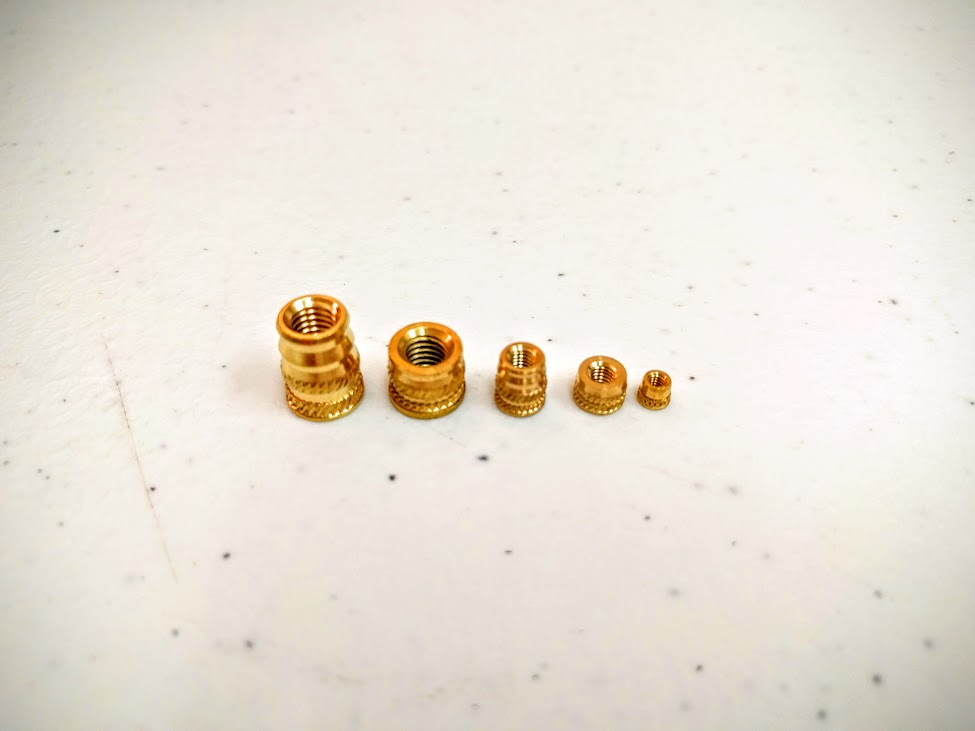

### Author: ![Iggy](https://sea2.discourse-cdn.com/flex020/user_avatar/forum.lulzbot.com/iggy/32/10012_2.png) [@Iggy](https://forum.lulzbot.com/u/Iggy)
#### Post date: [June 20, 2022, 3:14am UTC](https://forum.lulzbot.com/t/taz-6-print-head-screw-mount-replacement/24615/10 "2022-06-20T03:14:19Z")
ABS for sure, here are the inserts. M3
> **[Metric Brass Heat-Set Insert for Plastics - IT-Works 3D](https://itworks3d.com/product/metric-brass-heat-set-insert-plastics/)**
> Metric Brass Heat-Set Insert for Plastics from McMaster-Carr Only need a few? We sell singles!
