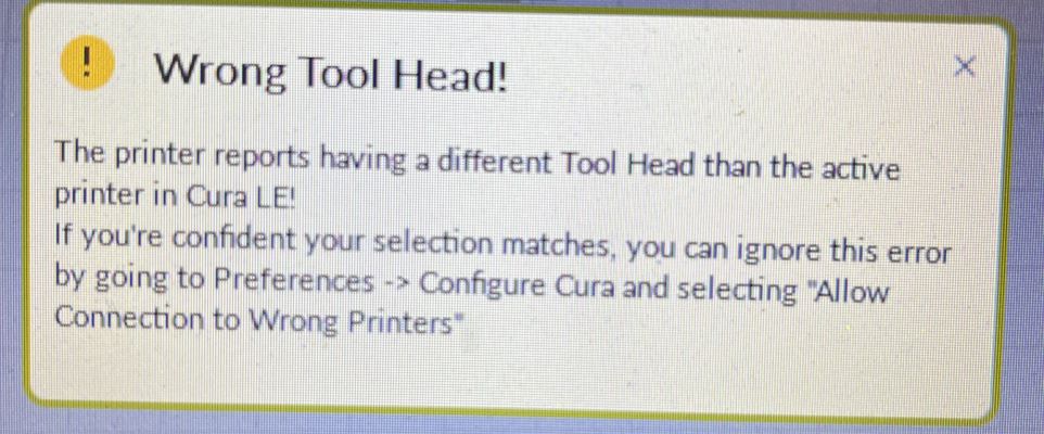

I installed the most recent version of Cura LE and updated the firmware, but I’m still getting the same results. It typically stops printing in after probably 10 layers or so.
With the new Cura, it also tells me the tool head that’s on the machine is not the tool head I’m using. I don’t know how to find out what tool head Cura thinks I’m using.

Can you screenshot the error you’re getting? the toolhead doesn’t talk to the printer - it’s all one-way communication, and the selection of your toolhead from the toolhead menu only changes a few settings, none of which identify the toolhead in use. So if there’s an error from CuraLE, it’s based on the actual firmware loaded. and what toolhead is on the machine vs. what you selected from the “add a printer” dialog?
What firmware version does your printer report on the About screen?

Here is a photograph of the screen.
 ![Screen Shot](https://us1.discourse-cdn.com/flex020/uploads/lulzbot/original/2X/a/af333115d0f573254caa0c23fcf74a42eae83a3f.jpeg)
I’m using a SE 0.5 mm Nickel Plated Copper. (P/N: KT-CP0136). The Firmware is 2.0.9.0.13 and the Cura is version 4.13.8.

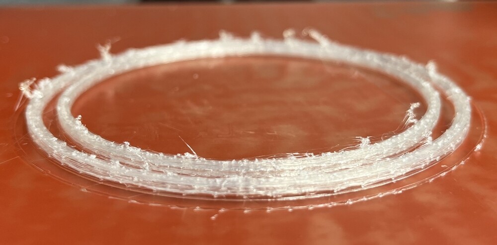

Here is what a failed print looks like if it’s any help:

**Post date:** [May 8, 2024, 2:39pm UTC](https://forum.lulzbot.com/t/taz-6-stops-extruding-on-retraction/26580/11 "2024-05-08T14:39:29Z")
Not sure why you’re getting that error, maybe you selected the standard extruder (which also has a .5mm nozzle) when you set up the printer?
But as for the other picture - that Z offset looks extremely low. I can see where it’s scraping the bed instead of extruding the skirt. This is going to cause jams and stripped filament.
Going of that picture, you have a Z offset of about -1.5, and it’s typically around -1.25 to -1.3. If your Z offset is actually around -1.25 to -1.3, then your nozzle is not completely clean, so it’s giving a false reading of the bed lower than it really is.

Wrathernaut, You are correct that the Z-offset certainly doesn’t look right in the photo. It was definitely set to -1.2 I tested it up to -0.8 and it look better on the first layer print, but I still get the same problem. I don’t know if that is a result of the instrument and the software disagreeing on what toolhead I am using. I created a new printer in Cura and made sure it was the nickel plated copper nozzle.

If that’s -1.2mm offset, your nozzle is dirty. I can almost feel your bed being pushed down by the nozzle during measurements from here.
