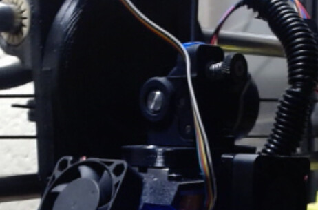

But if you have issues with 2.85mm filament on the Wade extruder, I can personally attest to the massive improvement swapping the Wade extruder up top for a 2.85mm Orbiter extruder. One little adapter
[Flexorbiter Adapter v1.stl](https://forum.lulzbot.com/uploads/short-url/4ZxJS9TEFDg6z2xYA3HOu5V8O0J.stl) (4.3 MB)
and about $60 for the extruder, some wire splicing… and you’re good to go:
 ![image](https://us1.discourse-cdn.com/flex020/uploads/lulzbot/original/2X/f/fb286b81fe37889f2ff95192f472b5d0d48505dd.jpeg)
A nice benefit to the Taz 6 is that the toolheads are easily swapped. If you’re running the latest universal firmware build, it’s about a 2-minute procedure with no firmware changes required.
1.75mm is better for just about every filament, the exception being flexible filaments. 2.85 is still great to have since you have a big supply, and also clearance 2.85mm filament can get you some great stuff at significant discounts.

Thanks for posting this print and idea. The orbiter has a sensor wire for bltouch? Your taz does a auto leveling process with this?
### Author: ![Wrathernaut](https://sea2.discourse-cdn.com/flex020/user_avatar/forum.lulzbot.com/wrathernaut/32/13542_2.png) [@Wrathernaut](https://forum.lulzbot.com/u/Wrathernaut)
#### Post date: [July 4, 2025, 6:40pm UTC](https://forum.lulzbot.com/t/taz-6-switch-to-1-75/26204/11 "2025-07-04T18:40:11Z")
The orbiter doesn’t have a thing to do with bltouch, that’s all on how you build your tool head. My 2.85mm tool head of choice on my taz6 has a bltouch mount, orbiter extruder, 5015 blower for part cooling and an original hexagon hot end. For 1.75, I run a biqu h2.
### Author: ![Mushe](https://avatars.discourse-cdn.com/v4/letter/m/b3f665/32.png) [@Mushe](https://forum.lulzbot.com/u/Mushe)
#### Post date: [July 4, 2025, 7:50pm UTC](https://forum.lulzbot.com/t/taz-6-switch-to-1-75/26204/12 "2025-07-04T19:50:32Z")
Thanks for the parts breakdown I couldn’t see everything from the photo. I will also research the biqu h2. I bought an ed3 v6 hot end with tube, but haven’t found the right mod out there to use it so I might return it. What cura printer profile do you end up running the flexstruder?
