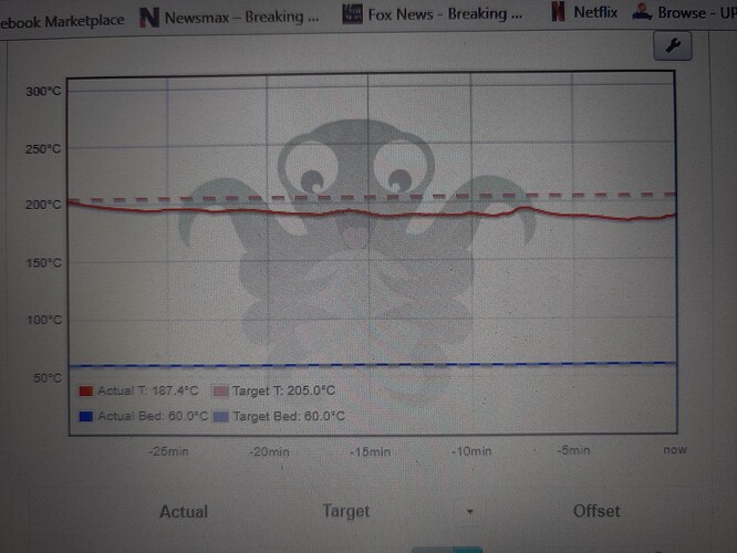

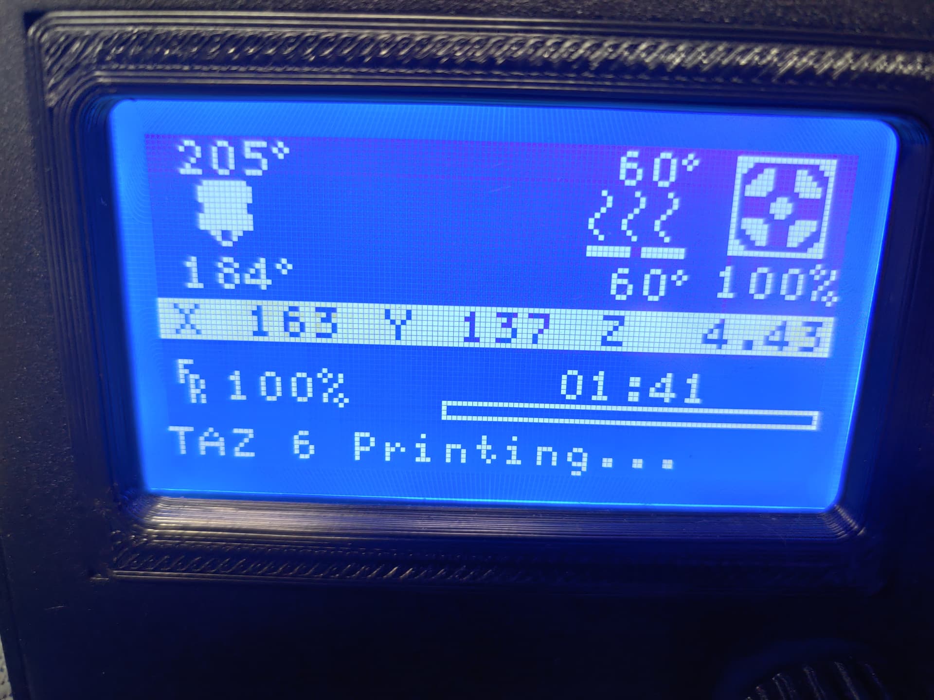

Thank you Wrathernaut for the instructions, I greatly appreciate it. I ran the PID autotune as instructed and it went flawless.
I haven’t tried to print ABS yet, but started with re-printing a PLA part. The part printed without an error and completed. But I noticed around 1 hour into a 2 hour print that the tool head temp dropped off from the target temp. The target temp was 205°, but the tool head temp fluxuated between 183-187°. The print completed and looks fine.
What would cause the tool head to drop off from the target temp?
 ![IMG_20251002_224601](https://us1.discourse-cdn.com/flex020/uploads/lulzbot/original/2X/b/b602d600aebdc5fcdd1a65b0f5838ebf5cc043bf.jpeg)
 ![IMG_20251002_224750](https://us1.discourse-cdn.com/flex020/uploads/lulzbot/original/2X/3/3edbee09db32c3116773dcc8dce3b2623582e28f.jpeg)
**Post date:** [October 3, 2025, 9:02pm UTC](https://forum.lulzbot.com/t/taz-6-thermal-runaway-with-abs/27734/7 "2025-10-03T21:02:18Z")

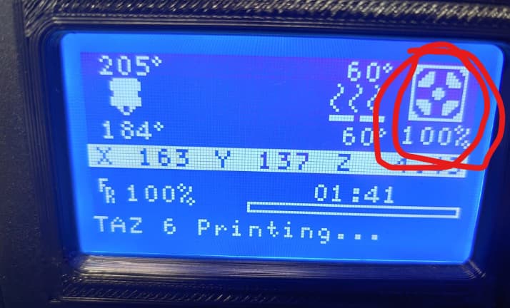

Part cooling fan at 100% is overpowering the nozzle heater. It’s not uncommon with the Aerostruder.
 ![image](https://us1.discourse-cdn.com/flex020/uploads/lulzbot/original/2X/d/d01e0207bd5ea9e65bf9e53635facc77bfcbc2a1.jpeg)
I think I set my fans to max at 80% with the aerostruder head, before I build up a different toolhead based on the ITworks-3d design that had better part cooling ducts.

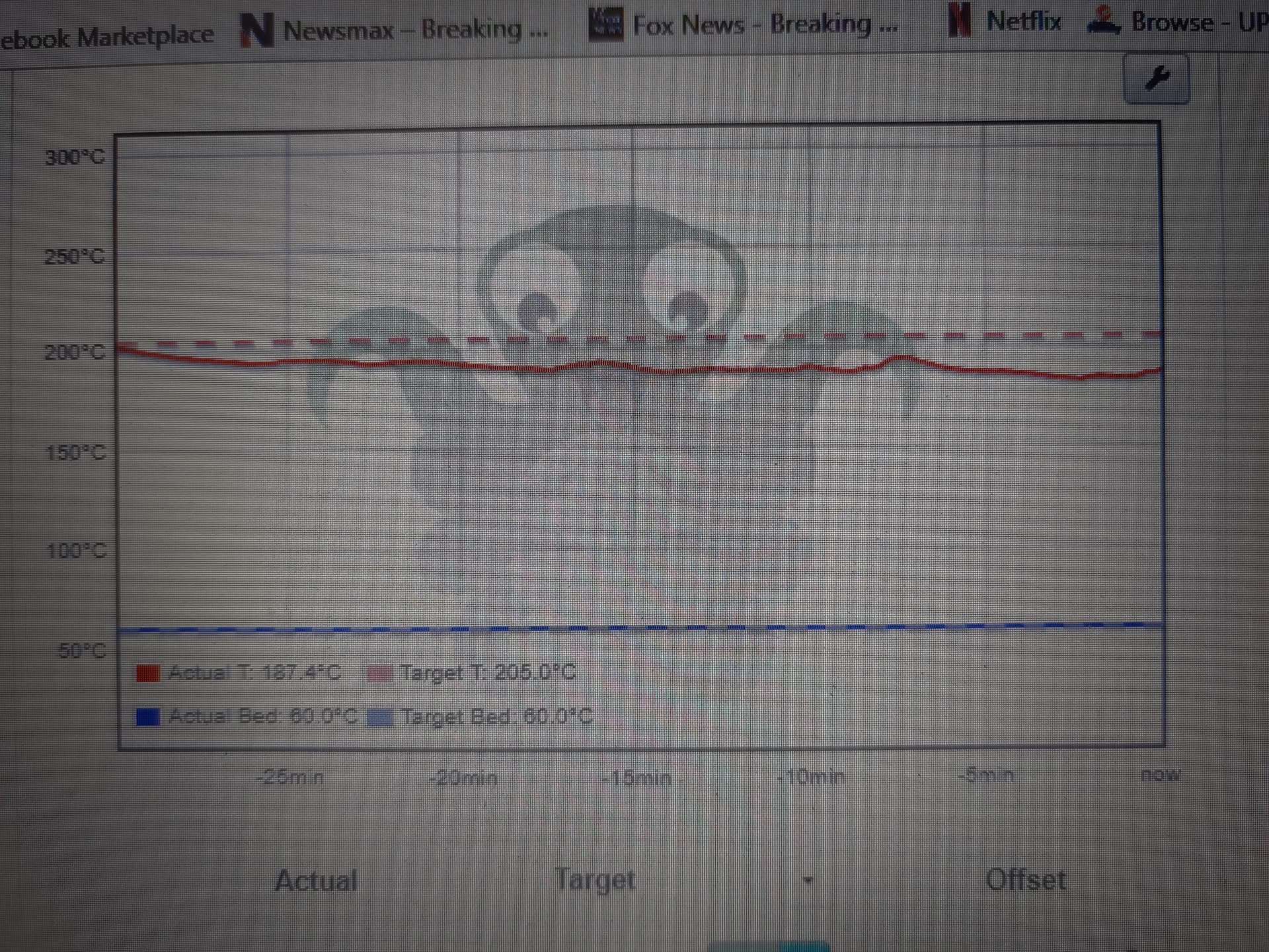

**Post date:** [October 7, 2025, 8:15pm UTC](https://forum.lulzbot.com/t/taz-6-thermal-runaway-with-abs/27734/11 "2025-10-07T20:15:59Z")
I tried to print ABS again yesterday, then after an hour or so, it shut down due to thermal run away event. Today, I’m printing the same part, but re-sliced it for PLA. I set the fan speed to 70-80% and it’s printing without a failure. Any time I checked on the print, the temps looked really good, but then I noticed dips in the print head temp and also noticed the fan is again running at 100%. What is overriding my 70-80% fan speed setting?
 ![image](https://us1.discourse-cdn.com/flex020/uploads/lulzbot/original/2X/6/6513cc33228d5a4cdfa527eaefecf51c0379e59c.png)
 ![image](https://us1.discourse-cdn.com/flex020/uploads/lulzbot/original/2X/d/d0817f4516090bfe06f05ce4827cc1a85620aea4.png)
I’m assuming this is related to my ABS shut downs??
**Post date:** [October 7, 2025, 9:03pm UTC](https://forum.lulzbot.com/t/taz-6-thermal-runaway-with-abs/27734/12 "2025-10-07T21:03:40Z")
Bridging and overhangs can have max fan speed overrides, so that’s worth checking.

I know it’s been a while, but I tried to print a ABS part (twice), but again after about an hour I get a thermal runaway and the fan is at a 100%. I’ve unchecked the “Enable Print Cooling” on this part, so why does the fan go to 100%. I don’t sit and watch the print, so I don’t know exactly what’s happening. But the one time I was watching it, the fan kicks on and the print head can’t keep up, so the print temp slowly drops off before the print cancels.
Why does the fan turn on when told not too?
Can I disconnect the wires to the fan as a test or when I need to print ABS?

It would be a bizarre hardware / firmware failure if the fan were to go to 100% without a gcode command.
Using a text editor, search the gcode file for [M106](https://marlinfw.org/docs/gcode/M106.html) commands. You should find an `M106 S100` command which is the culprit.
> [@SoCalRedneck](#):
Instead of messing with the fan wires, use the text editor and change all occurances of `M106 S100` to `M106 S0`.
IMO, a better option would be to find the setting in CuraLE that is causing it to output the `M106 S100` and change it. You can then create a new profile in CuraLE for printing ABS.
Under the `Settings` menu, select `Configure setting visability...` and at the top of that window, click `Check all`. Now in `Filter`, type `fan`. These are all the settings that could be causing the issue. You can go back to the Profile on the main window and change any settings that set the fan speed to 100%.
If you would like our help, please zip and upload the stl and gcode files. Tell us which version of CuraLE you are using and what firmware is loaded in the printer.
