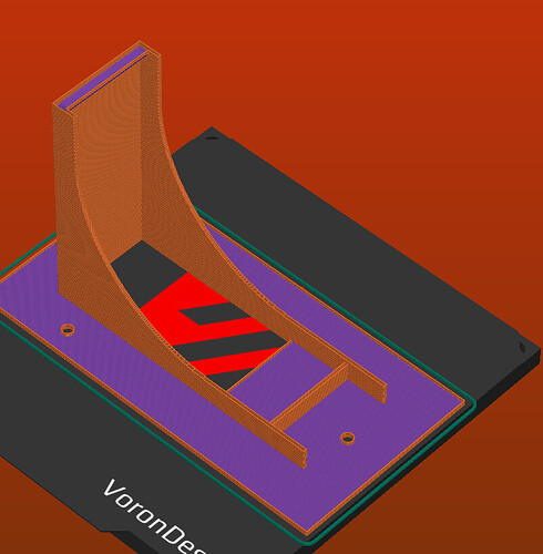

**Post date:** [April 12, 2023, 3:53am UTC](https://forum.lulzbot.com/t/taz-6-w-cura-printing-like-a-photo-negative/25521/13 "2023-04-12T03:53:09Z")
So I remade it completely from scratch and it’s like a cursed shape that refuses to slice correctly in Cura, but slices perfect in PrusaSlicer.
 ![image](https://us1.discourse-cdn.com/flex020/uploads/lulzbot/original/2X/b/bcd8849cf81aeeff02d5f6b02e30d43ae35d1a25.jpeg)

**Post date:** [April 12, 2023, 3:03pm UTC](https://forum.lulzbot.com/t/taz-6-w-cura-printing-like-a-photo-negative/25521/18 "2023-04-12T15:03:45Z")
Not knowing your workflow for producing it, I can’t say what caused them, but the flaws were open sides and some flipped faces. Since SketchUp colors the inside and outside faces so closely together, it can be nearly impossible to tell the inside and outsides apart. With a solid modeling program, any face you can see is the outside. The only way to see “inside” is to use a section view, where the interior shows up filled.
 ![image](https://us1.discourse-cdn.com/flex020/uploads/lulzbot/original/2X/e/e25fb7703669cf3be1b604033ea29e75c1e22490.jpeg)
Your 1-4-2 version slices fine for me:
 ![image](https://us1.discourse-cdn.com/flex020/uploads/lulzbot/original/2X/f/f1eb31bbeec6860cecfc68ee5bd5b36d98aefc58.jpeg)
The only tricky part will be printing the overhang up near the top.
 ![image](https://us1.discourse-cdn.com/flex020/uploads/lulzbot/original/2X/d/d986b378eacec367d5a9178d8ac8bf347f0306e7.jpeg)
