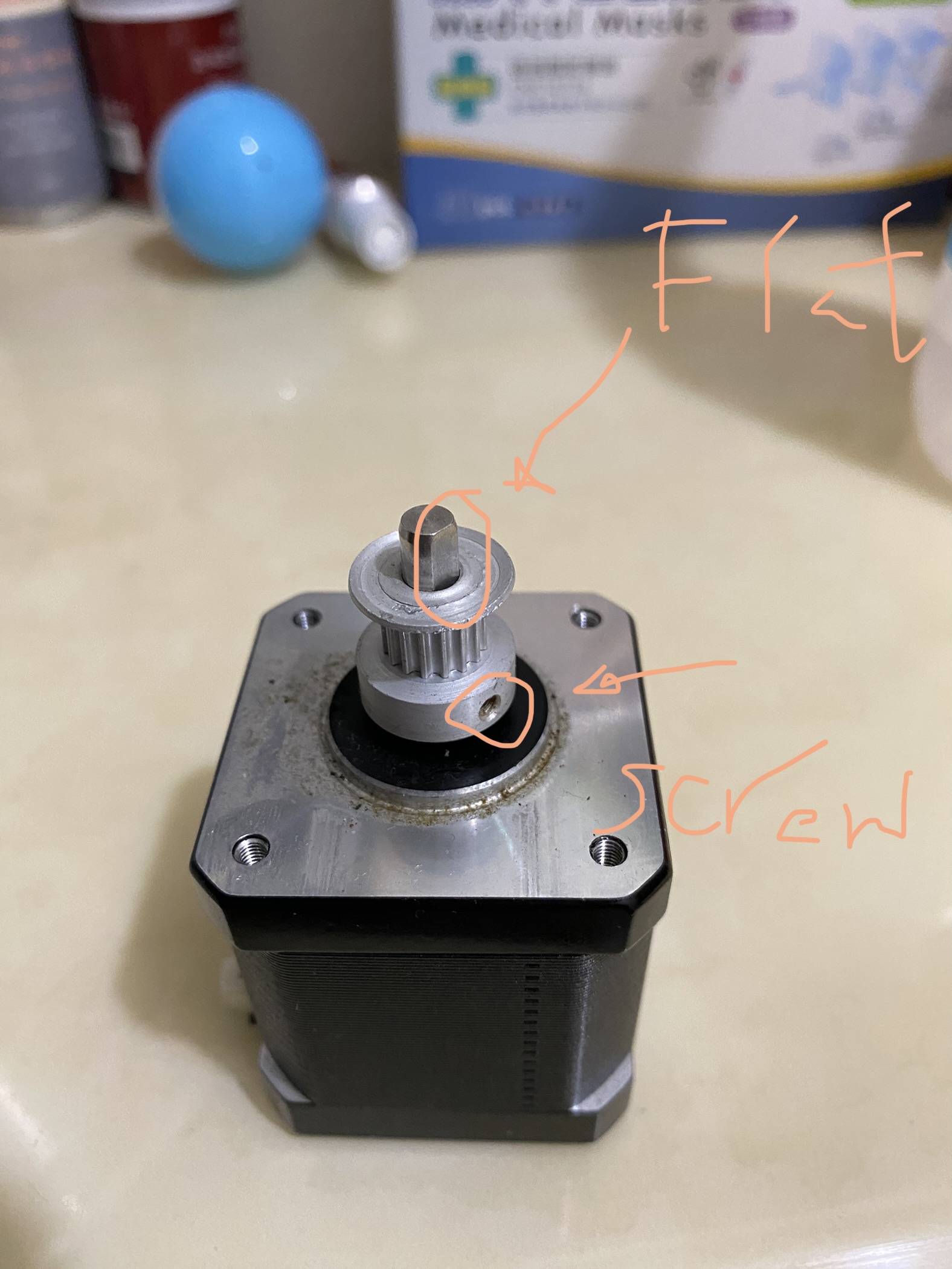

**Post date:** [March 7, 2023, 1:57am UTC](https://forum.lulzbot.com/t/taz-6-x-axis-problem/24852/4 "2023-03-07T01:57:16Z")
Video would help a lot, but it still sounds like it could be a failing stepper driver, or the grub screw holding the gear to the motor’s shaft was tightened down on the round part instead of the flat spot, so it slips once there’s a decent amount of torque on it.
**Author:** ![Chen](https://avatars.discourse-cdn.com/v4/letter/c/3d9bf3/32.png) [@Chen](https://forum.lulzbot.com/u/Chen)\
**Post date:** [March 8, 2023, 12:15pm UTC](https://forum.lulzbot.com/t/taz-6-x-axis-problem/24852/5 "2023-03-08T12:15:29Z")
Do you mean screw on the motor ?
 ![image](https://us1.discourse-cdn.com/flex020/uploads/lulzbot/original/2X/7/7afd9e901fea5d8b1f584faefcd19142df1fc3c2.jpeg)
I upload a video about the problem, please see on the follow link
[![](https://us1.discourse-cdn.com/flex020/uploads/lulzbot/original/2X/1/1274d1acf09b45cb4938af85c95e874feafdc342.jpeg "Y-axis problem") ](https://www.youtube.com/watch?v=GRy_09EmSA8)
Thank you very much
