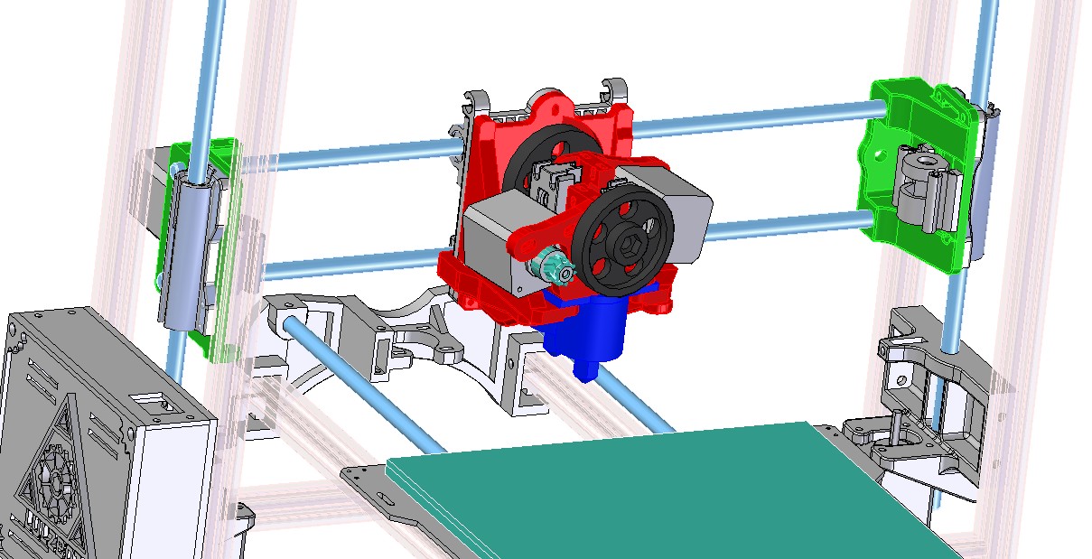

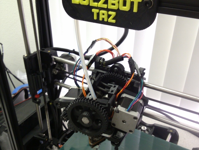

original design discusion from here: [Dual Extruders and the TAZ](https://forum.lulzbot.com/t/dual-extruders-and-the-taz/91/1) I will try to use this thread specifically for the files and instructions.
I just put up the files on thingiverse.
> **[Lulzbot TAZ Dual Extruder mod by 1013](https://www.thingiverse.com/thing:106147)**
> My design of a dual extruder mod for the Lulzbot TAZ. This puts the budaschnozzles as close as possible (40mm center to center). and nearly all of the build platform is accessible to both extruders, once you alter the firmware for extra y travel. ...
and I will see if I can attach them here too. 3 total files, the mount, the adjustment block, and modified wades extruder housing (2 of these needed).
DOH…STL’s are not allowed for upload…trying zips.
UPDATE 6-25-2013: Added Supported motor moved extruder files for easier printing.
[Supported motor moved extruder 1013.zip](https://forum.lulzbot.com/uploads/short-url/dvODvXi9d1d09N3gm6iaqV1wA3Y.zip) (355 KB)
[TAZ dual extrude STPs 1013.zip](https://forum.lulzbot.com/uploads/short-url/6rilMmLdV2edSh04oZLv2QTnWkd.zip) (262 KB)
[TAZ dual extrude STLs 1013.zip](https://forum.lulzbot.com/uploads/short-url/wOgPXg3X9oM0RqrdEkQsRB0HqXW.zip) (74.2 KB)
 ![TAZ Dual extrude 1013.jpg](https://us1.discourse-cdn.com/flex020/uploads/lulzbot/original/1X/ac5420ebedd20ffeab2b86cf9456a6d3886424fc.jpeg)
 ![0614131202.jpg](https://us1.discourse-cdn.com/flex020/uploads/lulzbot/original/1X/51bd3d35873e0d24ff6f0a6d665199964968927b.jpeg)

You’re dual extruder is really impressive!
I’m trying to figure out which parts of the Gregs Wade extruder I need to print for both extruders. Can you post which parts you used? Did you use jonaskuehling\_gregs-wade-v3\_mirrored\_repaired.stl?
I’m assuming the files are in [http://devel.lulzbot.com/TAZ/printed\_parts/main\_fleet/](http://devel.lulzbot.com/TAZ/printed_parts/main_fleet/) or [http://download.lulzbot.com/TAZ/hardware/printed\_parts/](http://download.lulzbot.com/TAZ/hardware/printed_parts/)

Here are the outside dimensions according to slicer when I scale them up 25.4 times:
TAZ\_DUAL\_EXTRUDE\_adjustment\_block\_1013 - 116x99.6x27
JKGWT1013-v3\_Motor\_Moved\_Extruder - 109.83x59x28
TAZ\_DUAL\_ExtruderMount\_1013 - 115x118.82x102.06
Does that look about right? I’ll post comments on the Thingiverse object after I print them.

Once the Motor Moved Extruder file is updated (it’s printing in mid-air in two places; see the pictures on thingiverse) I will have all the printed parts done. I’m getting together the list of hardware needed now. Looking forward to building it!
**Author:** ![1013](https://avatars.discourse-cdn.com/v4/letter/1/8edcca/32.png) [@1013](https://forum.lulzbot.com/u/1013)\
**Post date:** [June 25, 2013, 10:42pm UTC](https://forum.lulzbot.com/t/taz-dual-extruder-mod-files/142/16 "2013-06-25T22:42:42Z")
> [@benfarmer](#):
Just added a support version to thingiverse, and will updated the OP soon.
Thanks to lulzbot for helping with adding the support. I just copied and pasted the support from their file.
