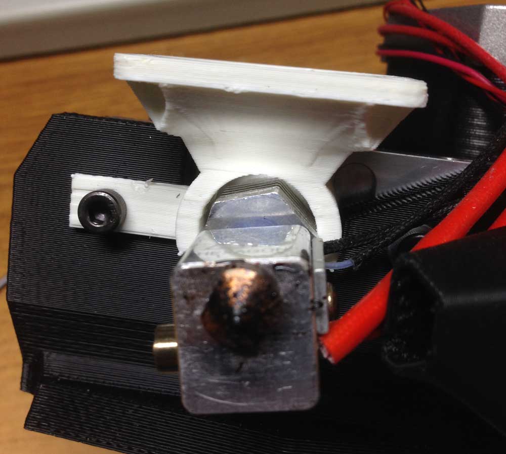

I have seen the problems people have with heat creep since the TAZ printer started using the Hex hotend. It’s caused by that tiny fan not being able to keep it properly cooled for long prints.
So I decided I would tackle the issue by making my own mount. Now, I have a TAZ 4 with the Hexagon Hotend upgrade and that is what I designed this for. I am not 100% sure it will fit on the TAZ 5 but I think it will.
This did take 8 hours of design and around 5 prints to get it right. I don’t have my fan yet (should be here tomorrow) but I am fairly confident this will work properly.
I wanted to stick with the 5v fan since the wiring is already there. I also wanted to find the best fan I could get that would not be noisy and would last a long time. I did a lot of searching and decided there was one great choice, a Noctua NF-A4x10 5v fan, this brand came highly recommended by some high end computer builders, they called it ugly since it’s brown and off white but that is the signature of Noctura and they are not from China but Austria I got my for $14.89 off Amazon.
The fan shroud fits around the cooling fins by friction but also has a single bolt mount using the existing hotend bolt.
Please let me know if this works on the TAZ 5 or TAZ Mini is you decide to use it.
Remember this is a work in progress, this might end up being the final design but I won’t know until I have fully tested it.
You can download it here [http://www.thingiverse.com/thing:845113](http://www.thingiverse.com/thing:845113)

Been quite a few years since taking fluid dynamics… But the duct should gradually compress the air. The short duct is like putting a fan in front of a brick wall. I’m guessing the center of the box fan may not be generating a lot of air flow since that’s the axis or solid hub.
With that said, the 40x40 fan should increase airflow over the OEM blower. Give your current design a shot…
If interested in making the duct and fan more efficient, consider the following:
- move the exhaust behind the heatsink so airflow wraps around the fins.
- make the duct lower to capture the lowest part of the heatsink and possibly part of the heat break (transition zone).
- make the exhaust wider than the fins to decrease backflow… Or vent the duct with additional slits.
Personally, I think the design flaw is the OEM blower sits too high. The airflow should probably start lower than the heatsink and encompass the heat break. The heat may be creeping too far up the heat break, causing the filament to swell (as it starts to liquify) and ultimately jam. Keeping the filament solid and a consistent 3mm all the way to the heater block should reduce the jamming with PLA.
Anyway… Hope it works!

Thank you for the input. I obviously know very little about fluid dynamics I just figured a larger fan would be better.
I am printing a version right now that is longer so it covers the bottom part of the cooling fins as you suggested. Even with it’s limitations (read poor design) I think it has to do better than the tiny little fan they used. Also I bought a very high quality fan because I also worried about the little dying on me and wrecking my hotend.
Again thanks for the input.

Got the fan (best fan I have ever seen), hooked it all up and I am printing now.
Just decided to look up the comparison in CFM between the included fan and the new one. Included fan is 0.57cfm and the new one is 4.83 that’s almost 8.5 X the volume of air. So even if my design is not perfect that should work better.
Not that it matters but that fan is dead silent. I hooked it to a small battery up near my ear in a quiet room and I really had to pay attention to hear anything.

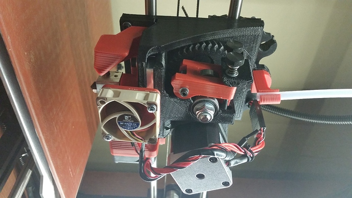

**Post date:** [March 10, 2016, 4:35pm UTC](https://forum.lulzbot.com/t/taz-hexagon-40mm-fan-mount/1799/16 "2016-03-10T16:35:29Z")
Was able to get the fan connected last night. I’m going to try printing with the PLA I was having trouble with that led to doing this mod and see what kind of difference it makes.

**Post date:** [March 10, 2016, 6:54pm UTC](https://forum.lulzbot.com/t/taz-hexagon-40mm-fan-mount/1799/17 "2016-03-10T18:54:56Z")
What extrusion fan duct are you running on that toolhead? Do you get good airflow out of the LH side?
**Author:** ![hockey1237](https://avatars.discourse-cdn.com/v4/letter/h/5fc32e/32.png) [@hockey1237](https://forum.lulzbot.com/u/hockey1237)\
**Post date:** [March 10, 2016, 10:37pm UTC](https://forum.lulzbot.com/t/taz-hexagon-40mm-fan-mount/1799/18 "2016-03-10T22:37:23Z")
You can get that dual fan duct here: [http://www.thingiverse.com/thing:1349016](http://www.thingiverse.com/thing:1349016)
It was designed by Sebastian\_v650. I haven’t taken actual measurements, but it definitely makes a difference. There’s a wall in the main duct that forces air around to the other side. I’m sure the left side doesn’t output as much as the right, but it’s a lot more than the zero air flow the left side got before.
