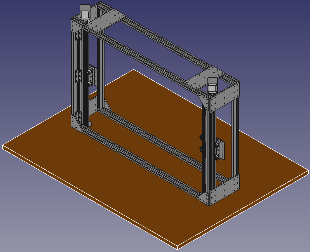

Design work towards substantially upgrading my Taz3 has begun. This will eventually support at least one direct drive extruder, four bowden extruders, a CNC mill spindle, and a \<1µm resolution laser autoleveling/lithography tool.
Some gantry brackets have been designed thus far. IMHO, AlephObjects should really consider reinforcing the frame with something similar.
Next step is to implement a better Z-axis. Currently planning to port my FlexReplicator Z-axis system, since it provides both anti-backlash and inelastic coupling, which even the Mini/Kauri does not seem to offer.

Interesting design concept. Are you noticing alot of flex with your existing taz frame? I’ve not noticed any on mine in particular. Which part of the frame seems to be flexing the most?
**Post date:** [August 17, 2015, 6:23am UTC](https://forum.lulzbot.com/t/taz-mega-unofficial-large-scale-taz-derived-machine/2140/3 "2015-08-17T06:23:57Z")
All Taz machines are adequate for 3D printing in their stock condition. However, particularly for the older Taz3, that seems to imply some routine maintenance during normal use.
Although not a flexing problem, Z-axis backlash is just enough to compromise first-layer alignment at the start of about one-in-five print jobs. Added to this, the Y-axis can deflect several millimeters under light presssure. Overtime, it seems to change position significantly, requiring steel shims or washers to maintain orthogonality. Gantry frame flex (side-to-side) is not particularly severe, but it could be contributing to the Y-axis slipping out of orthoganality.
Taz5 rigidity is comparatively outstanding, better than any of many 3D printers I have access to. However, the frame, Y-axis, and especially linear rails still deflect too much for my use case, deforming slightly under light pressure. CNC milling would probably not be good for the health of the machine. Fine nozzles, precision laser cutting/lithography, an similar uses would likely require regular manual recalibration.
Notably though, the LulzBot Mini is much stiffer than any of these machines, probably adequate for light CNC milling. Honestly, I am a bit disappointed the sheet metal frames have been dropped as Kauri was simplified to Lancewood.

The biggest culprit of Taz 3 layer slipping I found before I upgraded to the 4/5 style ends was the Z endstop target screw. it didn’t have enough friction to hold it in place, and it would push up if heated too much. the larger M5 screw on the 5 helped with that aspect quite a bit. The 3 style X to Y frame mounts also can move significantly as I later found out. The 5 style ones fix that particular issue. The rod deflection is definitly not a great thing though. I like the openrails I have bolted to mine now, they work great!
My Z openrail mod is going to incorporate several back stiffener ribs I think, mainly to keep the rail itself in allignment, but potentially to stiffen the main frame as well. I might end up adding some extra corner bracing as well when i have things taken apart to install that.
**Post date:** [August 17, 2015, 6:53am UTC](https://forum.lulzbot.com/t/taz-mega-unofficial-large-scale-taz-derived-machine/2140/5 "2015-08-17T06:53:52Z")
Interesting. However, attempting to go through the semi-automatic leveling wizard, I found the Z-axis drive mechanism did have significant backlash as well.
Looking forward to seeing your Z-axis openrail mod.
EDIT: By the way, what about C-Beam for the Z-axis?

 ![Render.png](https://us1.discourse-cdn.com/flex020/uploads/lulzbot/original/2X/0/0e50be4aaf0f0e56d028b1596b4839886f10e14d.png)

Project completely rebuilt in FreeCAD, with one Z-Axis actuator attached. Render attached, source files at github.
This is starting to go together nicely.

Z-Axis and frame final design. All-metal mounting hardware consists of only the metal gantry plates, and a six L-Brackets.
@piercet Please take a good look at the design files.

Design looks like it should work fine so far. For the Z axis bearings, since there is less force on that axis usually you might consider making the Openrail the structural member as well unless you feel you need the extra support back there.
Fast start ballscrews can be used on 3d printer X and Y axis successfully, You can see an example of that with the ill fated Aluminautis printer (which was a basically good design with bad manufacturing choices and a couple of questionable design choices that ultimately doomed them). One of the issues you may run into with an X and Y leadscrew is X and Y axis wobble. Same cause and potential countermeasures as the Z axis. It will tend to show up as excessive layer ripples. I’d probably stick to belts (potentially larger ones) or even motorcycle chain and sprocket before I would want to go with leadscrews for that rapid of a motion segment. You may want another plate at either end of the Y axis for finer bed alignment as well. The C rails you have there should be plenty stiff to avoid deflection, but that would be the area I would expect to see it too. Would also potentially make rail alignment easier. Looks neat so far!

Thanks for the tips!
Will definitely add a few more plates to the Y-axis, good idea. Also, thanks for pointing out the Aluminatus, just from photos it is clear they had a great concept and made some avoidable mistakes.
Interchangeability is one reason for the current Z-axis mounting scheme. Almost any actuator can be (dis)mounted using the side brackets. Similarly, the X-axis V-slot can be used as a mounting bracket for other hardware.
Since this will be used for CNC milling and photolithography exposure, high-precision under high-pressure at relatively low-speed is a top concern. OpenBuilds ACME leadscrews are quite convenient. With anti-backlash nut blocks, I would expect much finer positioning than belt drives or especially chain drive.
Wobble concerns me though. In the past, I have addressed this by restraining the lead screw at both ends, and minimizing linear bearing degrees of freedom. Further, PFTE greese has done an amazing job minimizing friction/wear. Any reason to expect the V-slot mechanism will not control this?
Finally, an updated render image is attached. Some Y-axis components aren’t moddled, but the basic premise should be obvious. The surface is MDF, and will be milled into alignment.

2000mm / s is very ambitious for threaded rod. If you are going to go that route, you will want to add an anti backlash nut. That’s basically 2 nuts per rod with a spring between them. That keeps the nuts engaged with the top and bottom of the thread. For the rest of the potential wobble, a drive nut with motion disconnect in the directions you don’t want travel is good insurance.
**Post date:** [August 20, 2015, 7:15pm UTC](https://forum.lulzbot.com/t/taz-mega-unofficial-large-scale-taz-derived-machine/2140/19 "2015-08-20T19:15:37Z")
Ooh! No way am I actually going to drive any CNC machine at 2000mm/s, or even close. That was mere calculation to determine maximum step rate wouldn’t cripple the machine. 😆
More realistically, 45-180mm/s will be desirable during 3D printing, with other tasks like CNC milling performed at \<\<10mm/s.
Anti-backlash nuts are definitely in the design. OpenBuilds offers an excellent component for this - [http://openbuildspartstore.com/anti-backlash-nut-block-for-8mm-metric-acme-lead-screw/](http://openbuildspartstore.com/anti-backlash-nut-block-for-8mm-metric-acme-lead-screw/) . Once the machine is operational, perhaps I will 3D print an appropriate spring mount to allow a bit of wobble.
