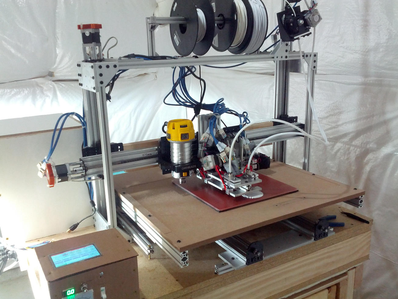

**Post date:** [December 29, 2015, 3:05am UTC](https://forum.lulzbot.com/t/taz-mega-unofficial-large-scale-taz-derived-machine/2140/29 "2015-12-29T03:05:38Z")
By now, all tools have been rudimentarily tested and used. Milling spindle has planed the table, laser has made some especially precise cuts, and a basic raft has been successfully printed by the wide-diameter (~1.5mm) nozzle. Also, an especially well-selected lumber reinforcement has been added to the X-axis for maximum rigidity.
However, the build area is drastically reduced by the large tool platforms, especially the ExtrusionPack. Will probably design a more innovative system placing all tools as close together as possible, even inside the aluminum extrusions.
 ![Machine.jpg](https://us1.discourse-cdn.com/flex020/uploads/lulzbot/original/2X/2/2f48d3804e5178043cbade9ea9840d77ff90027a.jpeg)
 ![Tools.jpg](https://us1.discourse-cdn.com/flex020/uploads/lulzbot/original/2X/6/652c4b765729f909d160d5328b54c2728e1538a3.jpeg)
 ![Print.jpg](https://us1.discourse-cdn.com/flex020/uploads/lulzbot/original/2X/a/ac65c6f04972e151c0b50b404ee3af0b53d73754.jpeg)
 ![midSlab.png](https://us1.discourse-cdn.com/flex020/uploads/lulzbot/original/2X/5/54cfe7b6f07f95392c4dfca574d1607236c6225d.png)
