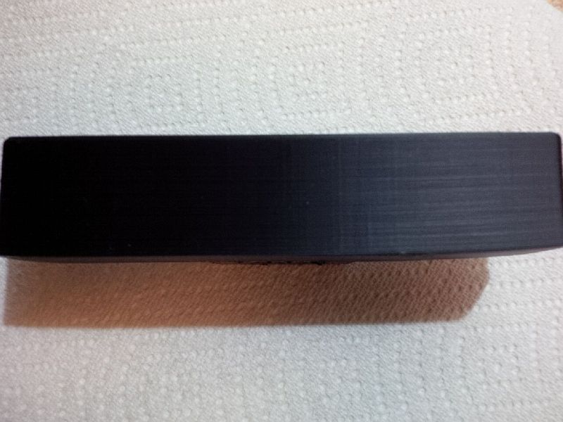

**Post date:** [June 17, 2015, 6:30pm UTC](https://forum.lulzbot.com/t/taz-min-new-project-not-sticking-to-bed/1884/10 "2015-06-17T18:30:16Z")
Well the last post here got ate by the forum. One end pulled up 2 or 3 mm
This one printed with full microfiber cover, 250/110, Brim, Orientated on the Y axis. Using TAZ ABS, bed wiped with acetone.90 to 100 DegF under the cover. The bottom picture shows the square cut out but it had brim material and really I just took out with a sharp chisel. This is still the old heated bed, Lulzbot has not shipped the new one I ordered yesterday.

**Post date:** [June 17, 2015, 8:06pm UTC](https://forum.lulzbot.com/t/taz-min-new-project-not-sticking-to-bed/1884/11 "2015-06-17T20:06:09Z")
From the picture, whatever side of the printer was the side that the right half of that part in the bottom picture printed on is not level. The first layer adhesion there is horrible, which means that the bed leveling isn’t leveling things properly. I’d check and see if the washers are truly flat and parallel to one another, that the nozzle is really clean and able to conduct properly to sense where it is contacting the nozzle, and check the bed glass, bed plate and your X axis for level. You might even want to manually level the Z axis rods. Its looking to me like the one on the “right” is a quarter turn off at start. The leveling script should account for that though. Is it touching each corner washer before it prints?

**Post date:** [June 17, 2015, 9:26pm UTC](https://forum.lulzbot.com/t/taz-min-new-project-not-sticking-to-bed/1884/13 "2015-06-17T21:26:21Z")
> [@piercet](#):
Its called warping, the layers are not sticking and I have done everything. The mini is self leveling and yes its doing it correctly and yes it did the same thing (only worse on both ends) turned 90 degrees the other way. This is a “new” machine out of the box, nothing adjustment wise should need to be done.

**Post date:** [June 18, 2015, 5:28am UTC](https://forum.lulzbot.com/t/taz-min-new-project-not-sticking-to-bed/1884/17 "2015-06-18T05:28:57Z")
Hmm… Definitely looks like an adhesion problem. Once air creeps underneath the project will continue to warp. I would typically say get the nozzle closer, but the autolevel on the Mini negates that…
Make sure the bed isn’t hitting the microfiber blanket… The bellowing might create unwanted airflow. And especially make sure the bed doesn’t lift the blanket to let in cold air.
The lifting at the corners is pretty common. Give the part a 45-90deg z-rotation in the slicing program. Basically reduce the profile in the y-axis (because the bed moves in the y-axis creating airflow). And try a bit more brim… 8-10mm (will need to calculate based on your extrusion width). If the brim helps you can dial it back to reduce waste.
The other reason the part is lifting could be due to the density of extruded material in the corners. Try changing infill to 40%, set the perimeter walls to 1.5mm (calculate perimeters based on your extrusion width).
Regarding getting the nozzle closer to the bed after autolevel, use the z-offset gcode setting in the slicer software. Set a -.1 to -.2. The negative number puts the nozzle closer to the bed and a positive number would raise the nozzle.
The bed doesn’t look good… It should be red like the corners. The cloudiness looks like its dried out or lifting from the glass. Try a good scrub and wipedown with isoprpyl alcohol… not too often though since the PEI may dry out.
Lastly, try printing the gcode files from the following:
[http://download.lulzbot.com/Mini/1.0/calibration/](http://download.lulzbot.com/Mini/1.0/calibration/)
These are factory generated gcode files which should work with the Mini. Actually, if you’re printing ABS, you may need to modify the extrusion temp. The file (octopus calibration) looks like the temp is set to 225C (based on the M109 S225 line). So open the .gcode file in a text editor and find the M109 command line which is four lines above the empty line. Change S225 to S245. Now you’ve set the extrusion temp to 245C… Which should be good for ABS. Load the file into your printer control program and try printing.
Sorry for the long post. Hope something helps you out.
