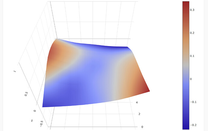

For comparison, here’s a 25-point measurement with BLTouch on my Taz 6. It has the Octograb aluminum plate and smooth PEI sheet, for reference:
 ![image](https://us1.discourse-cdn.com/flex020/uploads/lulzbot/original/2X/e/e9bf97c9d9bfc532553668abd38752f2b9efb186.jpeg)
It’s less than .50mm off from edge to edge, so that front right washer seems like it might need a good cleaning, or maybe just try loosening it, rotating it a few degrees, then tightening back down.
This is where the washer method really shows its limitations. You’re compounding standard fluctuations in the bed (like you see here) with the addition variable of how clean the nozzle is, tension on the washers, and such. Print-surface measured leveling is definitely the way to go, and after adding BLTouch to the 6 here at work for a grand total of $15 (BLTouch clone) and about 3 hours doing a clean build of Marlin, I truly don’t understand why LulzBot hasn’t made this available officially. No new board required. The Pro is going to get touch as soon as they get more touch sensors.

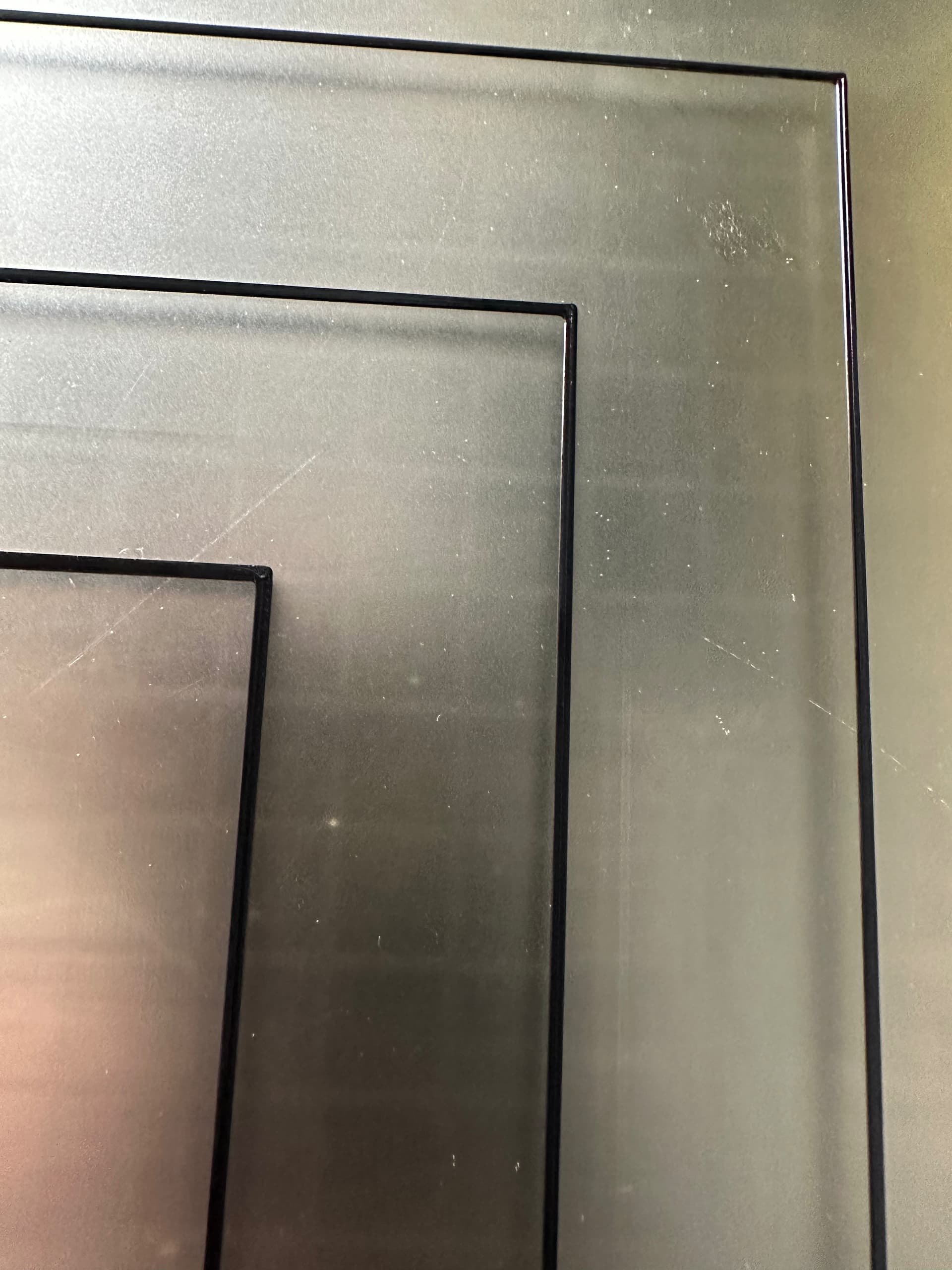

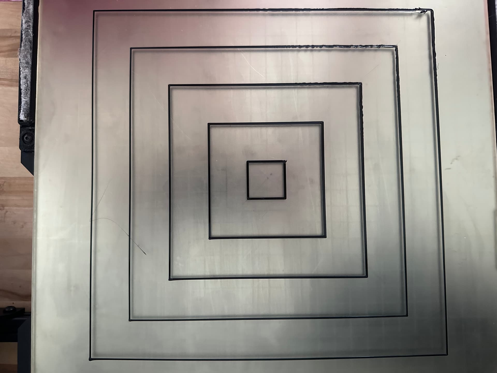

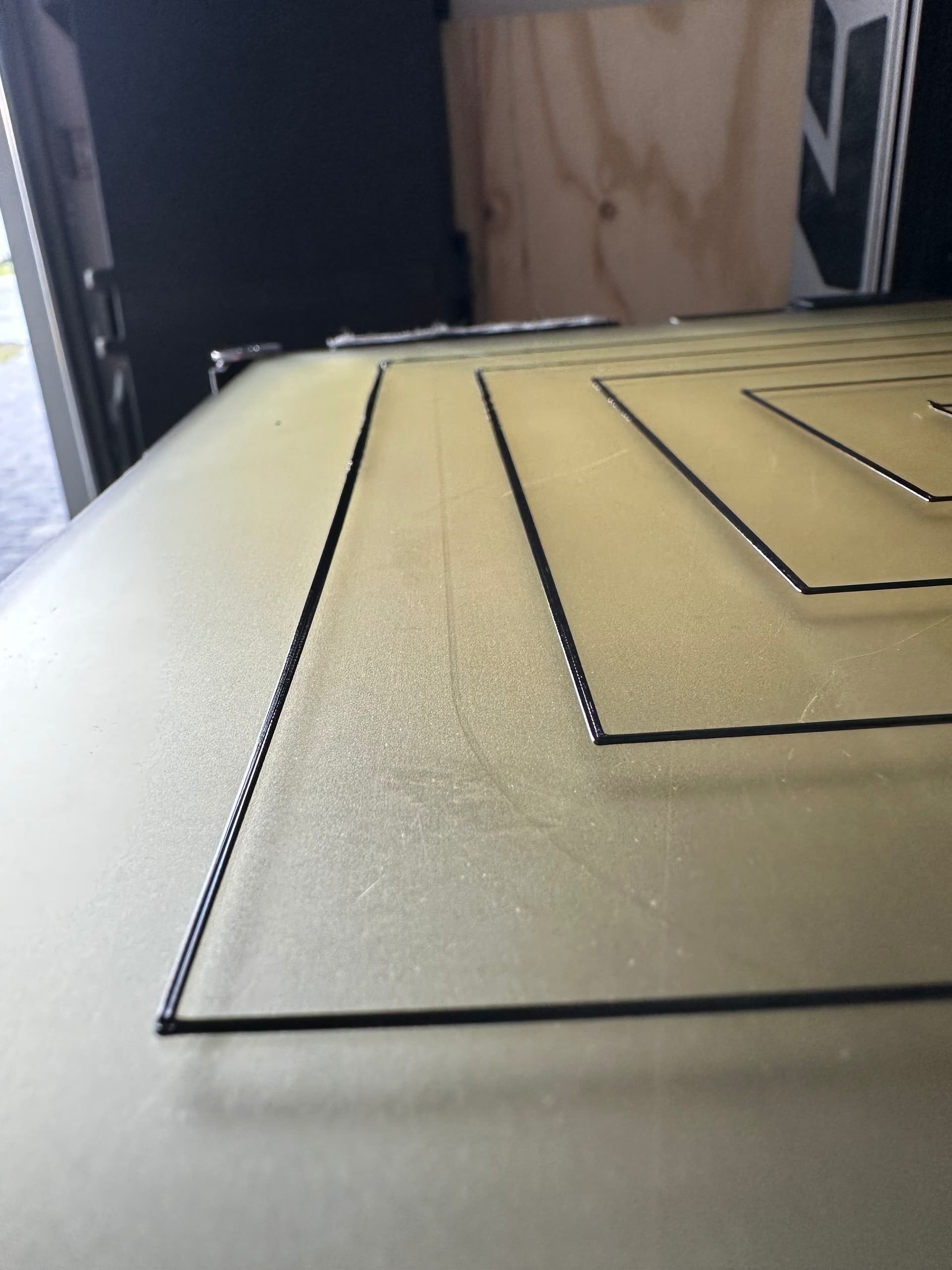

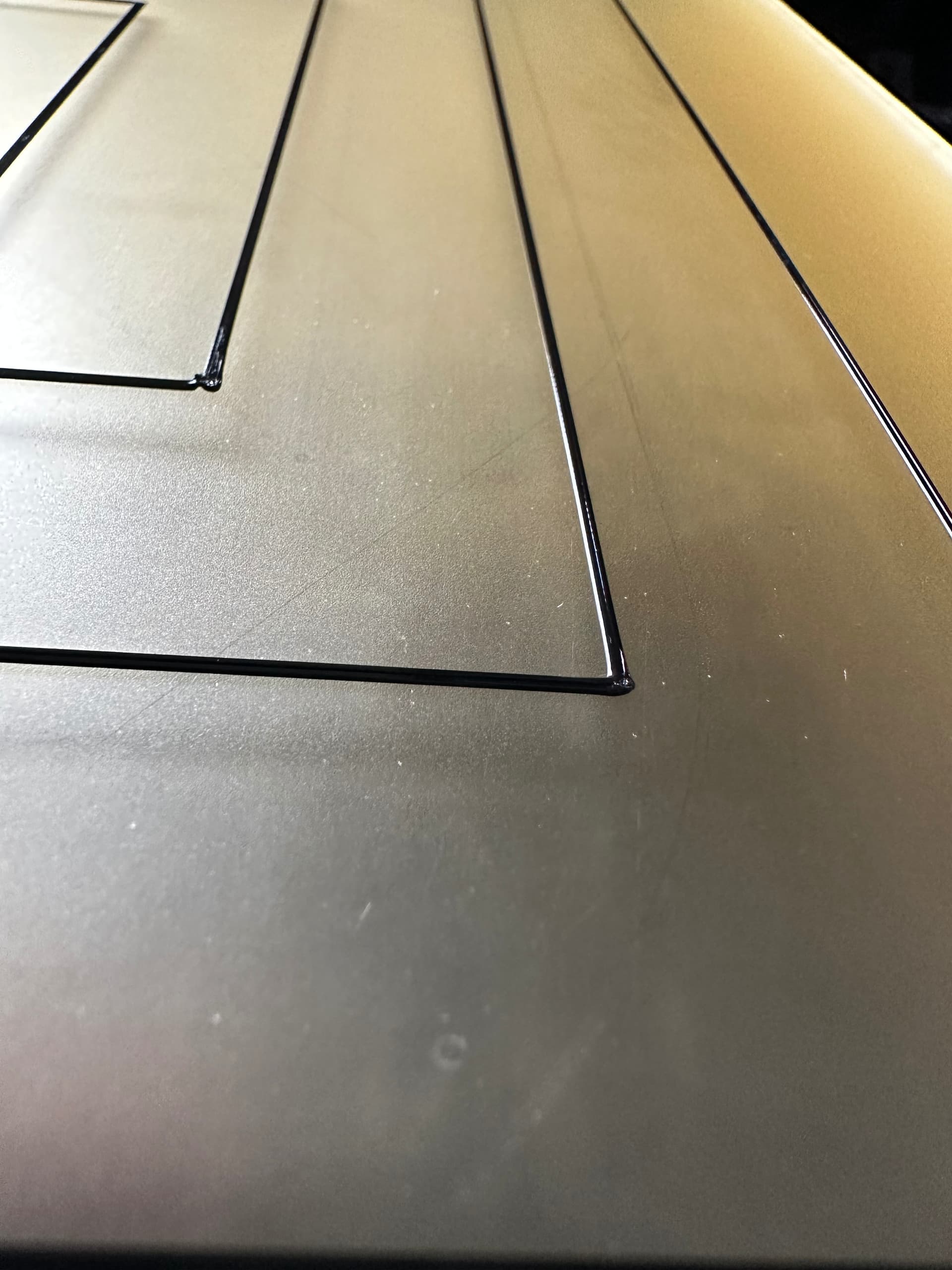

BLTouch sounds like something to definitely look into. In the meantime my results remain problematic and very repeatable. After a lot of frustration with poor adhesion on some large prints, I tried an experiment to “display” the bed leveling results. Printing concentric squares on the plate (1mm lines, 2 filament line widths) definitely seems to show my issues. Some areas have very rounded lines with almost no squish into the plate while other portions begin to block filament from even being extruded. I have repeated this multiple times with careful nozzle, bed, and leveling washer cleaning. Additionally shown to be an issue on multiple build plates.
Again, I am blind. Had someone help take a couple pics. Not sure how well they show my print. I am well aware of Z offset often being an adhesion/first layer height issue but I simply do not see a Z offset that can account for this.

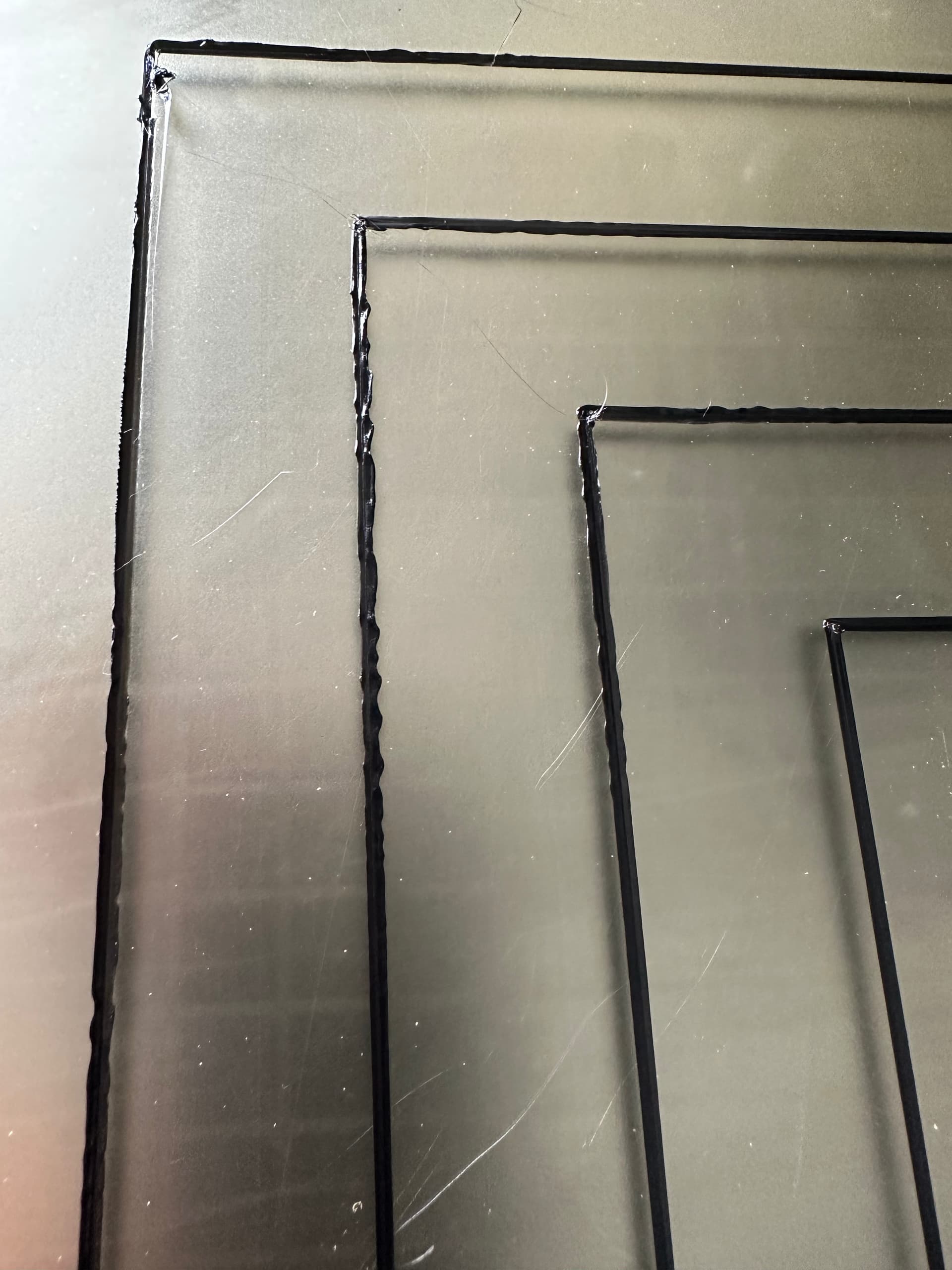

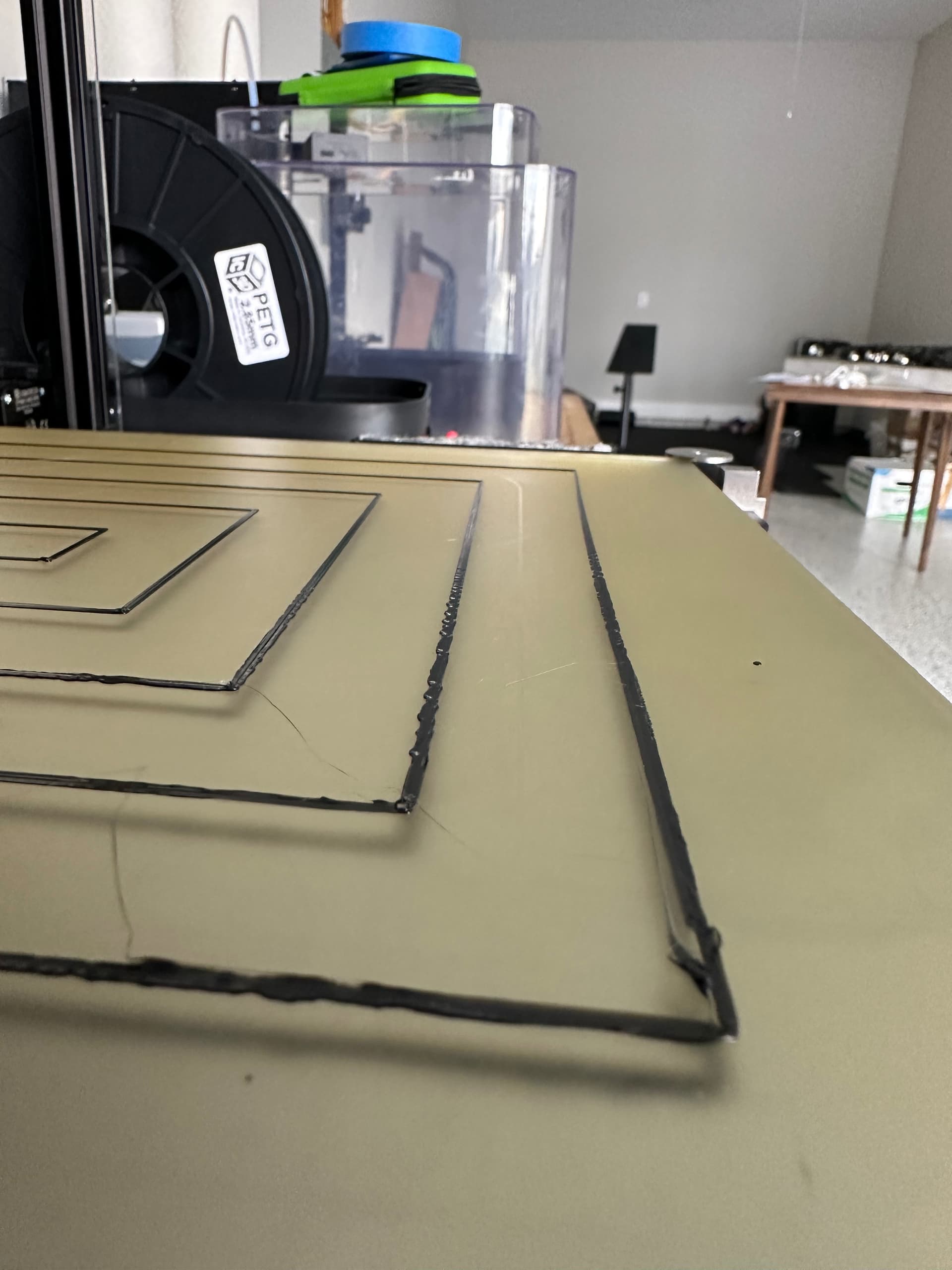

Two more

**Post date:** [June 5, 2023, 1:28am UTC](https://forum.lulzbot.com/t/taz-pro-bed-leveling-questions/25652/11 "2023-06-05T01:28:30Z")
The only spot that looks significantly out of tolerance is the front left. Some firmwares start leveling at the front left, others at the rear left. If yours is starting at the front left, it’s most likely a little bit of filament on the nozzle that delays sensing on that corner, resulting in the sensed location of the bed being lower than it should be. After the filament gets squished out of the way, the other three corners sense correctly.
If your starts at the back left, then you might have the bed bowing up slightly. This could be the result of the bed tightened down when cold, then expansion is causing it to bow upward. Try loosening the washers at the corners slightly, heat it up to normal temp, then tighten down again.
**Author:** ![bprint36](https://avatars.discourse-cdn.com/v4/letter/b/a8b319/32.png) [@bprint36](https://forum.lulzbot.com/u/bprint36)\
**Post date:** [June 5, 2023, 3:49am UTC](https://forum.lulzbot.com/t/taz-pro-bed-leveling-questions/25652/12 "2023-06-05T03:49:11Z")
Yah. Mine starts at the front left. Running a variety of tests I have been watching for any sort of filament getting in the way on that corner. I have performed leveling both with the extruder hot and cold and always get the same measurements. My concern is that something happened during a recent move across the US. The printer was packed according to the OHAI instructions in Lulzbot packaging, but these issues are definitely new on this machine.
