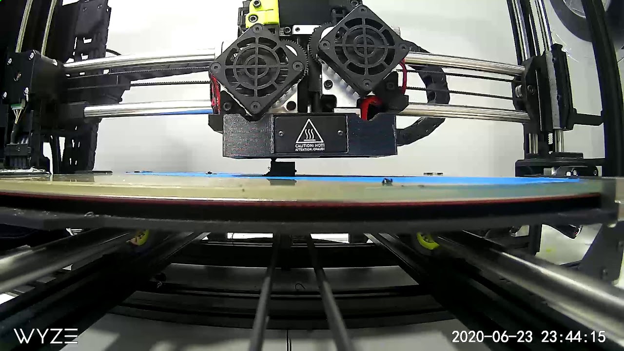

Here are some videos that I took. There is a lot going wrong here.
[![](https://us1.discourse-cdn.com/flex020/uploads/lulzbot/original/2X/7/75b7de3a124ed4edbe3d4daa46335b5a73bbf1c7.jpeg "Nozzle lower in middle of print") ](https://www.youtube.com/watch?v=_wLp7v2M3uk)
[https://youtu.be/eS\_Yss1GyN8](https://youtu.be/eS_Yss1GyN8) (listen for the ‘click’ … that is the nozzle hitting the print)

**Post date:** [June 24, 2020, 3:58pm UTC](https://forum.lulzbot.com/t/taz-pro-nozzle-calibration-variation/21921/5 "2020-06-24T15:58:35Z")
The top of the print should be flat. In the first video (looks like a 3D Benchy), the top isn’t flat at all. I’m guessing this is a case of over extrusion. Try adjusting the flow rate down (try 98, 96, 94). You might also want to re-calibrate your E-steps (you can find descriptions of how to do this everywhere).

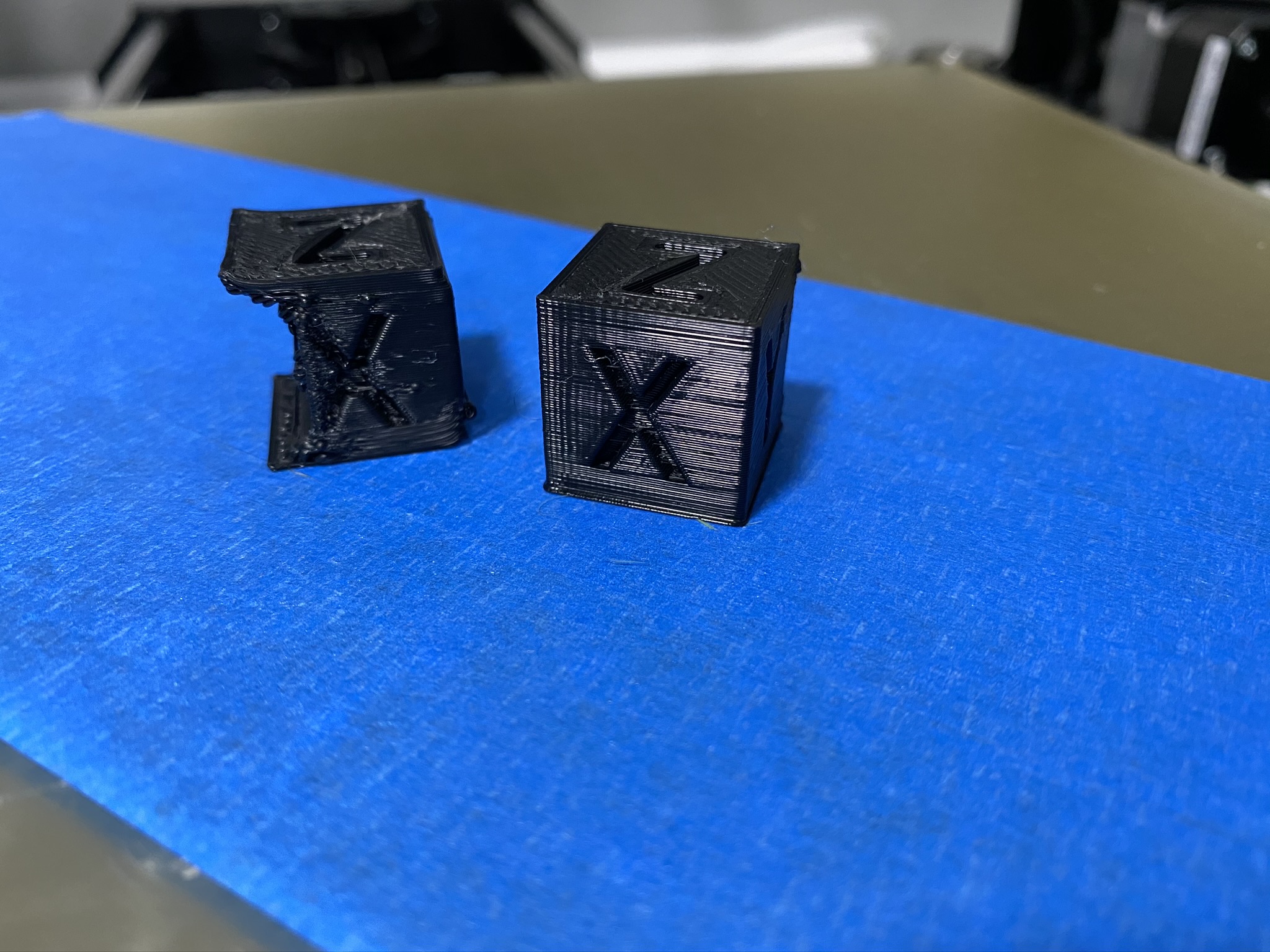

 ![IMG_2411](https://us1.discourse-cdn.com/flex020/uploads/lulzbot/original/2X/7/764b96409eab5e612a1ddd4a95cbe72e385127a9.jpeg)

When I printed that 20mm cube last week, the measurements were within .1mm +/- in all directions

I have not performed any adjustments to the steps/mm yet. When I printed the black cube above last week, the measurements were extremely close, (19.98, 19.95, 19.92). Given the nozzle hitting problem I was having, and Lulzbot support response, I was trying to dial in the Z-offset, which was at the factory set -1.35.

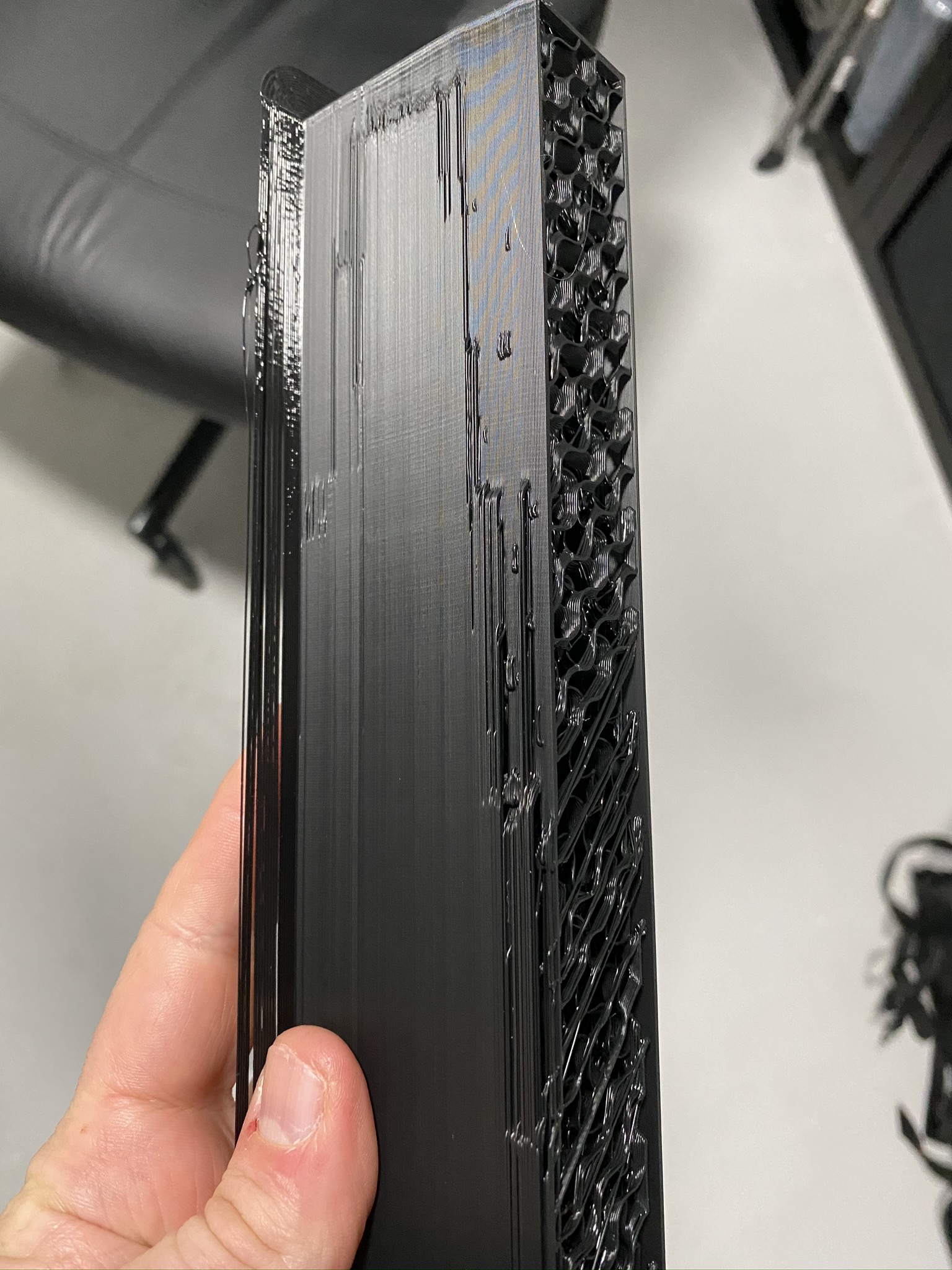

I have printed numerous prints to try and get that dialed in. When the z-offset gets to about -0.9, the filament is too far from the print bed and does not adhere properly. I had adjusted it to -1.0 and was having decently luck with adhesion as well as a decent pattern on the first few layers.
I then printed a large print (14 hours) successfully and kicked off another larger print (22 hours). During that 22 hour print, I could HEAR the print head hitting the gyroid infill pattern when it finished on layer and was traveling back to start the next layer. A few times those ‘hits’ were quite loud.
About 6 hours into the print, I cancelled it because there were a bunch of layers that were obviously shifted. I suspected the nozzle hit the print and skipped a gear and was ‘off’ slightly…
 ![IMG_2402](https://us1.discourse-cdn.com/flex020/uploads/lulzbot/original/2X/f/f303d73d7d8a14e8ff9e3480890e7f7e039df587.jpeg)
So I attempted to do another auto-calibration (filament removed & nozzle cleaned).
After the auto-calibration, things were MUCH worse.
So I reset the printer to factory settings and tried to print a basic 20mm cube again.
Autolevel failed
I tried again and watched more closely… the nozzle was about 10mm to the left of where it was supposed to be. It was ‘wiping’ in air and then missing the auto level washer altogether… hitting the print bed instead, VERY hard.
So I ran another auto-calibration… then ran another 20mm cube. That is the ‘squished’ cube you see in the photo above and the short (third) video above.
Currently the printer’s steps/mm are set to (I’m assuming) the out of the box
x- 100 steps / mm
y- 100 steps / mm
z- 500 steps / mm
My nozzle offset is (based on auto calibration)
x- 49.29mm
y- -0.16mm
z- -0.48mm
My z-offset is currently -1.20mm
I am going to try and print any other 20mm cube and see what happens.

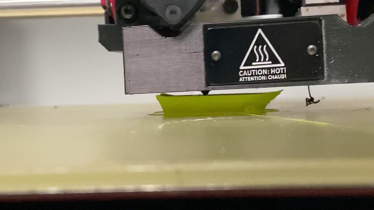

I wanted to try some adjusted flow rates… so I sliced the xyz 20mm cube in cura lulzbot edition and adjusted the flow down to 95% just to see what happened.
As the printer is autoleveling, it wipes itself properly, it probes the first sensor (front left) and the travel to the second sensor (front right) and I could SEE the print head ‘slip’ or pause about half way there and then the probe missed the sensor by 5-6mm too far to the left.
The lulzbot then tried to ‘home’ itself and start the process over. This time the nozzle was too far to the left and missed the wiping pad completely and the right nozzle ‘wiped’ itself on the print bed.
This video was me trying to see if the belt would slip again… it did not but you can see everything is off to the left
[![](https://us1.discourse-cdn.com/flex020/uploads/lulzbot/original/2X/2/2a136b901fc039ef238050c78bb2886071c310d7.jpeg "To the left") ](https://www.youtube.com/watch?v=v5ZLWiUAkIA)
So it seems I have a x-axis belt that is slipping?

I was able to get a short video that shows the moment the offset happens…

**Post date:** [June 25, 2020, 1:01am UTC](https://forum.lulzbot.com/t/taz-pro-nozzle-calibration-variation/21921/14 "2020-06-25T01:01:51Z")
I’m looking at this photo where you are holding the failed part that has the brim around the bottom and I’m noticing that the laps of the brim haven’t adhered to each other.
This tells me you aren’t getting enough “squish” – your Z-offset is still too high above the bed.
If you think about the filament extruding a round shape … not an oval … and then think about the point-tangent touches the bed … barely resting on it … and also barely having any contact with the adjacent lap of filament on the brim.
Now consider that you lower the Z-offset so that the .5mm diameter filament doesn’t actually have .5mm worth of space between nozzle and bed. It has to flatten out a little. This converts the “round” shape into a fat oval shape. More of it is in contact with the bed and it also gets wider which makes it bond to the filament in the adjacent lap. This creates a stronger bond.
I would lower your nozzle (z-offset) … e.g. if you were at -1.3 then maybe try -1.35.
ALSO, your slicer will have some 1st layer height (e.g. maybe it’s 0.35mm) … grab a pair of calipers and measure that brim to see if it is 0.35mm thick. If it’s thicker, adjust accordingly.
This assumes your e-steps are calibrated. Since you aren’t using extruder 2, just do the e-steps for extruder 1.
Follow these instructions to calibrate … with one caveat:
[https://ohai.lulzbot.com/project/fine-tune-mini-extruder/calibration/](https://ohai.lulzbot.com/project/fine-tune-mini-extruder/calibration/)
The caveat is I think there’s an error isn’t the compensation adjustment. Instead, use this math:
 New_Value = 100*(Old_Value/Measured_Extrusion)
E.g. the factory default E-steps value is 420 steps per mm.
It will ask you to manually measure and mark the filament 100mm above the extruder and again at 120mm above the extruder. Then extruder 100mm worth of filament (the link above explains how to do this … and do this with the tool head pre-heated to your normal printing temperature for PLA and for your PolyMaker PolyLite PLA that’s 230°C (you should be using that temperature when printing that particular filament on the TAZ Pro … if not, that could be part of the trouble.)
Example: Suppose you tell it to extrude 100mm but when you measure it, you find that it really only extruded 96mm (under-extruding by 4mm)
You would do: 420 ÷ 96 x 100 = new value (which works out to 437.5)
Then you would enter the new E-steps using: M92 E437.5
Then re-run the test (mark 100mm and 120mm points on the filament and extrude another 100mm at 230°C as before following the instructions).
If you actually do get the full 100mm then it’s time to save (commit to non-volatile memory) by sending the printer an M500 command. If it doesn’t come out right, you’d re-do the math, set the new number, and try again.
If you’re getting the correct extrusion (e-steps) and you have the correct Z-offset and your measured brim or skirt height is correct (measure it MANY different points… it isn’t unusual to find that one side is thicker or thinner than another if you did not get a _perfect_ bed level.) then you should start getting better prints (again, print that particular filament at 230°C … I’ve run the temperature tower on it and that’s the number I consistently get with the best quality.)

The X-axis belt is … unlikely to be “slipping”. The more likely scenario is that it is triggering the “bump sense” of the TAZ Pro.
See: [https://marlinfw.org/docs/gcode/M914.html](https://marlinfw.org/docs/gcode/M914.html)
Unlike some prior models which had physical limit switches, the Pro has few physical switches and relies on “bump sense”.
The notion is that that there’s a power draw as the motor is moving but if the axis hits the limit of travel, then the power draw will increase (spike up) when the motor hits the travel limit and fights to try to keep moving. The board senses this spike in power and interprets it as having reached the limit of travel.
But… it can be false triggered by just running into some resistance in movement during a normal print (such as a raised or warped surface). This creates a false alert that it has hit the travel limit … even if it has not.
The X-axis (and Y-axis) glide on ‘Drylin’ glide bearings. These are not mechanical ball-bearings but rather a nylon-like material that glides on the rods. There are a couple of screws that control the clamping pressure of your X-axis carriage. If these are set too tight, it can create excess friction/resistance which increases the power draw on the motor and that can trigger false positives – making the printer think it has hit an endstop even if it has not. These glide bearings naturally wear throughout the life of the printer. Just like the tires on your car … you don’t have to replace them after just one trip… but 30-50k miles later and … the wear is noticeable. As the bearings wear in, they’ll loosen up a little … but at some they get enough wear that they may need to be replaced (they’re cheap… these are like $5 things).
My TAZ Pro was a bit tight on the X-axis and was getting layer shifts. I tried adjusting the “bump sense” values but if I adjusted it to make it more tolerant of the friction, it would result in the printer not recognizing when it hit the end-stops when “homing” the axis.
Ultimately I had to slightly loosen the clamping pressure on the bearing. You can check step 7 on this page:
