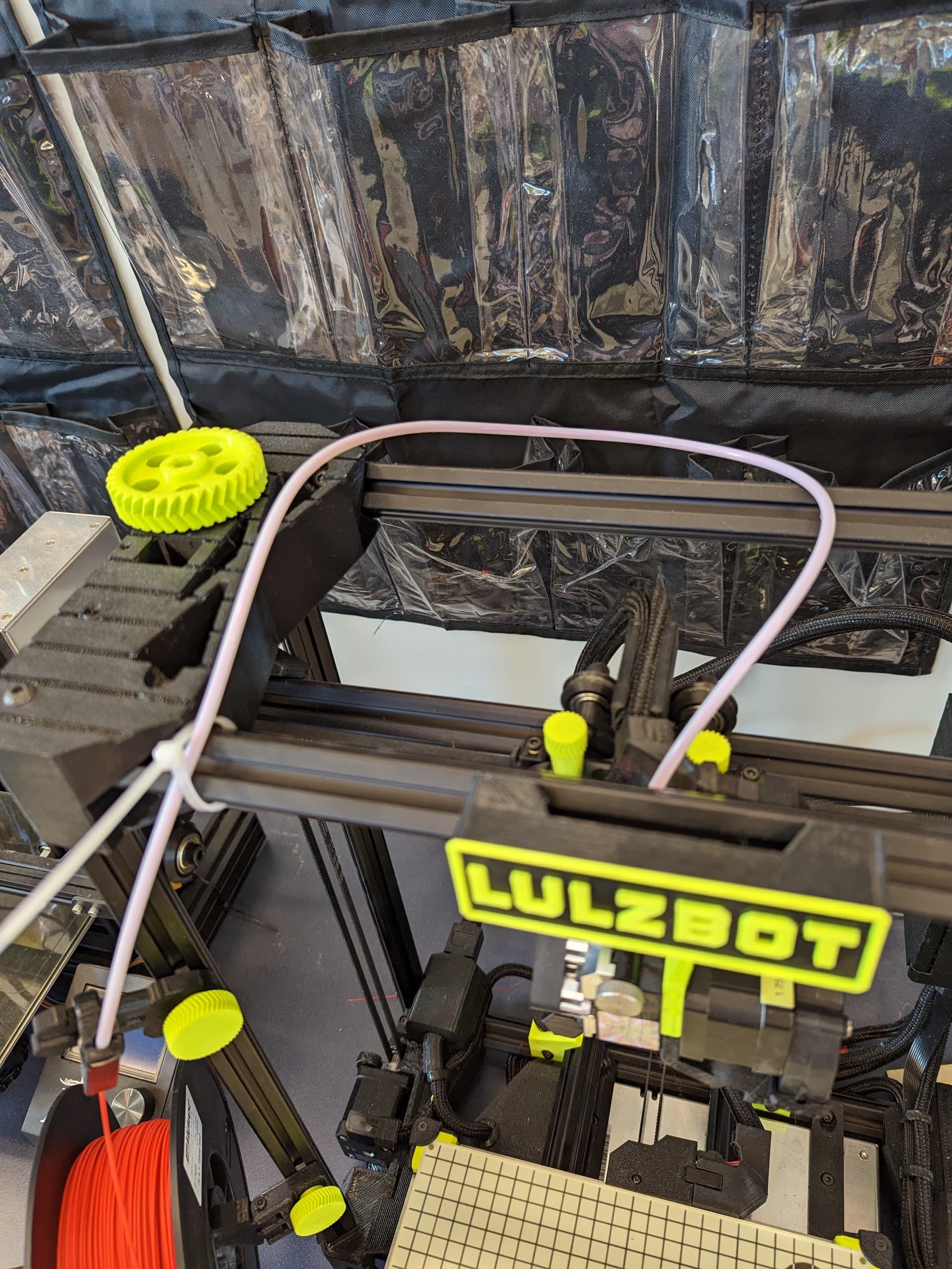

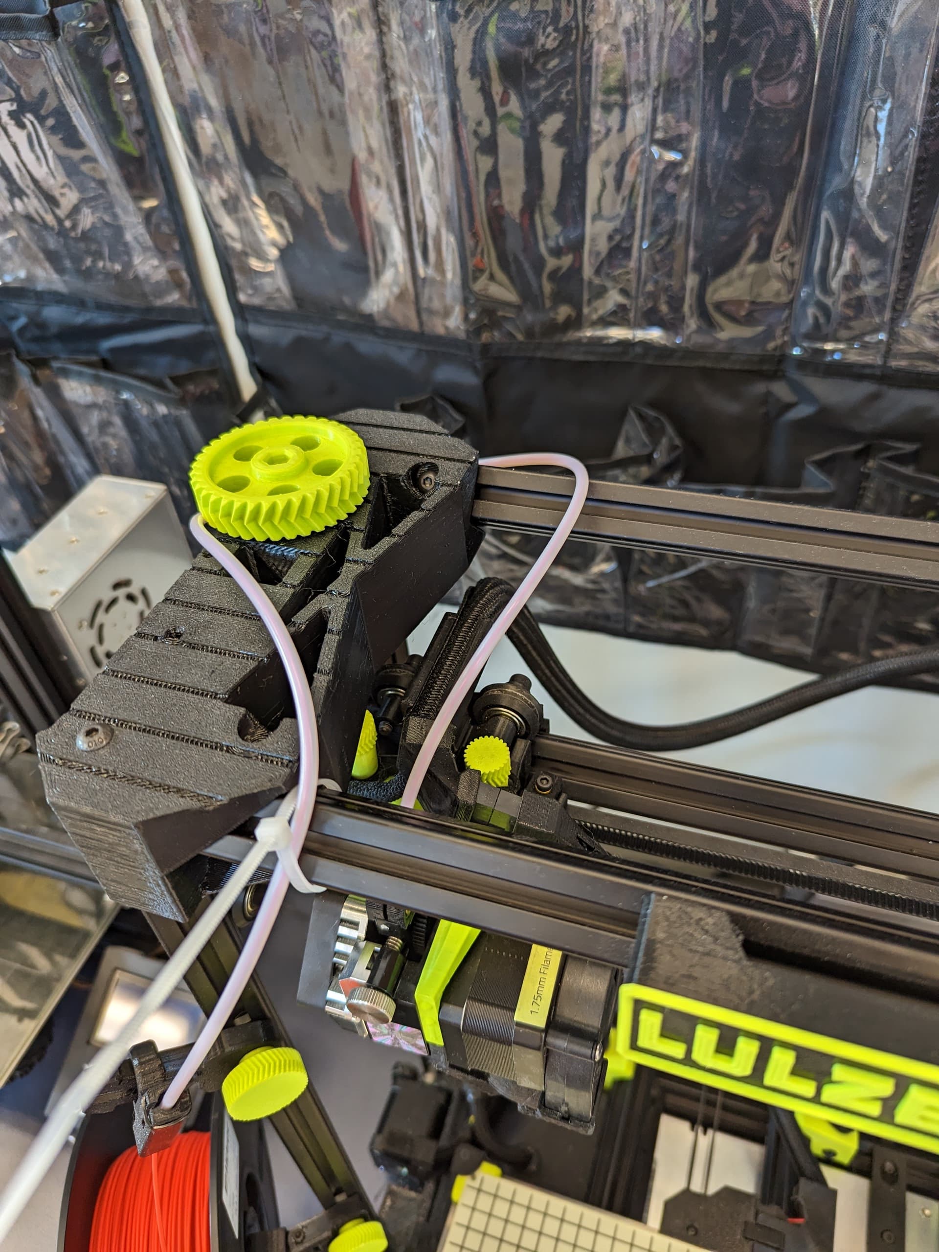

Yes I should have kept better care of the original packaging. I kept all the orange pieces to pack the printer but one of my students grabbed the cardboard box (it was a wonderful 3ply cardboard which is hard to find) and lasercut somethign awesome out of it. I did fix the problem and I will post it below.
Some of the default movements to max z and -x direction caused the filament guide tube to wrap around the left side belt tensioner. Then when the printer would would print - the aut level would be accurate because the BL touch is on the back of the extruder and would not get pulled, but when the printer went to print the tension of the tube would increase only as it approached the +x axis lifting the nozzle up slightly. There is a strange amount of “wiggle” in the toolhead - it seems very easy to raise up and down compared to the TAZ5, and 6. I suppose this is because it is on V wheels on a single piece of extrusion. You can see in the two pictures how one is wrapped around the belt tensioner. I would often unwrap it but some part of the homing/ startup process would rewrap it - I have found that a zip tie will keep it from getting wrapped again.

**Post date:** [April 14, 2023, 1:17pm UTC](https://forum.lulzbot.com/t/taz-sidekick-747-doesnt-work/24025/8 "2023-04-14T13:17:21Z")

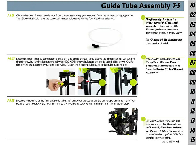

Your tube routing path looks a bit off from what LulzBot shows:
 ![image](https://us1.discourse-cdn.com/flex020/uploads/lulzbot/original/2X/7/7fc4ffe74a8e7674e44067ab1afca17948f267dd.jpeg)
But the routing of that tube is not part of the user manual:
 ![image](https://us1.discourse-cdn.com/flex020/uploads/lulzbot/original/2X/9/9408fc4e11e6451ffc78c1378005b930ab7527d2.jpeg)
So, it’s a bit of a shortcoming in the manual if this part is unclear and leads to failure. At how infrequently those tensioners should need to be adjusted, it’s a bad design to have it protrude so much without a slope that encourages the tube to slide over it easily.

**Post date:** [May 19, 2023, 2:04pm UTC](https://forum.lulzbot.com/t/taz-sidekick-747-doesnt-work/24025/9 "2023-05-19T14:04:43Z")
Yea the tube routing path shown in the picture you have posted is what caused the problems.
because the z toolhead parks at the top of the printer all the slack comes over that belt tensioner and it will get stuck around it.
Because the autolevel prove and nozzle are like a lever this caused the autolevel to be only slightly off while the nozle was pulled high enough that it would not get adhesion on the right side of the build plate.
