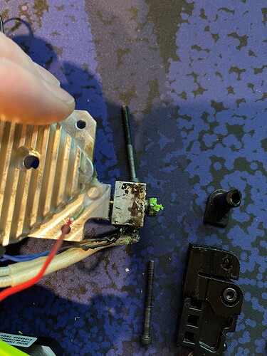

Edit2: I just disassembled the print head. The drive motor for the feeder is extremely hot, I’m guessing 140F or so, and that was after it was not feeding for about 2 or 3 minutes. That seems hot to me but not sure, could the heat problem be coming from the drive motor into the spline that drives the filament?
I just disassembled the print head again, here are pictures:
 ![image](https://us1.discourse-cdn.com/flex020/uploads/lulzbot/original/2X/6/6c8a30ce9ee4b1112ef89c6fe2fbdd304c9f05ae.jpeg)
 ![image](https://us1.discourse-cdn.com/flex020/uploads/lulzbot/original/2X/e/e20c69acd5f3d125075f0b3b1deae1d4a84a8263.jpeg)
**Post date:** [July 20, 2022, 1:36pm UTC](https://forum.lulzbot.com/t/taz-workhorse-filament-grinding/24705/18 "2022-07-20T13:36:20Z")
Z offset is too high on both of those rocktopi.
Just re-looked at the pictures, and those thermistor wires look sketchy. It wouldn’t hurt to replace - [100k Semitec NTC Thermistor | Thermistor for 3D printer | LulzBot](https://lulzbot.com/store/100k-semitec-ntc-thermistor-kt-cp0110?ref=KT-CP0110).
Another thing to check is the filament path before the toolhead. If you’re running through tubing and there’s a tight radius, the filament may be rubbing enough to be a problem.
If it was 140F when printing, I wouldn’t be concerned, but after a few minutes, it shouldn’t be that hot. Nema 17 motors are quite cheap and easily replaced, so if you have a spare, throw it on and see what happens. If you don’t have a spare, the LDO motors from [lulzbot.com](http://lulzbot.com) are fairly well-priced and are plug-n-play - [Half Height NEMA 17 Stepper Motor, LDO | LulzBot](https://lulzbot.com/store/half-height-nema-17-stepper-motor-ldo-kt-mt0004?ref=KT-MT0004). Before buying a new one though, run the print without any filament and see if your motor is getting just as hot.
