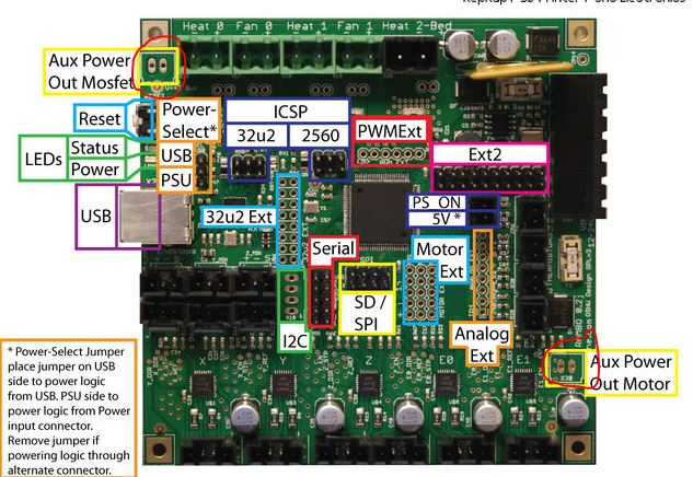

Keep in mind if you order a board from Ultimachine (less expensive than the kit from Lulzbot), a couple sets of pins will not be installed. You can easily add them. Ultimachine might just throw some pins in the box if you ask during the order. They are a great company, in my experience with them.
The Aux Power Out Mosfet is 5v for the E1 fan and Aux Motor Out Power is always on 24V that is unused by default on Taz 5.

@Nopick, do I simply need to solder a couple of these pin pairs to those points on the board if Ultimachine won’t do it? And are these just jumper points, or are there plugs from the Taz wire harness attached? (I’m sure if I open the case, I can find out ; ) )

The Aux Power Out Mosfet connector will have wires attached for the 5V E1 fan. The Aux Motor Out Power is unused on a Taz 5.
The pins are through hole and pretty easy to solder to the board if you have any soldering experience.

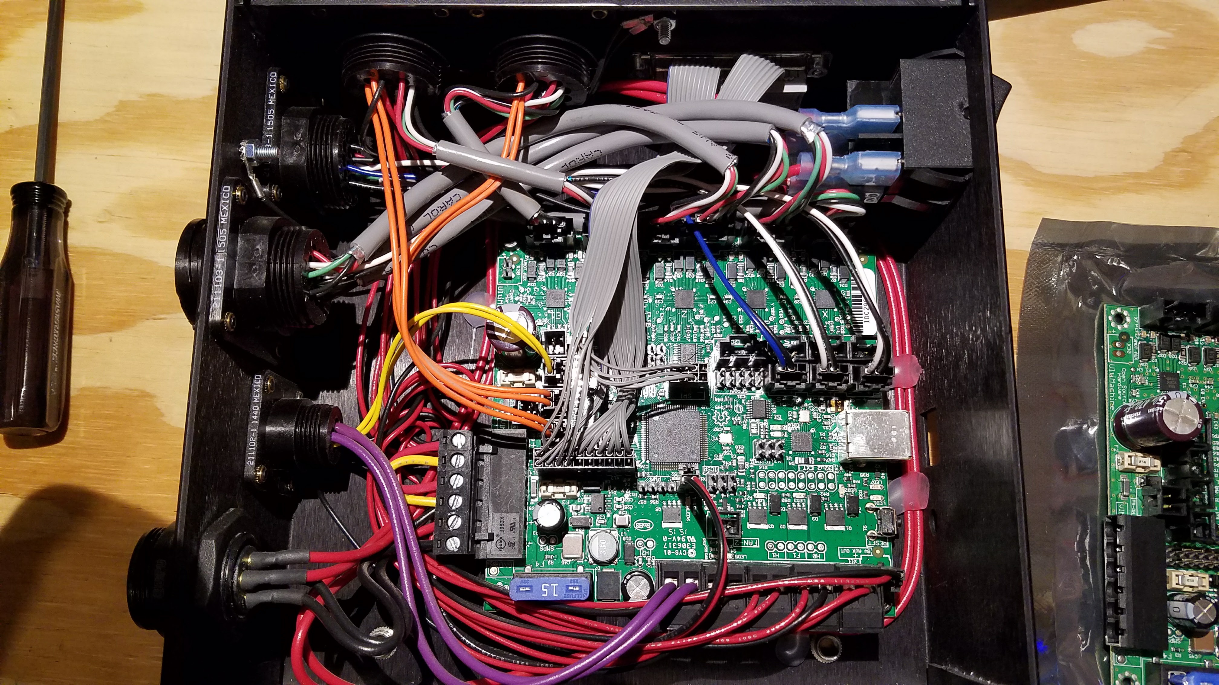

I used a sharpie to label similar connectors 1,2,3 and so on from left to right or top to bottom to make installation easier. I labeled the motor connectors x, y, z1, z2, e0, e1 as I removed them from the old board. It is really easy to swap boards… Don’t sweat it. Taking a bunch of pictures before you tear into it can also help.

SUCCESS! 😃
After staring at the controller box for a good 30 minutes, examining and working up the courage, I took the leap. I think it took all of 15 minutes to do the brain transplant.
A little freaky when I turned it on, and got no display on the LCD, but system found the board and installed drivers. Once the firmware upgrade was done, the unit rebooted about 10 seconds later.
Updated my E-steps and I’m printing a test print now.
