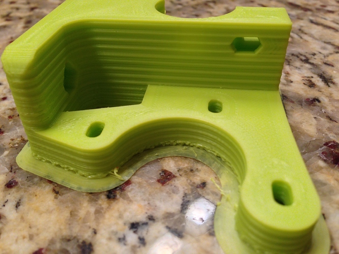

Hey Guys,
I thought I would post some pics of my on going AO-101 prints. Hopefully they will improve as time goes on. These are two of my first decent size prints with the Lulzbot green.
 ![image.jpg](https://us1.discourse-cdn.com/flex020/uploads/lulzbot/original/1X/89f2490db3a30d6599a2b2676e016e66517faf5b.jpeg)

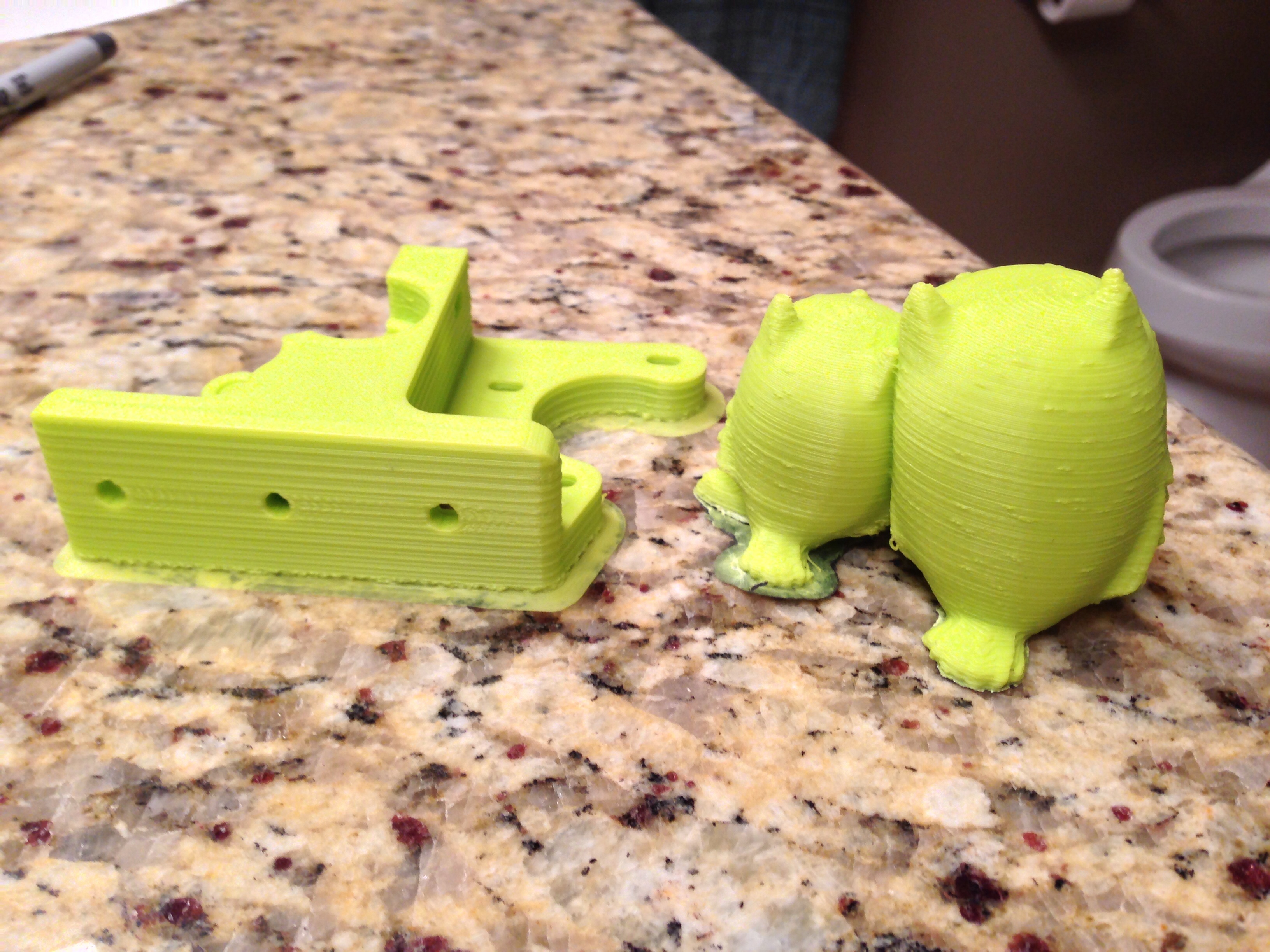

Here is a little owl that I printed based of a Thingiverse STL. I think it looks fairly decent though some noticeable banding. I plan to test out some acetone smoothing on this.
 ![image.jpg](https://us1.discourse-cdn.com/flex020/uploads/lulzbot/original/1X/80c8180b2f25c1792774185474084de11e0e637c.jpeg)
Here is the shot of the owls and the replacement extruded I printed out.

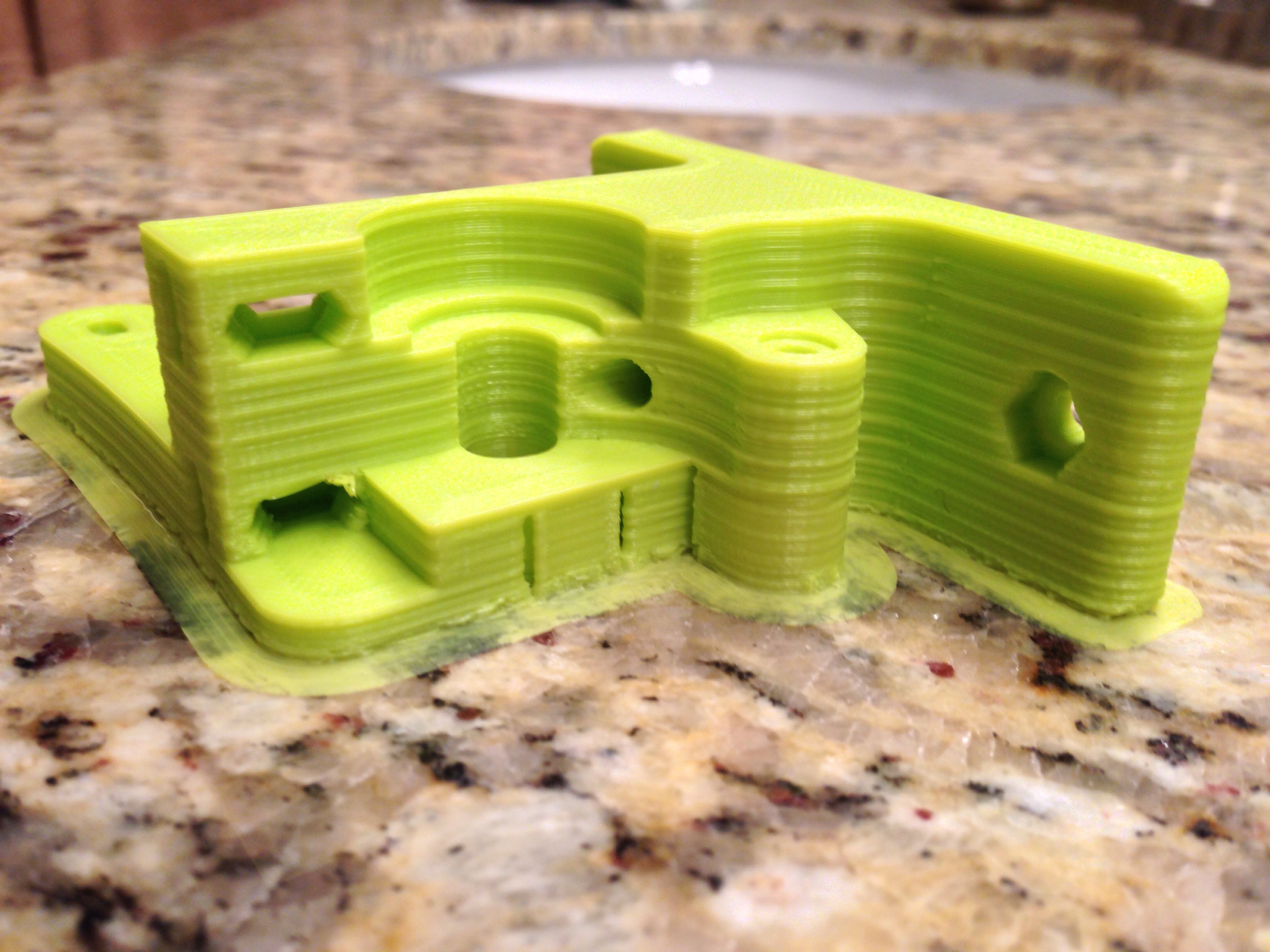

 ![image.jpg](https://us1.discourse-cdn.com/flex020/uploads/lulzbot/original/1X/65224b2f47bc68a21c33928483790f6a6e66a5c2.jpeg)
The banding is quite noticable. I adjusted some the qty of perimeters to 8 and the infill to 85% and slowed the speed setting based on some recommendations from Piercet.
 ![image.jpg](https://us1.discourse-cdn.com/flex020/uploads/lulzbot/original/1X/b8584293ef1740d07d51649e8b6a85b8401acb37.jpeg)
I do like how the top came out and the bridging for the drop in nuts came out better than expected.

Looks nice! That’s actually quite a respectable print quality for a stock AO-101 in my experience anyways. I’m still chasing some banding in my current iteration of the machine. Though i’m hoping the ballscrews finally eliminate that entirely.
**Post date:** [February 26, 2014, 7:50pm UTC](https://forum.lulzbot.com/t/theycallmejohns-ao-101-prints/492/3 "2014-02-26T19:50:39Z")
Do you have it set to do a solid layer every N layers?
**Post date:** [February 27, 2014, 4:42pm UTC](https://forum.lulzbot.com/t/theycallmejohns-ao-101-prints/492/4 "2014-02-27T16:42:24Z")
No but I would sure like to minimize the banding. 😉

Also sorry about some of the photo’s being upside down. When I posted them from my Iphone they looked right. 🤓
**Post date:** [February 27, 2014, 5:41pm UTC](https://forum.lulzbot.com/t/theycallmejohns-ao-101-prints/492/5 "2014-02-27T17:41:21Z")
The AO-TAZ mod will eliminate most of that. You can also try opening up your X end clamps and making sure that the brass nuts can move freely in the slide pockets.
**Author:** ![lotw](https://avatars.discourse-cdn.com/v4/letter/l/e36b37/32.png) [@lotw](https://forum.lulzbot.com/u/lotw)\
**Post date:** [February 28, 2014, 6:05pm UTC](https://forum.lulzbot.com/t/theycallmejohns-ao-101-prints/492/6 "2014-02-28T18:05:44Z")
That is Z axis wobble. Aligning the Z-Axis connectors correctly will get rid of that too.
**Post date:** [February 28, 2014, 7:16pm UTC](https://forum.lulzbot.com/t/theycallmejohns-ao-101-prints/492/7 "2014-02-28T19:16:37Z")
> [@lotw](#):
How do you do that?
**Author:** ![bam](https://avatars.discourse-cdn.com/v4/letter/b/34f0e0/32.png) [@bam](https://forum.lulzbot.com/u/bam)\
**Post date:** [March 4, 2014, 12:33am UTC](https://forum.lulzbot.com/t/theycallmejohns-ao-101-prints/492/8 "2014-03-04T00:33:27Z")
> [@Theycallmejohn](#):
> > [@lotw](#):
> How do you do that?
You can try loosening the M3 screws clamping the Z rods to the motors, gently spinning them by hand to line them up then tightening them again. This should align them a bit better to keep that banding from showing up.
Another fix that has worked quite well for us in the cluster has been to reseat the nuts that drive the Z up and down. You want them to be as tight as possible without preventing the nuts from being able to slide back and forth. The general procedure that we use is to loosen all 4 bolts on top of either x-end, clamp the outer 2 down tightly, then evenly tighten the inner 2 until you can’t wiggle the x’end up and down at all by hand.
The general rule is that if the z rod can’t freely move back and forth in its slot; it’s too tight. If the x-end can rattle up and down around the nut by hand, it’s too loose. Either problem can cause the banding that you’re seeing.
Hope this helps!

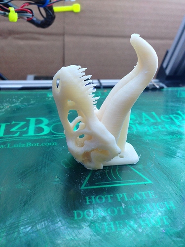

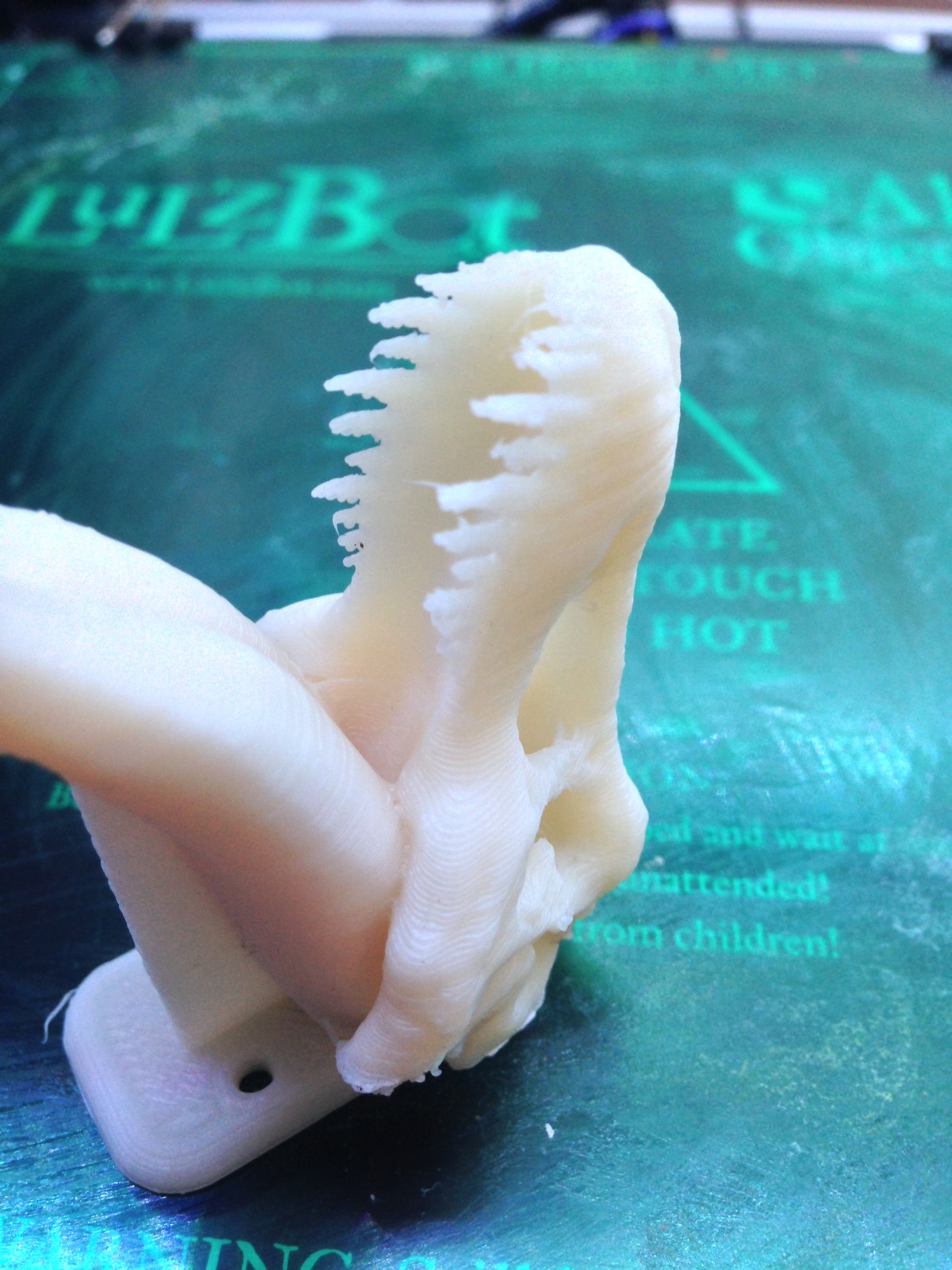

**Post date:** [January 23, 2015, 8:40pm UTC](https://forum.lulzbot.com/t/theycallmejohns-ao-101-prints/492/9 "2015-01-23T20:40:36Z")
I am looking for some more tips to improve my prints. Disappointed with how some of the overhangs came out. I ran at 230. Lulzbot natural abs. I think it should have been able to handle the short gaps. The teeth came out surprisingly well though.
> **[T-REX Remix Bathroom Set by Solstie](https://www.thingiverse.com/thing:325294)**
> Remixed from MakerBot Academy's T-REX skull. Have the King of the Dinosaurs watch and hold your toothbrush, soap and toilet paper.
> UPDATE: Added Tongue Towel Hook (prints without supports)
```nohighlight
; generated by Slic3r 1.0.0RC2 on 2015-01-22 at 22:42:49
; layer_height = 0.25
; perimeters = 2
; top_solid_layers = 3
; bottom_solid_layers = 3
; fill_density = .75
; perimeter_speed = 60
; infill_speed = 105
; travel_speed = 130
; nozzle_diameter = 0.35
; filament_diameter = 2.8
; extrusion_multiplier = 1
; perimeters extrusion width = 0.35mm
; infill extrusion width = 0.39mm
; solid infill extrusion width = 0.39mm
; top infill extrusion width = 0.39mm
; first layer extrusion width = 0.38mm
 ![Dino 1.JPG](https://us1.discourse-cdn.com/flex020/uploads/lulzbot/original/2X/6/65ec1395382878cc470cb59cb13365d74875c06e.jpeg)
 ![Dino 2.JPG](https://us1.discourse-cdn.com/flex020/uploads/lulzbot/original/2X/c/c2b7daeb7e8c67ae633cb4cd037fea64a23d46cc.jpeg)
 ![Dino 3.JPG](https://us1.discourse-cdn.com/flex020/uploads/lulzbot/original/2X/5/5c2c8aabb65b6dd394f010162bd71718705d3b14.jpeg)
 ![Dino 4.JPG](https://us1.discourse-cdn.com/flex020/uploads/lulzbot/original/2X/1/135712ec2b11d6abddfde3c4b09a53d11cfd156a.jpeg)

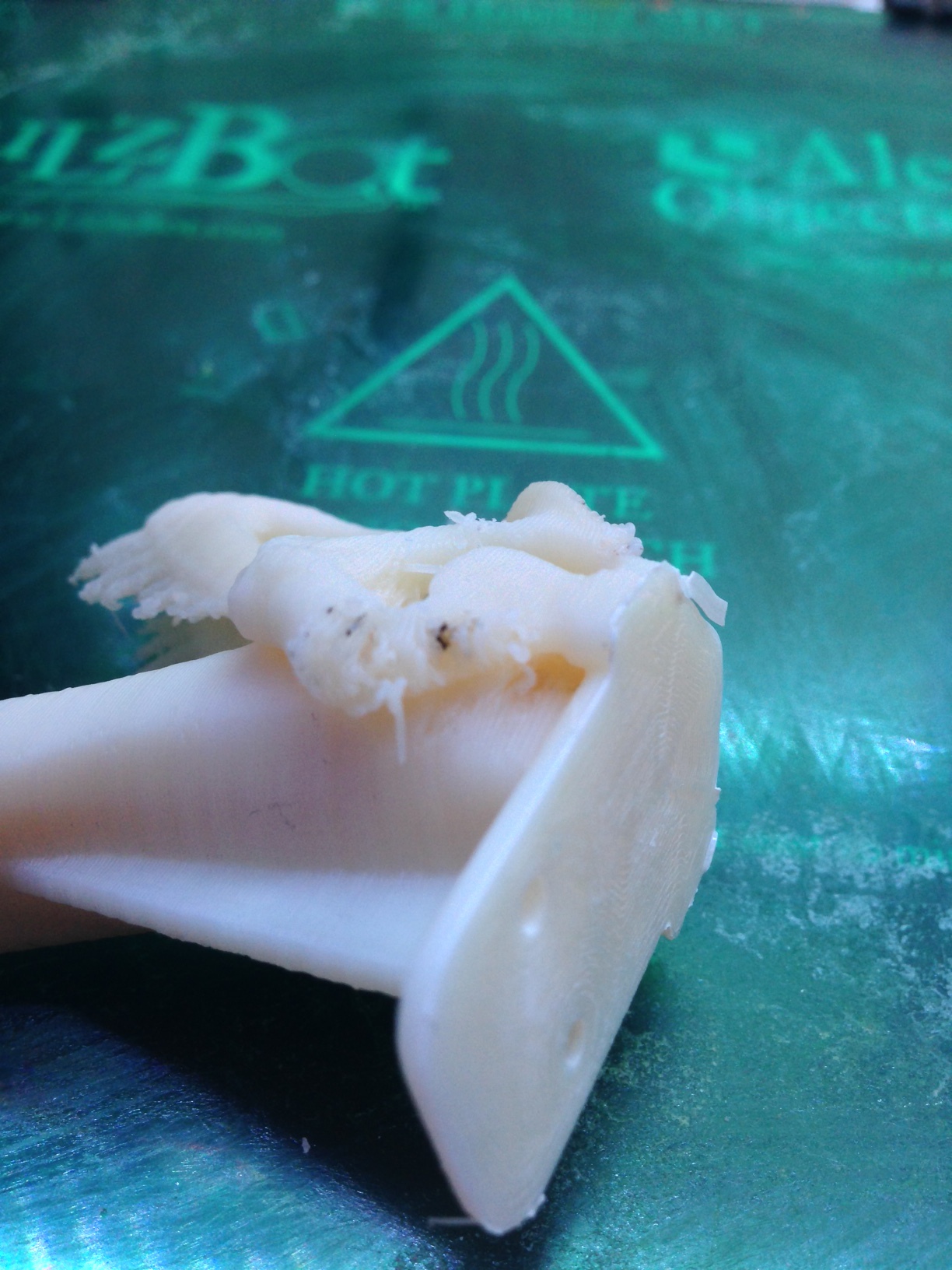

**Post date:** [January 23, 2015, 11:34pm UTC](https://forum.lulzbot.com/t/theycallmejohns-ao-101-prints/492/10 "2015-01-23T23:34:53Z")
Thats really not a bad result at all given how small some of those things are. Aside from a major rebuild to the Ballscrew thingy and whatnot, you could look at installing a small cooling fan on the second extruder header to give you the option of using active cooling with very small parts and bridging. Thats the one time you actually do want to use a fan with ABS, and even then it takes some tuning to make it more of a help than a hinderance. You still have a little Z wobble, but you are probably looking at either rebuilding some things, or replacing a threaded rod to get rid of that. Switching over to the thin threaded rod found on the Taz 2/3 might do the trick. You may also want to replace the bearings as they just might be warn enough at this point to allow a bit more movement there than you want depending on how heavily your AO-101 was used before you got it.
Even without the fan, enable the “auto cooling” checkbox in your Slic3r profile if you haven’t already. It’s not checked by default.
Another thing you could do to get a bit better results on the finer details, would be to swap out for a 0.35mm nozzle. The Budaschozzle 2.0 with a .35mm nozzle prints much better than the 1.1 5.0mm nozzle I had on my AO-10x initiallyActually even the 2.0 5.0mm nozzle is a major improvement. if you have one of the older style nozzles with the copper heat sync thingy, you may want to swithch to something else if you are able.

**Post date:** [January 25, 2015, 9:58am UTC](https://forum.lulzbot.com/t/theycallmejohns-ao-101-prints/492/12 "2015-01-25T09:58:54Z")
My cooling threshhold settings are 60, 20, 45. The 10 number you have where mine is at 45 for minimum speed will probably make for better quality but slower small areas. Swapping the minimum layer time to 20 instead of 15 will increase the size of the layer that cooling mode kicks in for. The fan speed settings are about the same on mine, but the AO-10x also doesn’t actually have a fan on it at this point so I’ve got no reccommendation on that yet.
I’d look up some of the printer torture test models on thingiverse and just start messing with the ones dealing with ooze and small parts until you get parts that you like with varying the extrusion rate and temperature a bit. You might get better results on those teeth with retraction ramped up slightly. Some of the excess flash could be filliament moisture related too I suppose. maybe try storing the filliament in a plastic box with a few moisture dessicant packs inside?

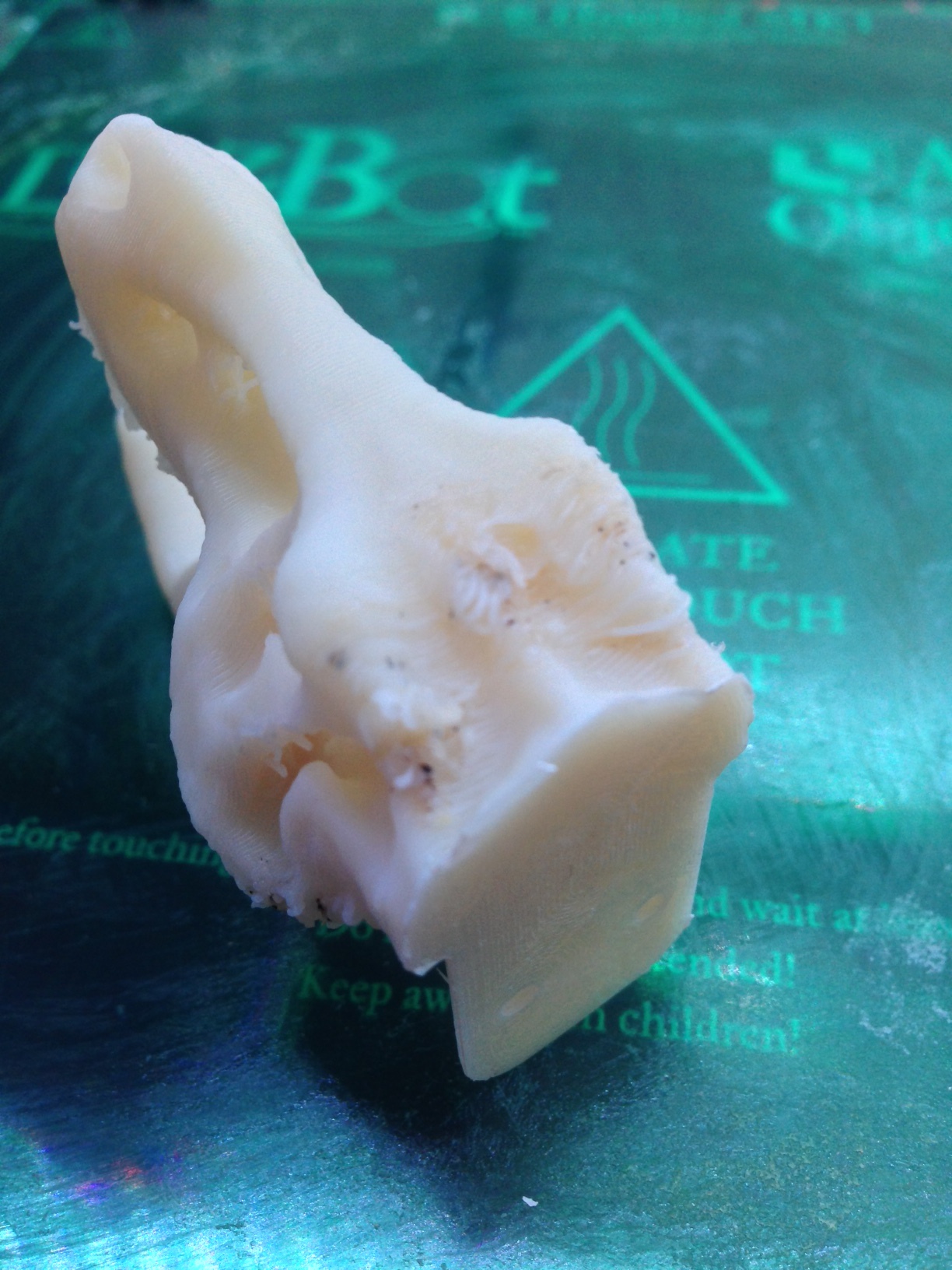

**Post date:** [January 25, 2015, 5:01pm UTC](https://forum.lulzbot.com/t/theycallmejohns-ao-101-prints/492/13 "2015-01-25T17:01:37Z")
While I could see that while it was printing, part of the print (not the the brim) were curling up, getting overheated and browning.

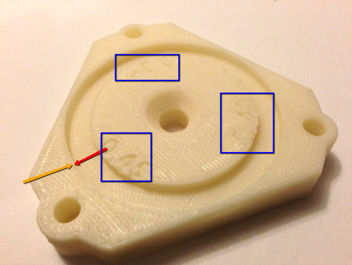

**Post date:** [January 29, 2015, 6:26pm UTC](https://forum.lulzbot.com/t/theycallmejohns-ao-101-prints/492/14 "2015-01-29T18:26:16Z")
Anyone know how to keep from getting separation between the perimeter and main part of the top layer. I think I have 2"solid layers at the top.
Also any tips on improving the quality of inset text?
 ![2015-01-29_1021.jpg](https://us1.discourse-cdn.com/flex020/uploads/lulzbot/original/2X/a/a67382f2905b154e05adec9d4542f48b8f8076f6.jpeg)
**Post date:** [January 29, 2015, 9:39pm UTC](https://forum.lulzbot.com/t/theycallmejohns-ao-101-prints/492/15 "2015-01-29T21:39:07Z")
Without looking at the stl, try pulling the text back from the edge a little bit. May want to change the top surface layers to 3.

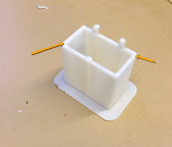

**Post date:** [February 2, 2015, 5:45pm UTC](https://forum.lulzbot.com/t/theycallmejohns-ao-101-prints/492/16 "2015-02-02T17:45:50Z")
Orias,
I will just eliminate the text. I am running some print with the increased layers and perimeters.
All,
Any tips for thin walled prints. Trying to print a thin walled voltage cover and it is coming out with the perimeters totally separated from the infill and no solid layer on top. It was supposed to be 3 perimeters and 3 solid layers. (See yellow arrow in first pic)
 ![2015-02-02_0927.png](https://us1.discourse-cdn.com/flex020/uploads/lulzbot/original/2X/0/03b9c66bd82852870f7b48b55ebf67c9dcb4b6eb.png)
Also it added a strange grove near the rib that was not in the model. I am attaching photos and gcode.
