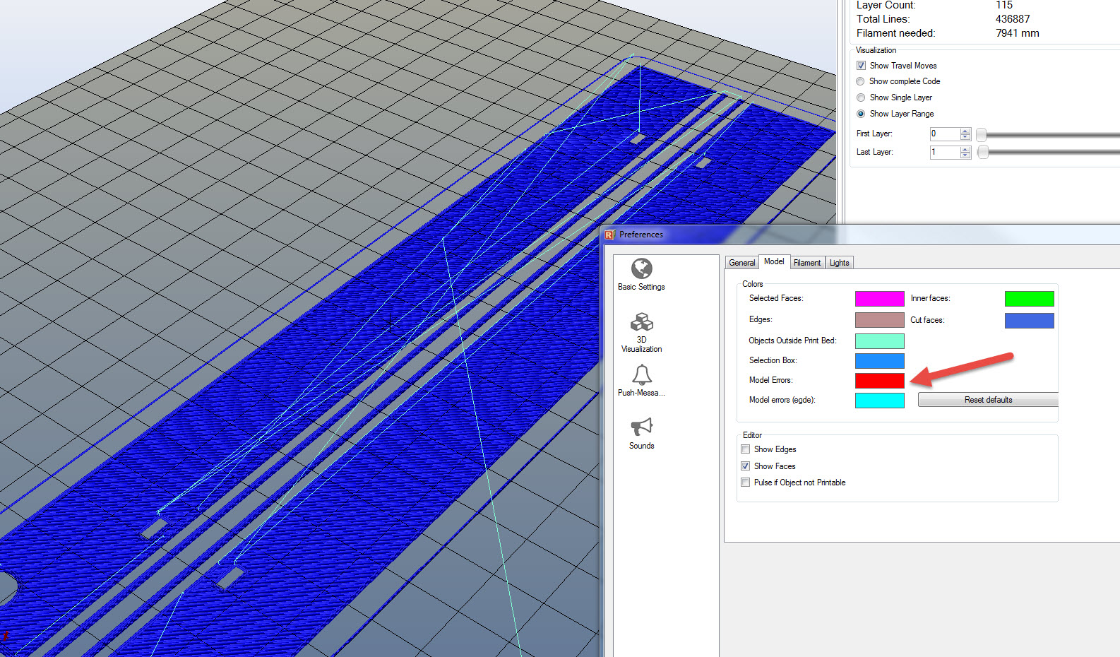

OK, looking around in RH, I found this, but I’m not sure which red issue I’m looking at, but if I load up the gcode file in RH I don’t see the red, so I’ll assume that it’s not a model issue.

So, that red is RH’s way of showing you what filament was just printed and hot. It will slowly fade and follows the nozzle. It is just eye candy and doesn’t tell you much.
It looks like the first layer is going very thin - is that the issue you are having?

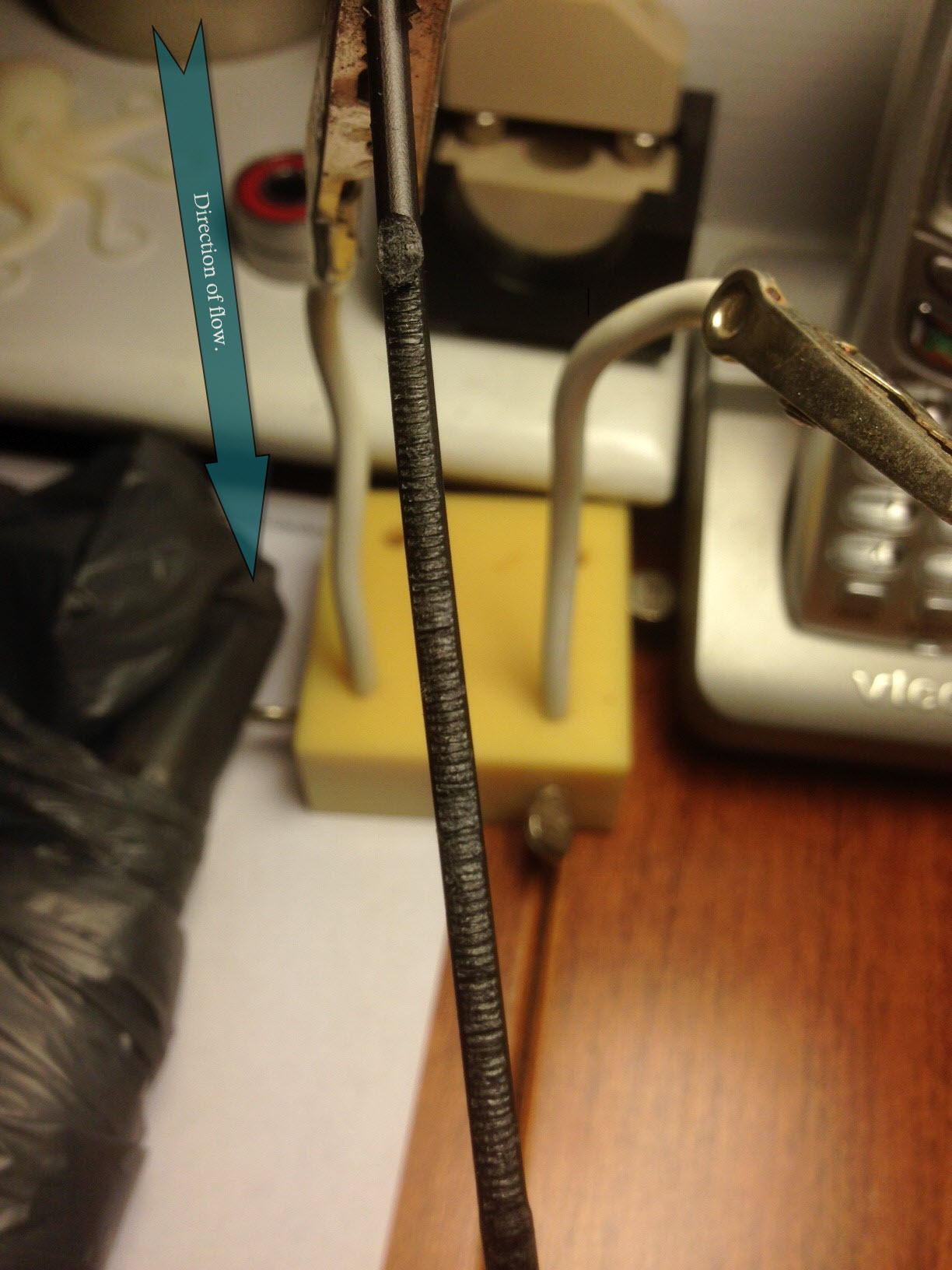

OK, so I pulled the filament out and this is what I found. Other than the obvious stop at the top, does this give you any indication as to what 's going on.
I’ll start a new print right now and report back.
 ![IMG_0893.JPG](https://us1.discourse-cdn.com/flex020/uploads/lulzbot/original/2X/e/ece211da8eb751ff42f49baa2531099651124328.jpeg)
**Author:** ![mhackney](https://sea2.discourse-cdn.com/flex020/user_avatar/forum.lulzbot.com/mhackney/32/46_2.png) [@mhackney](https://forum.lulzbot.com/u/mhackney)\
**Post date:** [March 16, 2015, 12:25am UTC](https://forum.lulzbot.com/t/trouble-all-of-a-sudden/1464/13 "2015-03-16T00:25:20Z")
Where you able to push by hand to get it to flow?
What I see is a divot where the cog ate into the filament. This happens when the filament advance is halted. I also see a lot of damage to the filament, perhaps the ridges are snagging on the inside of the hot end or the hot end mount.
