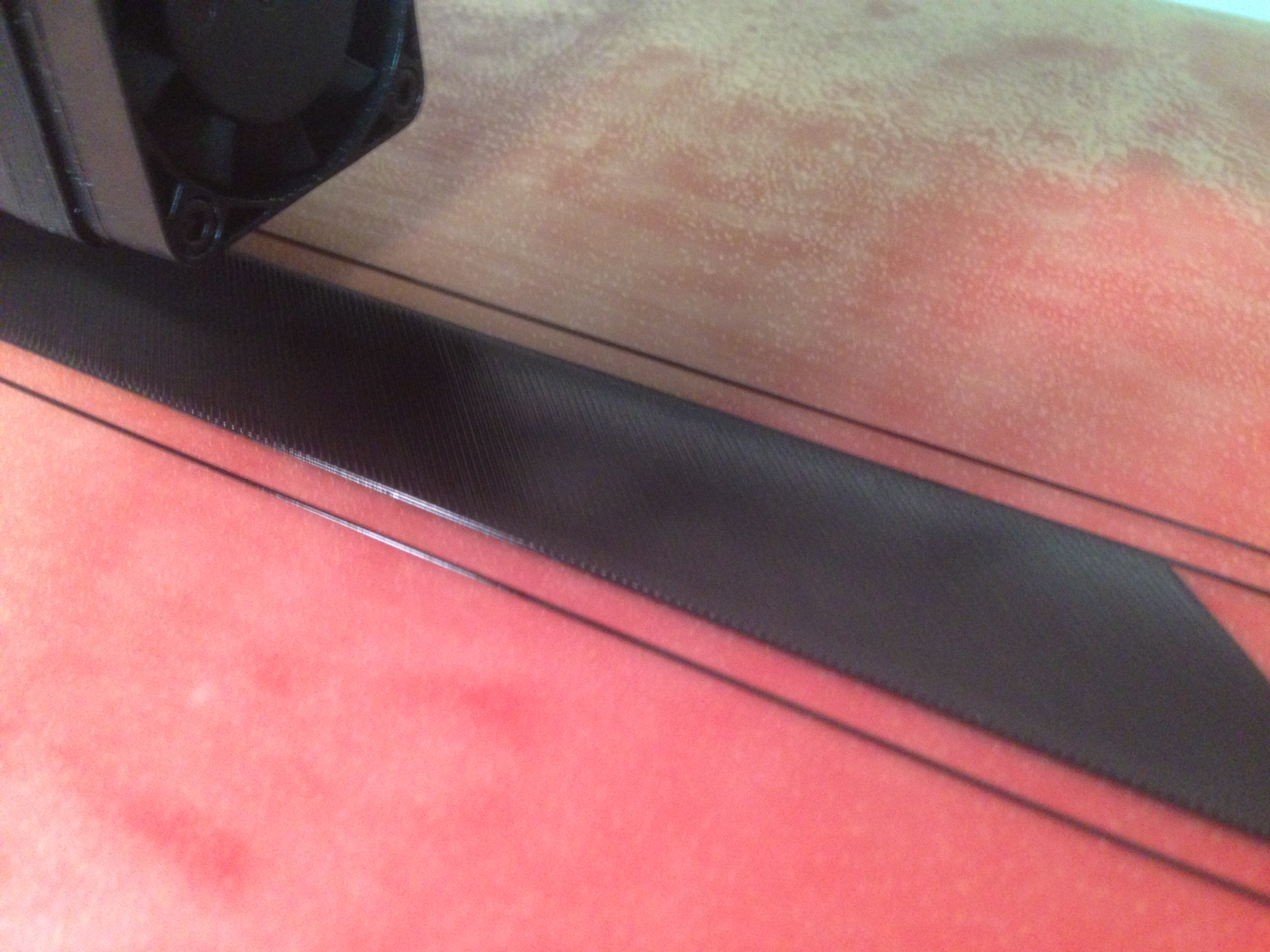

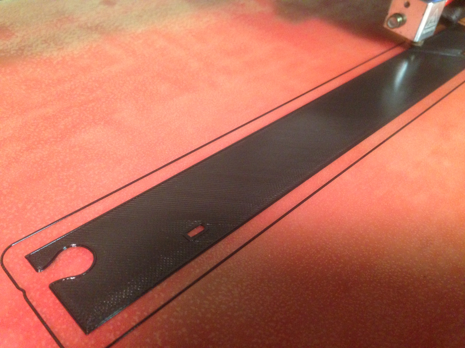

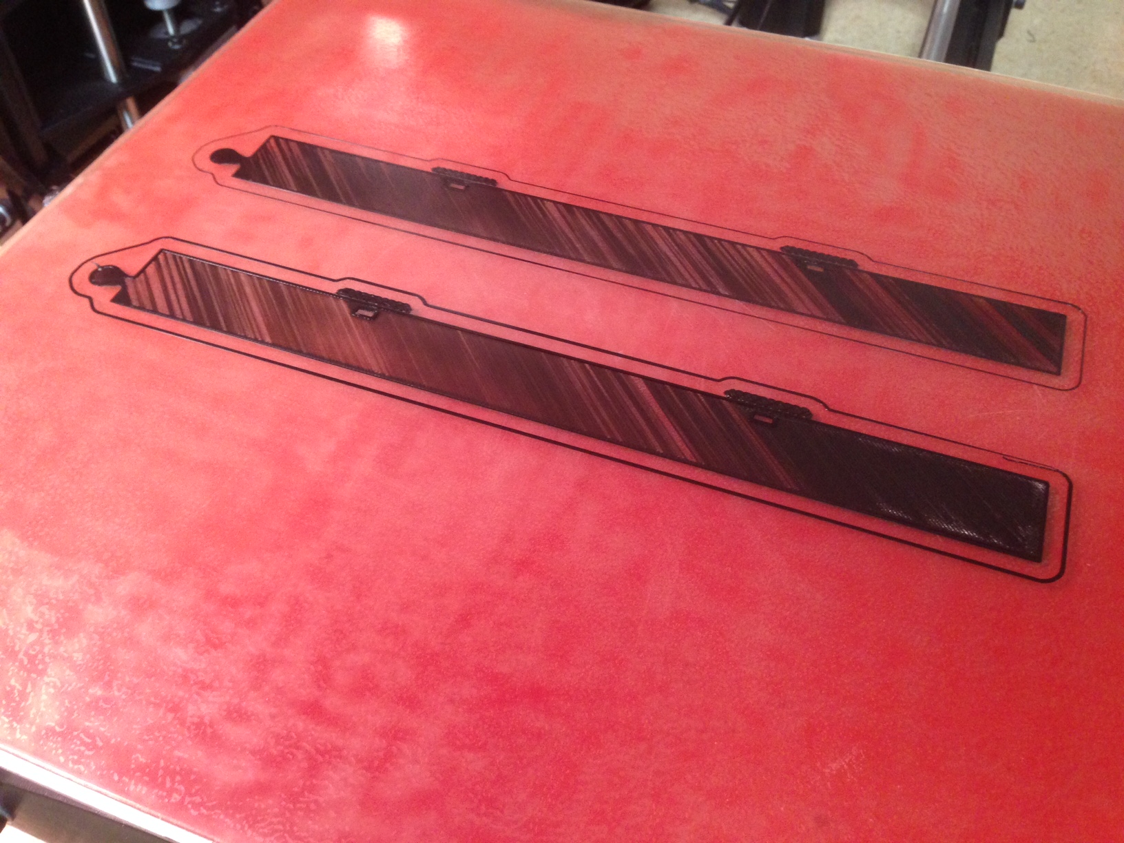

OK, tried another today with the 1.5 Prime/Suck, but same result. 👿
So, I started thinking; what could this possibly be?
I took the entire extruder apart, and found problem #1; the hobbed bolt groves were completely clogged with filament. When I first got the TAZ I started to print with an extruder temp of 185, which I was told was too low, but I had already cut into the filament many times, so that must have filled the groves in the hobbed bolt.
I cleaned those out with an X-acto knife and put it all back together again.
Because I removed the extruder I needed to recheck the bed level, that’s when I found problem #2; the bed is bowed up (like a turtle shell) in the middle. Not really sure what I can do about this except home to the middle of the plate and let the edges fall off slightly.
Any other thoughts?
Thanks.
**Author:** ![mhackney](https://sea2.discourse-cdn.com/flex020/user_avatar/forum.lulzbot.com/mhackney/32/46_2.png) [@mhackney](https://forum.lulzbot.com/u/mhackney)\
**Post date:** [March 16, 2015, 6:07pm UTC](https://forum.lulzbot.com/t/trouble-all-of-a-sudden/1464/23 "2015-03-16T18:07:24Z")
Ok, that’s progress!
On the bed - can you remove it from the printer and use a good straightedge check to see if it is flat? It might be that putting it in the corner clamps is pushing the corners in and bowing the center. How much bow is in it?
**Author:** ![Muggs](https://sea2.discourse-cdn.com/flex020/user_avatar/forum.lulzbot.com/muggs/32/9237_2.png) [@Muggs](https://forum.lulzbot.com/u/Muggs)\
**Post date:** [March 16, 2015, 6:22pm UTC](https://forum.lulzbot.com/t/trouble-all-of-a-sudden/1464/24 "2015-03-16T18:22:06Z")
Absolutely PERFECT first layer. See previous post.
Very happy again.
Thank you Mike and Baltimorebully.
Mike, this is with 1.5 Prime/Suck settings, any reason to change that? . Stupid question I know based on what I’m looking at right now.

Mike, I posted before I saw your reply.
I would guess about 0.005 - 0.007" (that’s in inches. LOL)
**Post date:** [March 16, 2015, 6:44pm UTC](https://forum.lulzbot.com/t/trouble-all-of-a-sudden/1464/26 "2015-03-16T18:44:57Z")
No need to change the suck/prime (as you know!)
So that’s quite a bit of variation \> .1mm. Is that with the plate removed form the machine, or clamped in?

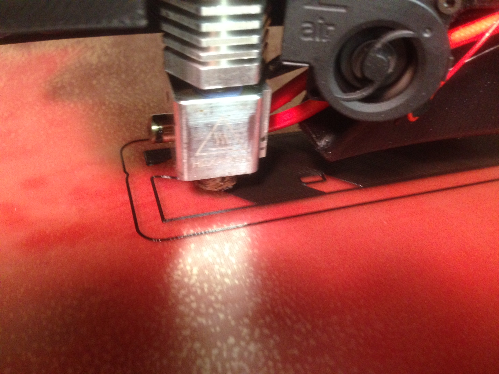

OK,
This is getting really frustrating!
 ![IMG_0911.JPG](https://us1.discourse-cdn.com/flex020/uploads/lulzbot/original/2X/b/b61555beaa5d0c37e859caa238cfb62be508df72.jpeg)
I either can’t get a good first layer or if I do get a good first layer my print will fail mid-print!
I’m really frustrated and don’t know what to do. I’m going to try ABS and see if I have any better luck with that. I know I should stick with one material until I “master” it but I need to try something different.
**Post date:** [March 23, 2015, 8:39pm UTC](https://forum.lulzbot.com/t/trouble-all-of-a-sudden/1464/37 "2015-03-23T20:39:53Z")
That looks like under extrusion to me… maybe the hotend temps are too low or you’ve got a clogged nozzle.
You should definitely nail the first layer, but does the second layer look the same (wispy and sparse)?
**Post date:** [March 23, 2015, 10:27pm UTC](https://forum.lulzbot.com/t/trouble-all-of-a-sudden/1464/38 "2015-03-23T22:27:45Z")
kc,
Thanks. I have backed away from the ledge and cleaned out the hobbed bolt and have been running another (different) print, again in PLA, and that is running fine; about to finish.
Why do you think this happens so often on the part pictured? Is it because it’s a long thin part with a lot on area to cover with the first three solid layers? I think I’ll clean out the hobbed bolt each time I start a build.
**Post date:** [March 23, 2015, 11:22pm UTC](https://forum.lulzbot.com/t/trouble-all-of-a-sudden/1464/39 "2015-03-23T23:22:54Z")
The part looks fine… the printer should have no problem with it. My guess would be something in software and most likely not mechanical.
What is your first layer height? Actually do you have a config (style) file I can load… maybe that’s easier.
Lastly, try a recommended slicer from Lulzbot with their pre-configured profiles. I would suggest Cura over Slic3r. If you continue to have issues, their support line might be able to help you.
**Post date:** [March 24, 2015, 3:02am UTC](https://forum.lulzbot.com/t/trouble-all-of-a-sudden/1464/40 "2015-03-24T03:02:26Z")
You may want to make your first layer a lot fatter, we generally do that with defaults. If you are doing really fine layers, you can make the first one thicker.
