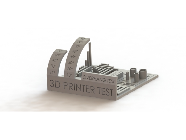

Prints has been bad since day 1 using the new Cura 2.6. See attached picture. My prints came out perfectly using the old Cura 21 version. I know there’s no such thing as “perfect” in 3D printing, but it came out waaaay better that Cura 2.6. I tried tweaking different settings one at a time. It fixed some, then another problem shows up. The only improvement i can see now is the bridging. See for yourself what Cura 2.6 do to an otherwise perfect Cura 21 prints.
Test print i used:
> **[All In One 3D Printer test by majda107](https://www.thingiverse.com/thing:2656594)**
> UPDATE \[15/8/2020\]
> Since this model got way more popular than i eventually thought, I'd love to spread more help and tinkering across this community.
> If you want to participate, feel free to follow me on twitter or join my discord server, if you...
My cura 2.6 profile:
[https://drive.google.com/drive/folders/1iY6jZSVDAlyxHDLO0geFcnwudnf\_E3yT?usp=sharing](https://drive.google.com/drive/folders/1iY6jZSVDAlyxHDLO0geFcnwudnf_E3yT?usp=sharing)
Any help/solution/advise are appreciated.

We are sorry to hear about the issues, and thanks for posting the profile! One item I notice in what you posted, is you have an extra prime upon retractions:
retraction\_extra\_prime\_amount = 0.93
This setting is essentially having you extrude an extra 0.93mm of filament into the tool head after each retraction move, and could explain the blobs you are seeing after those travel moves.
It also looks like you have based your profile modifications on our High Speed Verbatim PLA profile, which will be designed to print faster but not giving as crisp of results. Can you post a picture of the print using a standard or high quality profile PLA profile?
