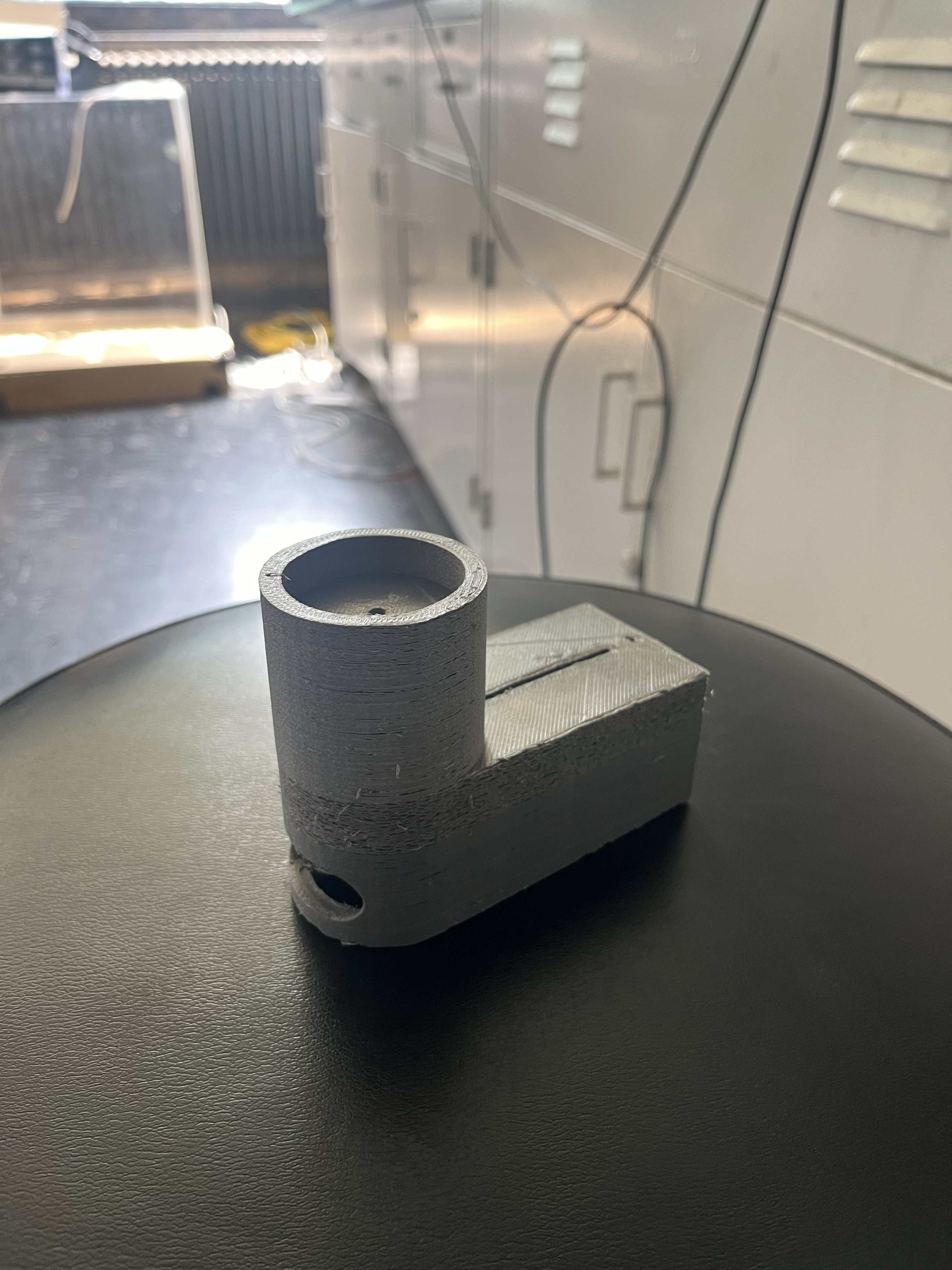

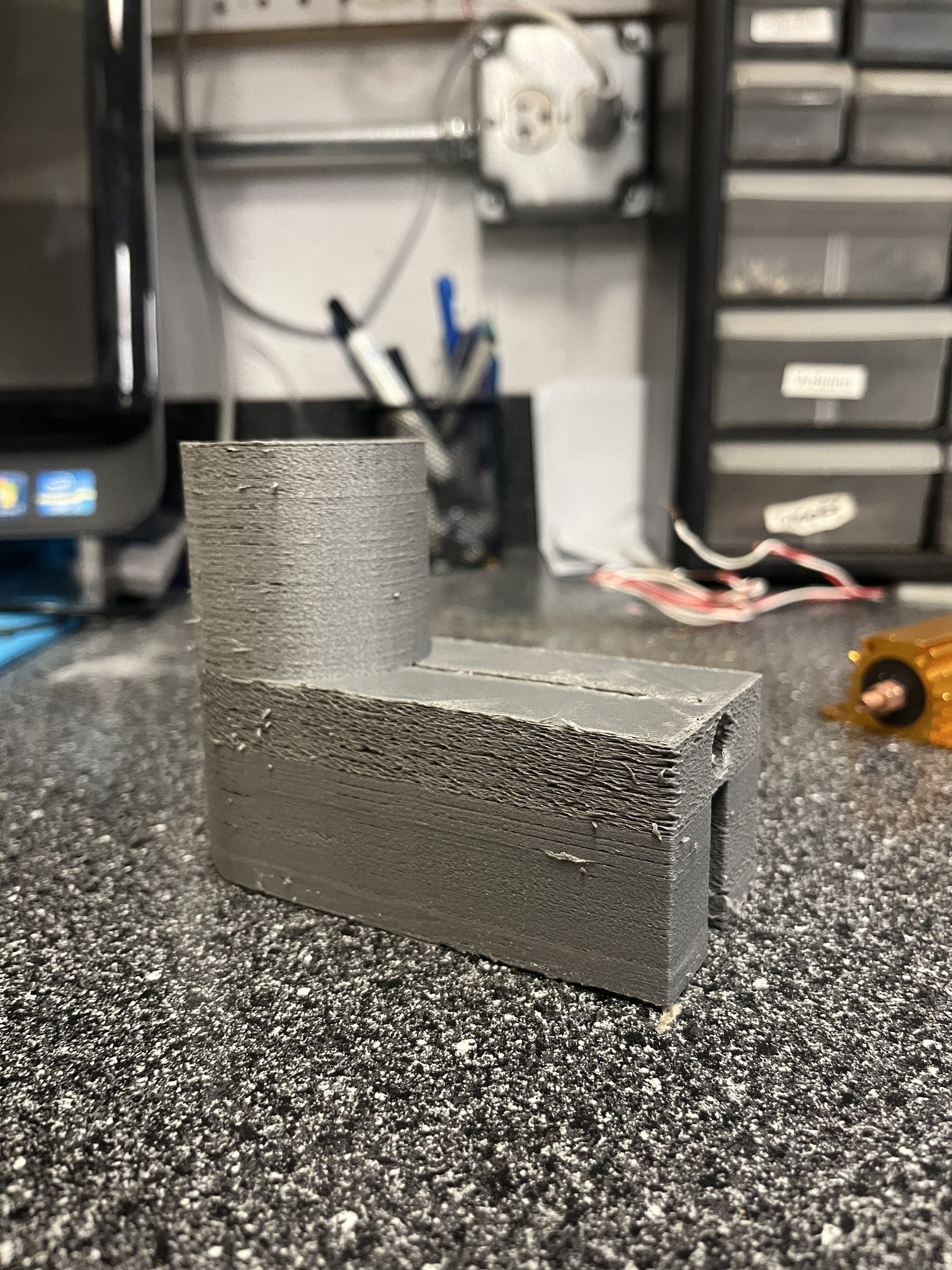

I am currently using a Mini 2, and it has been printing well. However, starting yesterday, the print quality has deteriorated. As shown in the uploaded photo, the printed surface of the model is rough, and the layer density varies.

Please let me know what could be causing the uneven layers and rough surface.

**Post date:** [August 3, 2024, 2:04am UTC](https://forum.lulzbot.com/t/uneven-layer-and-rough-surface/26868/6 "2024-08-03T02:04:12Z")
It looks like it was dried and then printed but not printed from a dryer. So the first bunch of layers are fine since that was the exposed surface in the dryer but after that passed it started the typical nylon hissing and spitting. Not a fan of nylons, they need a covered dry path from a dryer to extruder with a bowden tube. Or they behave badly.
**Post date:** [August 4, 2024, 10:36pm UTC](https://forum.lulzbot.com/t/uneven-layer-and-rough-surface/26868/7 "2024-08-04T22:36:45Z")
It looks wet.
What drybox are you printing from?
How did you dry it before putting it in the drybox?
If you aren’t printing from a drybox, the filament is wet. Nylon is _aggressively_ hygroscopic. If it is just out in your room during print, it’s wet. If you didn’t dry it beforehand, and it’s fresh from teh box, it’s suspect on dryness.
If you’re printing from a drybox with desiccant, and ran the filament in a dryer for 8-12 hours before putting it in there, you can consider it dry.
