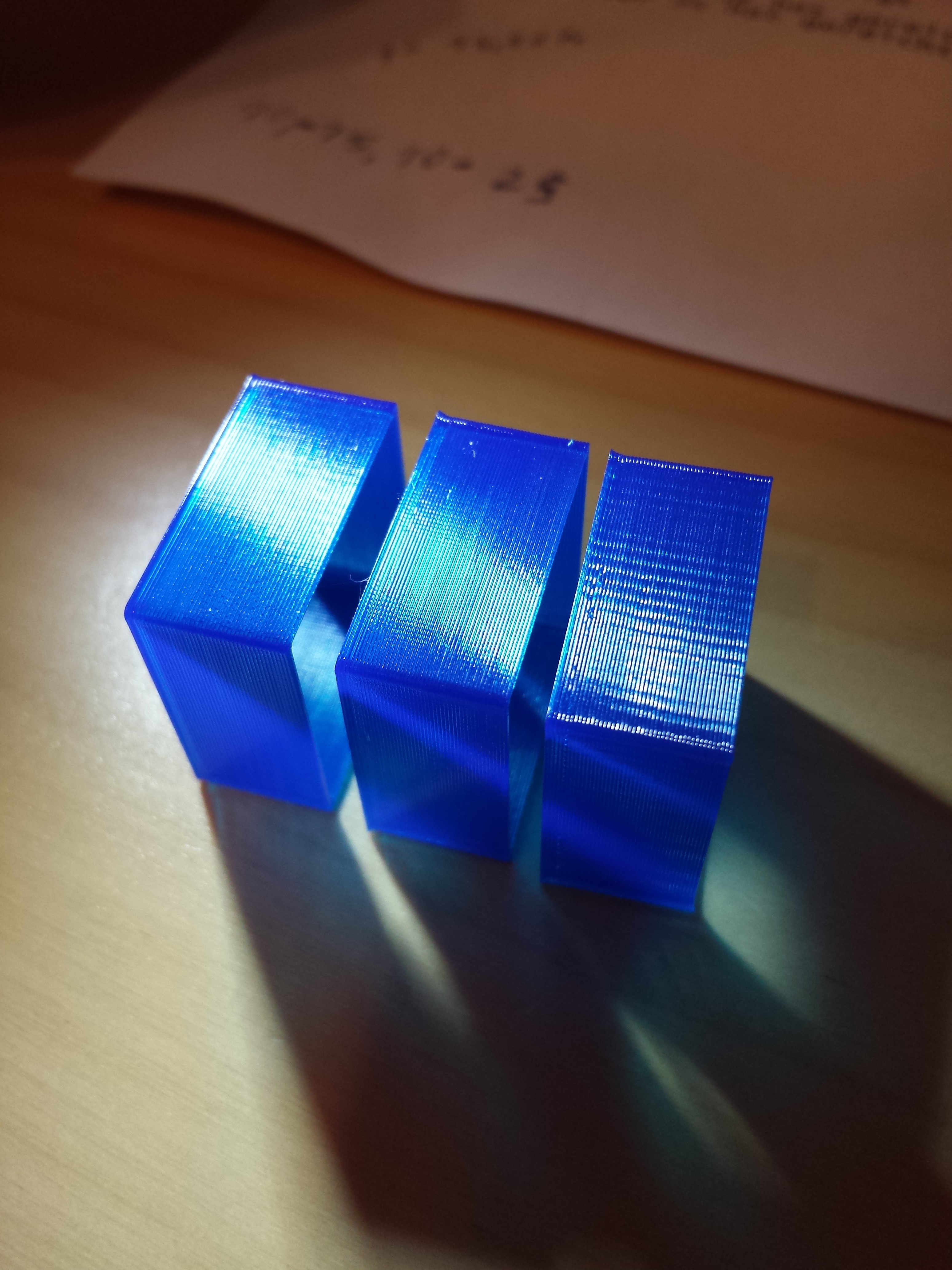

Hello together,
I just receaved my new TAZ 5 and now I’m trying to calibrate it 🙂
I had a quick look at Cura and printed a hollow test cube for wall thickness test, but then I switched over to Slic3r because I feel more comfortable with it. The first cube with Slic3r had a wavy structure on the walls (all 4 sides equal). I compared parameters between Cura and Slic3r, now I know it’s the print speed.
See the picture attached, from left to right you can see following print speeds:
1. 10mm/s
2. first half of cube 15mm/s, then 10mm/s
3. 25mm/s
The first two cubes on the left are nice smooth, but the right one is “wavy”. You can see it best in the middle of the side wall.
Printing at 15mm/s maximum on outer perimeter sounds quite slow to me, what can be done do get higher print speeds? I was not able to track this error with guides found with google… Maybe bearings? I noticed that the original bushes has a “lot” of visible play to the rods?
 ![20151010_203802.jpg](https://us1.discourse-cdn.com/flex020/uploads/lulzbot/original/2X/f/f3f5ca496ea7a306cf81e96ec488a8eb12e25bd4.jpeg)

It is the loose fitting IGUS bearing that is causing the ripple. I have been fighting it on a new Taz 5 myself. In fact, I have the same problem on an old Taz 2. I have replaced the rails and bearing with hardened rails and metal bearings on the Taz 2. That cured the ripples but led to a strange texture on the surface of the parts. I had to go back to the plastic bearings to eliminate the texture.
No amount of bearing preload or adjustment has really helped on my machines. It really hampers the part quality on the Taz. My Mini doesn’t seem to suffer the same problem. The bearings are not sloppy on that one, for some reason.
You can reduce the ripple by loosening the bearing holders on the bed and X carriage and lightly spreading them away or towards each other and re-tightening the bearing holders to add a little pre-load and reduce the wiggle.
Let me know if you come up with a solution. At this point, I am looking at piercet’s axis upgrades to get rid of this problem.

I did some research, I think we can’t blame the igus bushes for all the play in the axis…
First, the bushes are designed to be press-fitted into a H7 bore with a force of 700N (70kg). I guess, our printed bearing holders can’t achieve that 😉 So the inner diameter will be bigger than expected.
Second, our rods seems to be not that precise. My ones are 9,97mm diameter, which equals 10h9 so there is room the get better here. igus recomends h6-h10.
A qick and easy replacment should be to replace the rods with 10h6 ones and change the bearings to RJUM-01-10. Same bearing type, but with metal casing so the press fit isn’t needed for tolerance to rod. Maybe even RJUM-11 with reduced tolerances…
But I think it should be OK with good LM10UU linear bearing. I head a look at our 3D printer at work (German RepRap X400). It has 12mm rods with LM12UU bearings. Absolut no feelable play, runs smooth and no problems with surface ripple. OK, you can get 4 TAZ 5 for one X400, so I’m not surprised 😆 I will try to find out which manufacturer they use…
