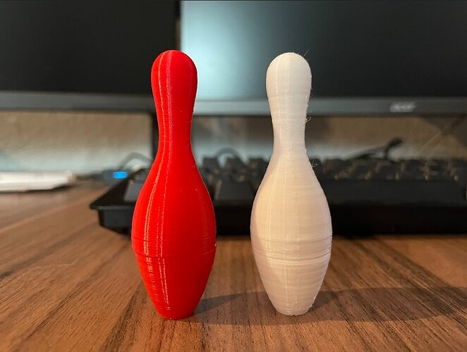

I had a perfectly happy printer, and then I started fiddling with it, and messed everything up.
Does anyone know why I’m getting these really bad misaligned layers? And how to fix it?
In the future is there a good guide for calibrating a Taz 6?

Though to tell from the pictures, but if it’s just on the one axis that the shifting is occurring, first thing I’d check is belt tension. Past that, steppers, and then stepper drivers.

Yeah, definitely looks like something is sticking on one of the axis

I doubt it’s the stepper motors themselves. I think steppers tend to be really reliable and when they fail they fail in a more obvious way. I’m not an expert, though, so take that with a grain of salt. I still think belt tension may be the issue or something being loose elsewhere on the printer. You could try using a belt tension/musical instrument tuner app to check that the belts are vibrating at the proper frequency (indicating that they are properly tensioned). Other than that, it’s possible that the toolhead is loose/not seated properly, the bed is loose somehow, the hotend is loose in the toolhead, the IGUS bushings on the rods are loose, the Z axis is loose…basically grad all the different parts of the print and try to wiggle them (somewhat gently) and see if there is ANY play. I blew a bunch of money on linear rails for my X and Y axes because the bushings were worn and I didn’t want to fiddle with them ever again.

How’s your filament path? A binding filament coming off the role can cause something like this too. Can you upload a picture of your setup. Or a video of it printing? Which print head are you using?

Thanks for the replies. I moved the filament spool from the side of the machine to above. So straight path now. I also tightened the belts as well as I could. They seemed to have a decent amount of tension beforehand, but slightly more now. I did these at once, so I don’t have separate test pieces to confirm what specifically was the problem. But I am seeing a noticeable improvement.
I also noticed the the e-steps didn’t match whats listed on the print head, so switched them from 830 to 825, but that didn’t make a difference on a re-print.
With that said, I wouldn’t say it’s perfect now. While the layers no long seem misaligned, there are still noticeable irregularities with some of the layers. At the same place as previous print. But it’s not always at the same layer height from file to file. Seems issue is related to total traveling distance of the bed or print head. So larger models have more messed up layers. I think. Is there any further steps I can take to try and dial this in?
Left is before, Right is after.
 ![](https://us1.discourse-cdn.com/flex020/uploads/lulzbot/original/2X/8/8787680da7ed334a2f839d59e0118bc33859cceb.jpeg)
 ![](https://us1.discourse-cdn.com/flex020/uploads/lulzbot/original/2X/2/28da589ad799554ec8e9eeea96b6e47594b2e055.jpeg)
If it matters, I am using the Taz6 single extruder head, I believe v2.1 (or one that looks similarly, no markings). I didn’t notice any part that seemed loose when I fiddled with it.
