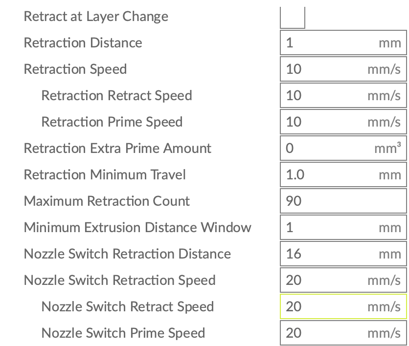

Can someone tell me what Cura setting(s) controls how to make the extruder finish these lines. Thank you.

My apologies for the delay our company has been dealing with alot in the new world climate.
Material Type - nGEN colorfabb
Extrusion Temp - 220
Bed Temp - 65
Printing Speed - 60mm/s

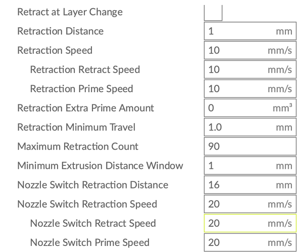

Retraction Amount - Image attached
Z-offset -1.200
E-steps 833.0
I have no clue how to calibrate my E-steps

**Speed**
Whenever you are having quality issues … it’s a good idea to slow down the print speed and see if that helps. I might drop to 35mm/sec and see how that works.
Your retraction distance setting looks fine. Direct-driver printers can get away with low retraction values (e.g. 1mm). The default profile has it set to 3mm … which may be a bit high. Most of my retraction settings tend to be in the 1mm to 2mm range. 3mm is usually not harmful … just unnecessary. If you change the retraction distance then also change the Minimum Extrusion Distance Window to the same value.
I get nervous when I see Maximum Retraction Count set to 90. Here’s how this works…
You’ve got Retraction Distance set to 1mm. So each time a retraction occurs, it will pull the cold filament back by 1mm. But when you run filament through the hobbed gear in the extruder, it puts some bite marks into the side. When you retract, it puts more bite marks into the side. If you retract and re-prime over and over again over the same 1mm of filament, it will really chew up that filament. It can chew it up too much and result in a jam.
You’ve also got something called the Minimum Extrusion Distance Window. It is ALSO set to 1mm.
Then you’ve got the Maximum Retraction Count (set to 90).
What these three values mean, when put together (Retraction Distance, Retraction Count, and Minimum Extrusion Distance Window) is this:
The print job is allowed to retract and re-prime (by 1mm each time) up to 90 times over the SAME filament … any retractions beyond 90 (90 is already well-beyond ludicrous) will be IGNORED … UNTIL the print job has extruded more than the Minimum Extrusion Distance Window (in your case 1mm) and THEN it may resume doing retractions again.
These values are designed to let you avoid chewing up filament. I typically set my max retractions to a smaller value … usually not higher than 5 and never higher than 10. If I had a print job that needed to do that many retractions … I’d rather have the stringing.
