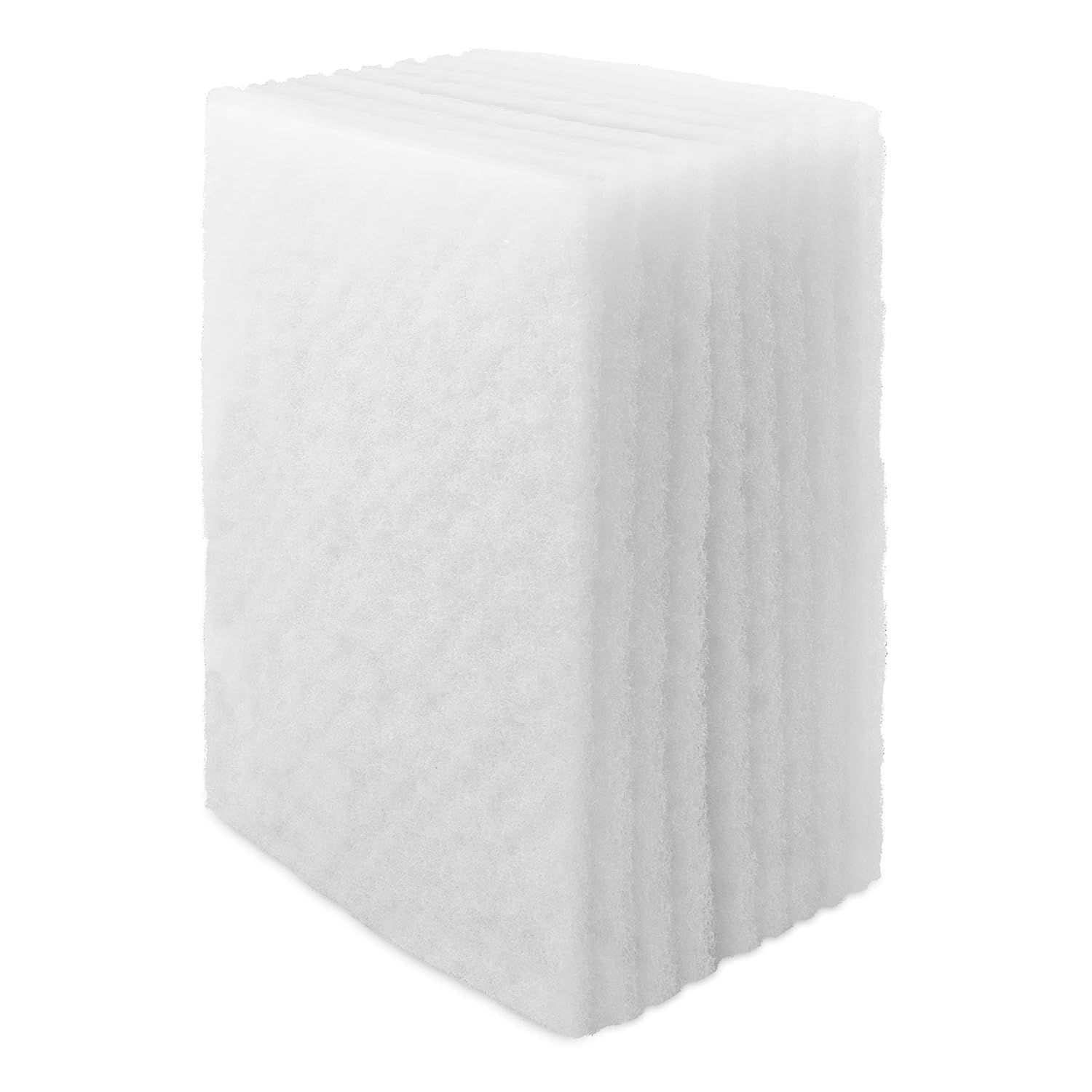

Revisiting wiper pad fuzz issues and after reading this old note:
> **[OHAI: Open Hardware Assembly Instructions](https://ohai.lulzbot.com/project/quiver-wiper-pad-intructions/)**
and looking at 3M Scotch-Brite Light Cleansing Pad Material: Aluminum/Aluminum Silicate…
and a ridiculous shipping rate:
 ![IMG_4381](https://us1.discourse-cdn.com/flex020/uploads/lulzbot/original/2X/f/f8c1159660833524cf55d0bf731da79ff7c9402a.jpeg)
There has to be a better wiper design/solution. Right?

Solution? BLTouch and stop wiping.
I just bought red scotch brite pads and cut to size when I was still wiping. If you’re using a hardened steel nozzle, the pads won’t hurt.

Google is giving you bad info. When I ordered pads it was $17 shipping, in 2023. The ones they use on the Taz Pro I think work better as they are folded into the holster and can do a bit better wiping the whole nozzle. These are equivalent.
> **[Peachtree Woodworking Supply 10 Pack of White Non Scratch Non-Woven Pads for...](https://www.amazon.com/Scratch-Non-Woven-Cleaning-Polishing-Workshop/dp/B00EY9ZB52)**
> Peachtree Woodworking Supply 10 Pack of White Non Scratch Non-Woven Pads for Cleaning/Polishing and Multi Purpose Use in Your Home •Workshop or DIY Garage Shop Made in The USA: Amazon.com: Tools & Home Improvement

Reporting back. This material works well and is an affordable solution. All I use now.
### Author: ![Wrathernaut](https://sea2.discourse-cdn.com/flex020/user_avatar/forum.lulzbot.com/wrathernaut/32/13542_2.png) [@Wrathernaut](https://forum.lulzbot.com/u/Wrathernaut)
#### Post date: [November 7, 2024, 8:22pm UTC](https://forum.lulzbot.com/t/wiper-pad-material/26864/13 "2024-11-07T20:22:32Z")
For clarification, which material exactly are you referring to?
### Author: ![mhristau](https://sea2.discourse-cdn.com/flex020/user_avatar/forum.lulzbot.com/mhristau/32/9696_2.png) [@mhristau](https://forum.lulzbot.com/u/mhristau)
#### Post date: [November 7, 2024, 8:55pm UTC](https://forum.lulzbot.com/t/wiper-pad-material/26864/14 "2024-11-07T20:55:45Z")
