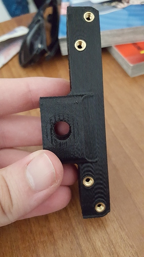

So this happened. My Y axis idler cracked.
 ![20160726_184146.jpg](https://us1.discourse-cdn.com/flex020/uploads/lulzbot/original/2X/4/4ce4cdd63ed1a3633d5771b7012d787786ae387a.jpeg)
I managed to print a replacement but when I started taking my printer apart I noticed these inserts…
 ![20160726_184152.jpg](https://us1.discourse-cdn.com/flex020/uploads/lulzbot/original/2X/2/2140606b4a94e36e641bee205e9fec51ed3797a5.jpeg)
What am I supposed to do, buy some inserts and a heat gun to melt them in? What type are they?
**Post date:** [July 26, 2016, 7:13pm UTC](https://forum.lulzbot.com/t/y-axis-idler-broken/3772/2 "2016-07-26T19:13:31Z")
They are heat-set inserts. Usually installed with an el-cheapo soldering iron, since you don’t want to get plastic on your nice iron. 🙂
You can probably use a hot iron to get them out and put them in the new printed part. About $5 at Harbor Freight if you have one nearby.
**Post date:** [July 26, 2016, 8:17pm UTC](https://forum.lulzbot.com/t/y-axis-idler-broken/3772/3 "2016-07-26T20:17:50Z")
Yep. Take those out with a cheap iron and install them in the new part.

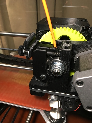

I’m going to check mine tonight. I just had my extruder idler arm break. It was odd to remove because the nut that is on the inside part of the idler arm started to spin in place as I tried to loosen the screw. I ultimately had to grab some pliers and break the remainder of the idler arm to free the screw & nut. Happily I have a TAZ 6 right next to the Mini so I was able to easily upgrade it with the new “beefier” idler arm and latch (from the Gladiola build.) My Mini is an Olive, I believe. The 8mm latch spring tension jig won’t obviously work on this new one:

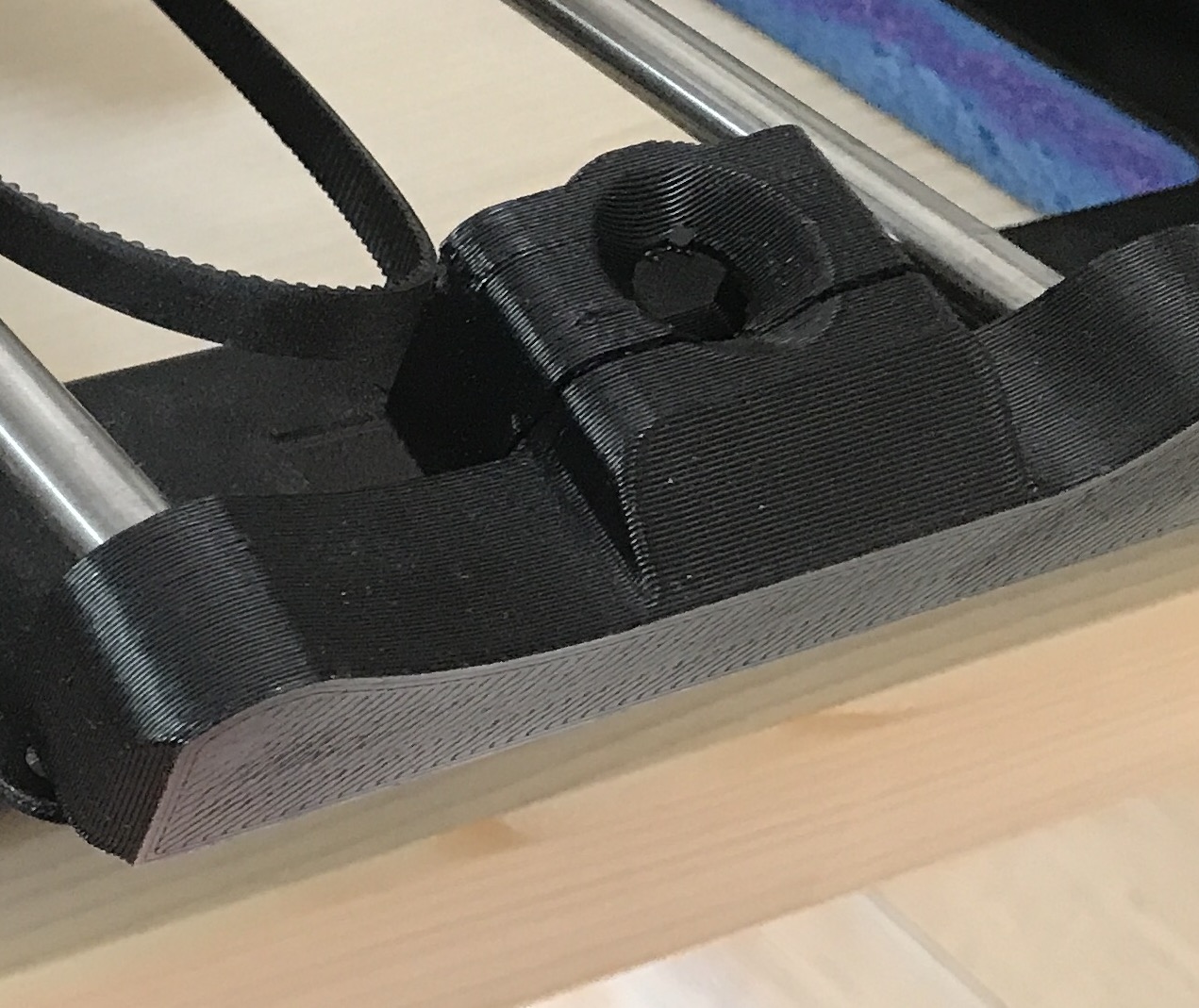

**Post date:** [July 11, 2017, 9:22am UTC](https://forum.lulzbot.com/t/y-axis-idler-broken/3772/17 "2017-07-11T09:22:54Z")
My Y axis idler broke yesterday splitting at the layers.
 ![idler.jpg](https://us1.discourse-cdn.com/flex020/uploads/lulzbot/original/2X/f/fe9d9b56ae73bc55f28d504a7c2e020f39c0b532.jpeg)
The vertical bolt and nut was tightened very hard, likely stressing the part to split, so probably a matter of time. I temporarily glued it with Loctite super glue.
Looks like these are the inserts: [https://www.lulzbot.com/store/parts/heat-set-insert-tapered-m3-05mm-internal-thread-38mm-l-x20](https://www.lulzbot.com/store/parts/heat-set-insert-tapered-m3-05mm-internal-thread-38mm-l-x20)
Is PETG ok for printing a new one?
Hey DougZ, if you need a beefy idler arm that will fit older model Mini screws, check here:
> **[Heavy Duty Extruder Idler and Latch for Lulzbot Mini by renarts](https://www.thingiverse.com/thing:1766022)**
> After my 3rd idler broke on my Lulzbot Mini, I decided to see if I could make a more heavy duty idler rig. I believe this will also fit the TAZ 5. I printed it with ColorFabb nGen, but I would recommend ABS or ColorFabb XT or HT, or any other strong...
