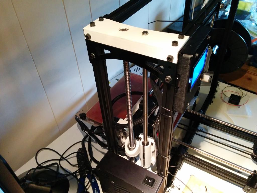

Well, just finished my upgrade.. Z axis is working fine and moves smoothly with zero backlash :) two degrees left on the bed to start my first print.. I'll update in a little bit :)
edit: first print came out OK! Here's a quick video: http://www.youtube.com/watch?v=G72Tx1H5gvs
I shot it with my phone and the microphone seems to have picked some weird resonance noises that I couldn't hear.. The noise of the printer is definitely very different. The linear bearings are indeed louder than the igus plastic bearings, but the steppers are much, much quieter. Overall, the printer is much quieter than it was. I can't hear it in the the next room, while before I could walk upstairs and still hear it.
The print quality improved quite a bit, but there are still some artifacts and ripples that I'm not too excited about. I didn't replace the Y axis IGUS bushings with linear bearings (wanted to save some $$ on the hardened rods) so there is still a lot of wiggle in the bed, but I was hoping that wouldn't be as noticeable. I'm tempted to replace the bushings with the bearings anyway, even knowing the stainless rods won't last very long, just to see if it makes any difference.

Wow that is the sickest, most badass machine on this forum! Those ball-screw rods and your X_End Plates are mean looking ! I feel like you have created a one-of TAZ that nobody else has! You should finish by printing the rest of your black parts in white any maybe design some custom corner brackets as well add some white LEDs (I have lots of bright sign grade LEDs I can share for free. They look like this http://image.dhgate.com/albu_509118405_ ... rproof.jpg)
Im still on holidays so I won't be able to do my mods until next week. Thanks for sharing!
Two question, why does your hardened rod stick out of the top a little? As well, did you find any clearance issues installing the vibration dampers on any of the axis's?

2con wrote:Two question, why does your hardened rod stick out of the top a little? As well, did you find any clearance issues installing the vibration dampers on any of the axis's?
Thanks for the nice comments :) There's no good reason why the rods stick out of the top, they could easily be slid down a couple of mm.. That's just where they ended up when I put them through and I didn't really think about it too much!
I didn't find any issues at all with the vibration dampers.. Just had to slide the pulleys forward by a few mm to match the offset of the dampers. The only possible problem is that the dampers attach to the motors with 2 screws and to the frame mounts with the other 2 screws. My ABS printed parts are not quite as strong as the stock Lulzbot parts (I should have used more infill and ideally a 0.5mm nozzle) so I don't know if I'll run into trouble with the mounts cracking in the future, but so far, so good. I've been busy getting some other projects going so I've probably only printed about 5 or 6 hours worth of plastic after the upgrades, but I'm happy with how things turned out. I haven't had time to really get this thing dialed, and it's frustrating that the quality still isn't near what my mini kossel was cranking out (without ANY effort) but realistically, the stuff I'm doing doesn't have to be cosmetically perfect.
