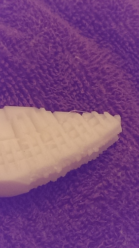

Hello. I have a AO-101 that’s been running fine until recently. The issue I’m having is that it will stop printing at a random time, sometimes a min or two into the print, sometimes further in. It will just hang, and when I try to send new commands it will say the printer is still printing (on pronterface). I am unable to disconnect, and I have to close pronterface (which crashes), and unplug/replug the USB cable.
I’ve been trying to debug this for a while, and I found that the printer works fine on my other computer (a laptop) where I have not updated anything in a few years. This leads me to believe that it’s my USB port or the driver on it.
