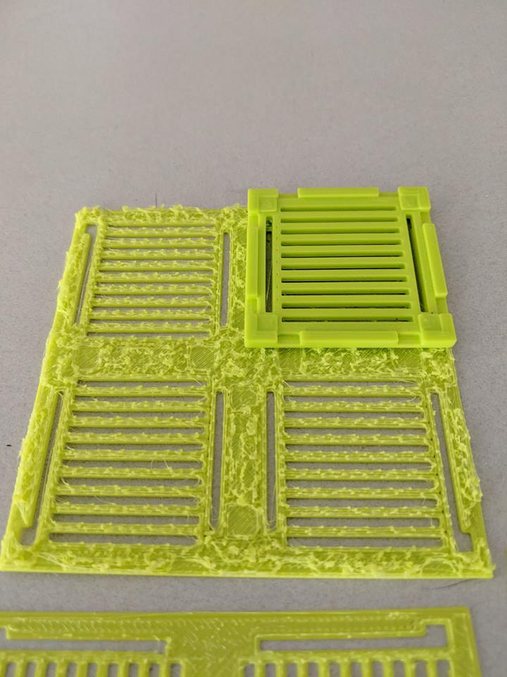

Disregard the above. The z-hop bug is still in there. I believe 1.1 is still unusable.

Once again the z-hop bug has resurfaced. Looks like it’s still not ready…
