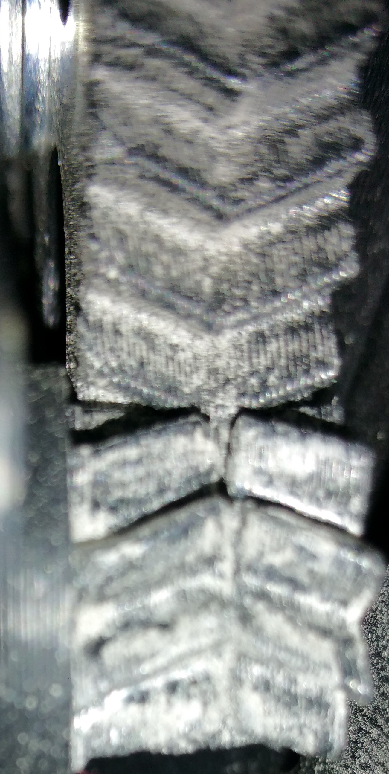

Hi, This is my second print on my TAZ4 after a good time spent calibrating the bed. Aside from the layer splitting I’m very happy how the print came out. Although it would be even more awesome not to have it split. Any recommendations?
I’m running 230c / 90c for the ABS print in the picture. I had no problems with lift at the base; I’m using ABS Juice.
You may want to cover the printer when printing larger objects with ABS. ABS has an inherent material characteristic of shrinking when cooling. Increasing the amount of time the part needs to cool (by enclosing it, or by maintaining a warm environment around it) will help. Printing with PLA will help tremendously.
