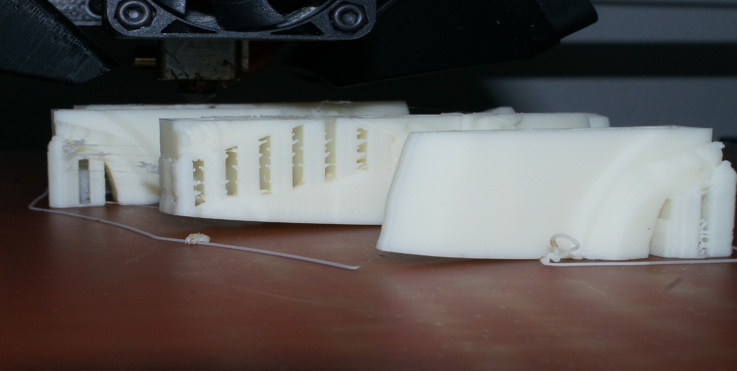

I started a big job (about 175 g) and when I came back in this was the mess surrounding the print head. I removed the extruder head and the big gob is not coming off easily. I called support since the printer is under warranty, and they suggested sending the head in.
Any suggestions for me to try before sending it back?
