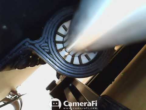

I have at least 1mm vertical play (I can see the bearing shift relative to the rod) on the y axis, and a small but visible play in the x axis. I am rather surprised that these bearings wore down after only 7 Kg of plastic.

I don’t think this has anything to do with the 3D printed parts. I took a video to show that the wear was on the purchased bearing.
I’ll know more when the replacement bearing arrive and I take the machine apart.
(Weird, the youtube link did not work until I removed the “s” from the https: part of the link. Apparently, Firefox is adding an additional “s” so it gets “httpss:” and it gets confused. Anyway if that link does not work here it is in plain text: https://youtu.be/18L_bJcZ_i8" )
Vertical play in the Y bearings like that is caused by gravity pressing the bearing against the rod. Look more for horizontal movement on the bearings. Left and right movement on the Y table ones and backward and forward movement on the X axis ones. The weight of the bed and extruder pretty much force the bearings to ride on the top surface of the rod all the time.

Ok. If you measure the height of those bearing fins on that bearing, and on a brand new one, you will find they are identical. But if you don’t think thats what the issue is, thats fine too. Its your printer.
Update: I got the replacement bearings today. The new bearings have almost, but not quite as much play as the original, so Piercet is right. At least the lesson I learned was rather inexpensive.
I am very surprised to find equipment like this with as much designed in play as this one has. If this were a milling machine, it would be scrapped as warn out.

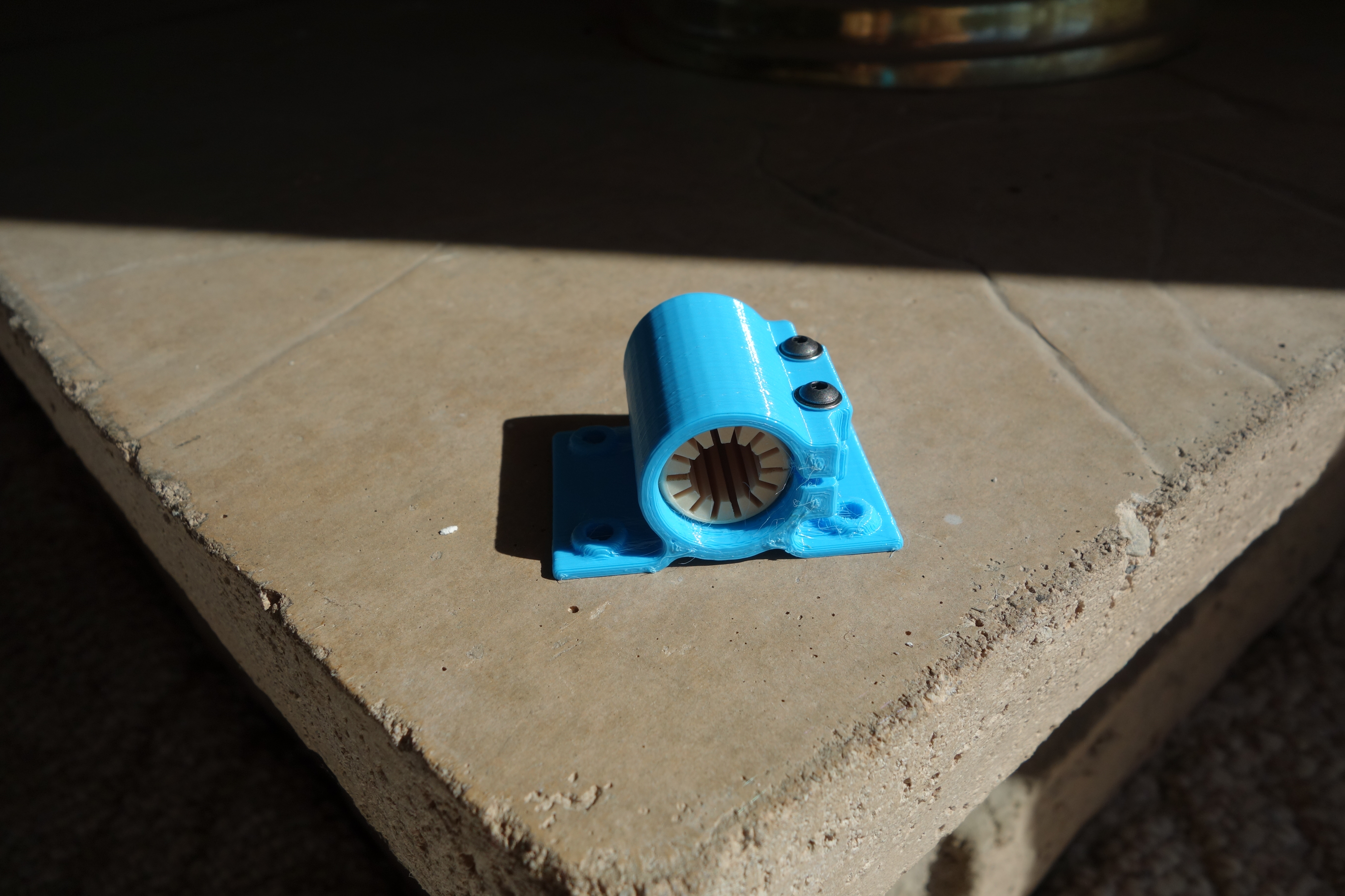

Now that I have two sets of bearings, I’m thinking of running a hacksaw between the fins to cut the outside frame. Then print a set of modified mounts that allow me to squeeze out the play with a hose clamp. This would also allow me to tighten up the bearings as they wear.

I have designed an adjustable bearing holder:https://www.thingiverse.com/thing:2974994
So far, the friction goes up to unacceptable levels before the play is eliminated (the play is mostly between the bearing and the holder at this point). I think if I fill the space between the bearing and the holder with glue, and clamp it hard to the shaft, when the glue hardens, I should be able to loosen the clamp to the point where there isjust a slight drag it should work without play.
