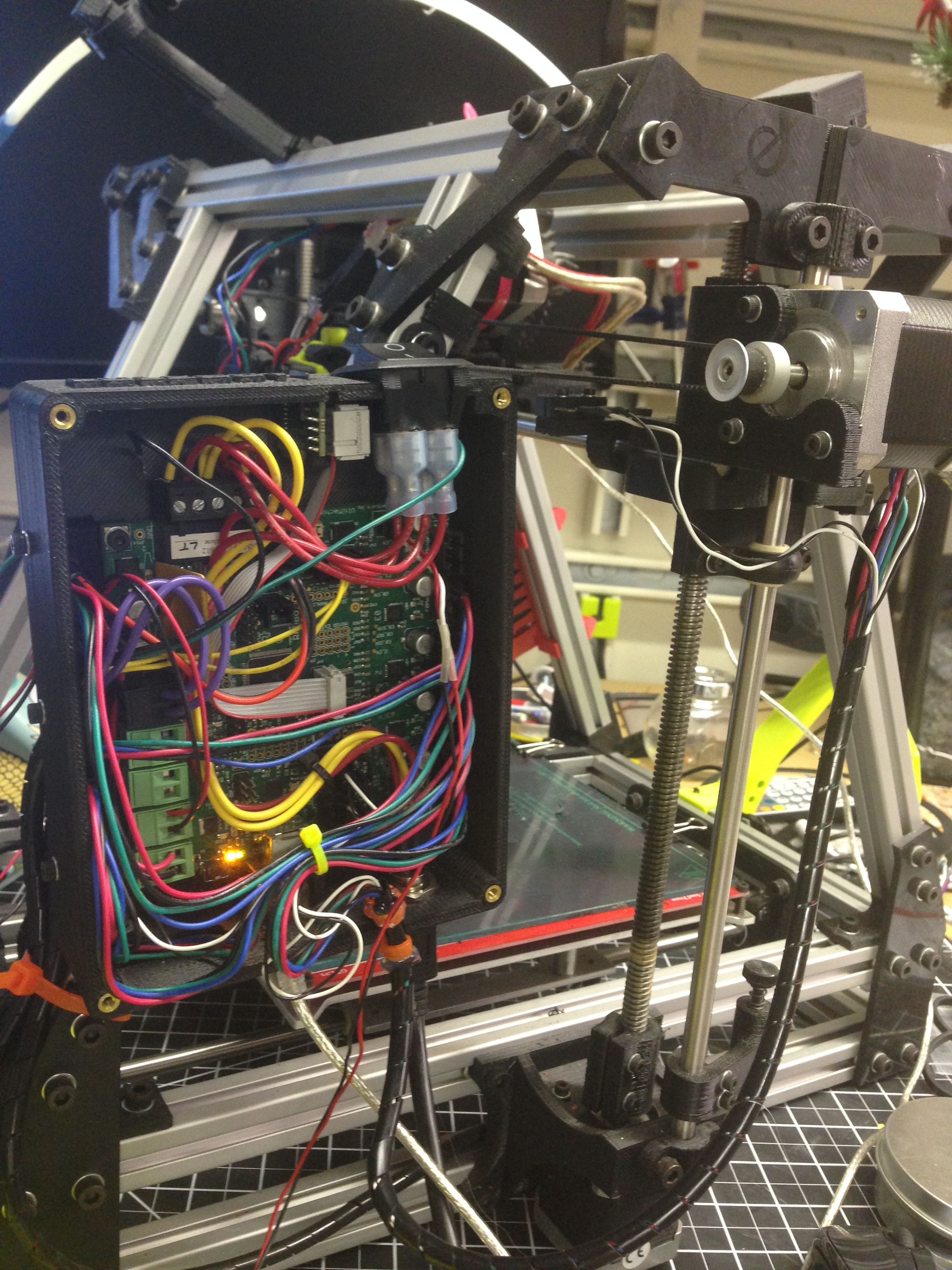

You could also get longer z axis guide rods and get another 20-30 mm on the Z axis on top of the 160 you have already achieved.
Anyway, thanks for the mod upload you saved me a ton a time in solidworks.
Is there any leveling you need to do beside the bed? I am concerned that after doing this the vertical axis isn’t perfectly perpendicular.
You just want to use a square with it and make sure all the 90 degree angles are 90. It’s kind of self centering. as long as you don’t touch the Z motor mouunts, everything else will space properly assuming flat parts.
I performed this upgrade with no problems. I left pretty much all of the fasteners a bit loose until they were all assembled, checked the squareness, and then tightened them all. Works well.
I have had the hardware installed but finally got around to updating the configuration file.
Just to be careful about the wires for the X & Y endstop and the X axis stepper motor.
I ended up having to move my control box.
