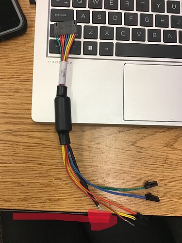

I have a new harness that goes from the rambo board to the connectors that then go to the bed. My next thought it how to I rewire a new thermistor? The harness I have also requires taking a black wire and merging it with a red wire that I have on my harness (its for the motor ext 1) Do I have to take those wires out and add a new connection? I know that probably doesn’t make sense. I will add pics.
The wires from the thermistor to the 2-pin on the side of the build plate are red, from that harness, they yellow wires that go into the back panel, and then stay yellow. You shouldn’t have to mess with the EXT2 section for this.
It sounds like you verified that you had proper resistance at the ends of the red wires by the bed. Now, check for continuity on the yellow wires from the harness that plugs into the board to where the yellow meets the red wires by the bed to determine where the break is. It’s not uncommon for the red wires to sag to where they can be damaged by the movement of the bed, so that’s where I’d start looking.
You don’t know how much I appreciate your help. So I noticed something, when I plug the wires back (yellow and red connected to the bed) , it reads the same, about 109 ohms. It does not drop to 74 like yours. Does that help in any way?

Do you think that I should use this new connector ? If I use it , I have to take the red wire out of that “ext2 section” and replace it with the one for this new harness. Do you think that will solve the issue?
Don’t bother until you find out where your connection has failed with the old stuff. Shouldn’t take more than a couple minutes with a multimeter to find what wire has failed.
Went ahead and used a brand new connector harness, before I read your response. Still the same issue:( I just don’t get it ! Thanks for trying to help me. I’ll continue to tinker with it for the rest of my life. lol
My advice is still the same - test each of the wires for continuity all the way from the board to the 2-pin harness. Those wires get flexed, so a break might not be evident until the wire gets moved around a little, leading to intermittent failure, but if the machine ever loses connection with temp sensor, it will immediately halt.
Fixed it !! So it ended up being the harness that goes from the bed and clips into the wires that go to the Rambo board . I ordered a new one a few months ago and I think that when I was installing them , I switched the wires and ended up keeping my original faulty wires . So today, I decided to try what I thought was the broken wire set and boom it worked . I have literally been working on this thing for months. I can’t thank you enough for all of your help and time!!
