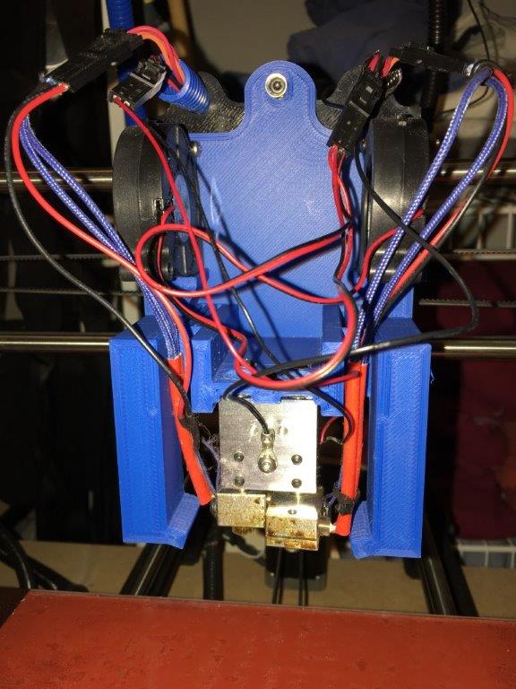

Hey Invent,
I’m trying to convert a TAZ 5 with almost the same setup as you have on your Taz 4 with dual bondtech extruders and 2 E3D hotends or a Chimera. Can you give me any recommendations as far as settings go and what I’d need to modify on the printer. I’m just starting to get into it. Any help is greatly appreciated.
Thanks,
Hey ajp1976,
Here’s some information for you:
- Extruder Mount - You will need an extruder mount for the Chimera. Here is a pic of a design originally posted by mushoo that I modified so that I could mount the Chimera with the nozzle height adjustment screws facing out. I also added slots for bowden clips to eliminate movement of the bowden tube and added printable support so there is no need to ask the slicer for support; I added a few other mods as well. The stl’s of the mount and the bowden clips are attached. The two fans in the pic are blower style and purchased from Amazon (http://www.amazon.com/uxcell-Connector-Brushless-Blower-Cooling/dp/B00H8VV0XK?ie=UTF8&psc=1&redirect=true&ref_=oh_aui_detailpage_o00_s00):
- Bondtech Dual Extruders - The TAZ is dual extruder ready; however you’ll need to add a second extruder wire harness because it doesn’t come with it. I bought the Lulzbot Flexy Dually and it came with this harness. It’s easy enough to build one yourself and possibly Lulzbot sells it separately. I’m guessing it is configured the same as the stock extruder harness, but I would verify this. Here’s a pic of the second extruder wire harness (it’s the blue one) attached to the electronics box. Some of the wires will run to the 2nd Bondtech Extruder and some will run to the 2nd hotend. The way I configured it the 2nd extruder wire harness runs the hotend cooling fan and the original stock extruder wire harness runs the part cooling fan:
Fortunately both the stock and 2nd extruder wire harnesses are long enough to reach the top mounted Bondtech Extruders. I had to splice the wires into the wire harness that comes w/ the Bondtechs; although last I checked I thought I remember seeing a TAZ compatable connector now available with the Bondtechs. Here’s a pic of the extruder wires running along the top of the TAZ frame and attached to the extruders:
- Firmware - I loaded the Marlin dual extruder firmware that Lulzbot had available at the time. I’d be happy to try to send it to you if you’d like. In the configuration.h tab the steps for the Bondtech extruders need to be set to 476.55. I believe here’s all the changes I made to the firmware, no warranty implied

I would also refer to the dual extruder setup posted on Lulzbot’s website to glean additional information on the basics although keep in mind this is for their V2 hotends, not the Chimera or other style hotends (https://ohai.lulzbot.com/project/dual-extruder-v2-tool-head-installation/accessories/). As far as slicer settings, I can post those later. Hope this helps. Please let me know if you need any additional information.
