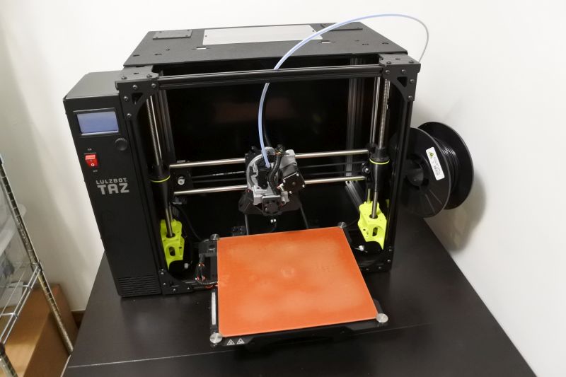

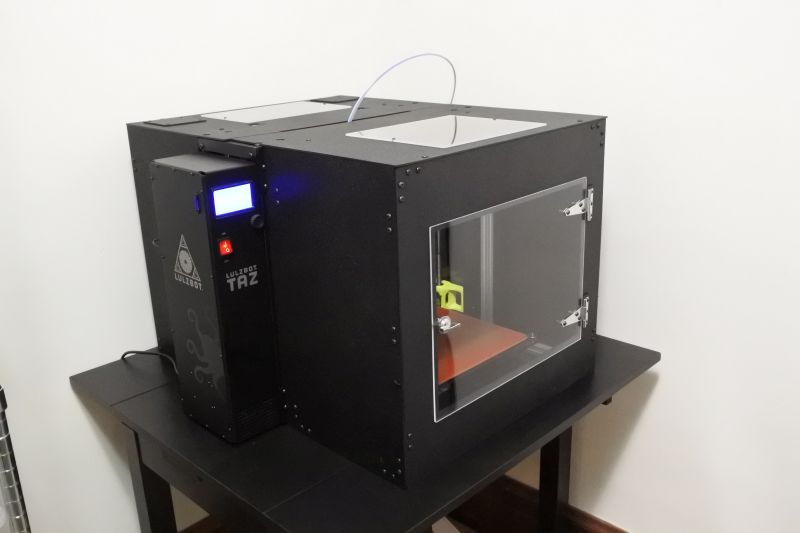

After encountering some warping issues on my TAZ 6, I designed and built an enclosure to help keep the environment consistent. The electronics is outside of the enclosure and it fits the outside of the TAZ 6 like a glove. There are cutouts for all the protrusions on the frame including screws and the spool holder system. I’ve got two fan mounts for adding ventilation later and I’ve also got a couple of mount points for adding a spool holder on top if I want it.

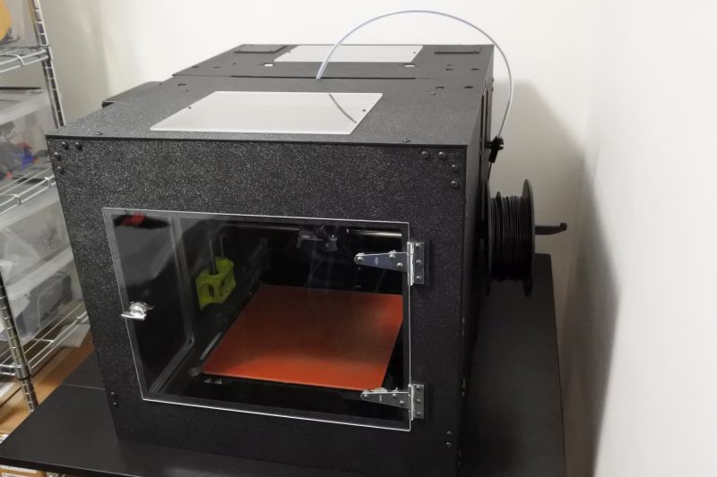

The whole enclosure is designed in two sections to allow easy portability and so that I can remove the front if I need to get at the workings of the machine. There are also easily removable cutouts that provide handles on the enclosure for ease of transport. A large latched door is made of acrylic and there are two windows on top to allow light and visibility. But otherwise the outside is made of ABS connected together by V-Slot and Makerlink.
Feel free to ask me any questions about the design. Or if you notice an inconsistency in the documentation or a way to improve the build, I’d love to hear about it.

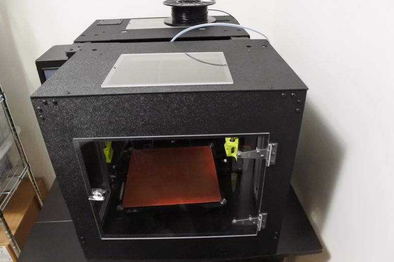

I just did some measurements on a print that has been going for around 1.5 hours. I think at this point it is at a steady state in terms of temperature. I’ve got an IR thermometer which lets me get temperatures by shining it into the gap for filament at the top. I’ve got a 240 C extruder temperature and a 90 C bed temperatures (so a bit cooler than you).
Room temperature: 23 C
Hottest temperature on outside of enclosure (near gap at top): 33 C
Hottest temperature on pointing down at PEI bed: 80 C
Temperature on printed part (top layer, but not newly laid down): 60 C-70 C
Temperature on plastic parts of extruder: 45 C
Recommendations on ABS seem to be that it should be kept below 70 C for working temperature. The hottest plastic parts I could find (on the extruder) seem to be nowhere near that limit. So I’m fairly confident that I am not damaging my printer by enclosing it. It seems like it would only be a danger if you spent more effort to really seal up every crack or if you had a secondary heating element.
