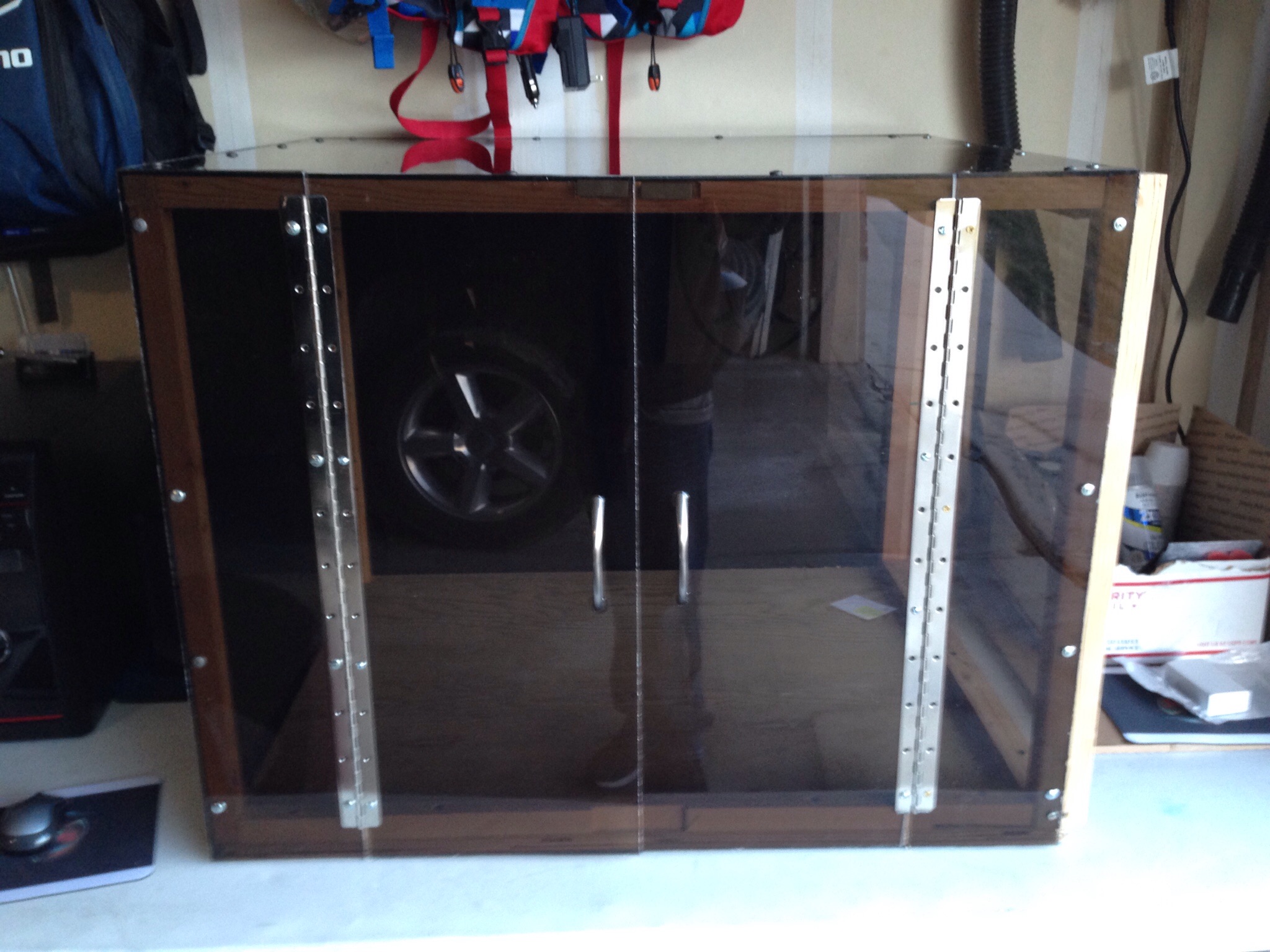

Still need to suspend filament over printer, not sure if I should attach filament spool to printer or ceiling of enclosure. Probably ceiling in case I do double extrusion.
Still need to cut Plexiglas front and determine how it will be attached, I’m thinking clips on the side and top. It is hard to see but there is a lip that it sits on, so the weight will be supported. Clips should make it easy to remove and attach.
Still need to cut shelves for bottom compartment. This will be storage for filament and all other things printer related.
Still need to figure out venting system. Thinking a duct out the same side the power line and usb chord go it, but up at the top obviously.
Still need to figure out lighting, do I want and need it?

Egg on my face. So I fired up the TAZ tonight in the the new enclosure, homed the X axis, wonderful, homed the Y axis, here comes the egg. I didn’t account for the fact that the heated bed actually extends beyond the most rear vertical face of the Y motor mount. Got my hand to the off button as fast as I could after the noise of the stepper motor yelled that it was trying to push the printer bed through the back of my enclosure but couldn’t. So trying to design this enclosure to use a standard precut panel of 2’ x 4’ might not work out. I’m guessing I could (through firmware?) reduce the printing area of the TAZ so it does not extend the bed out to these extreme distances. Decision to be made later.
Pulled the printer forward the few millimeters it needed to home the Y axis, and finished homing it. Electronics case does not line up with my cut out anymore. Deal with that later. Tonight I printed out the hooks to hold the filament roll to the side of the enclosure. Works great having the roll up there, no problem feeding the printer. The hooks allow me to easily lift and remove the filament roll if I need to take the printer out of the enclosure. I designed the hooks to use the same 1" wood screw I used to build the entire enclosure. Before someone else points it out, I will do the honor, yes, this is not the type of screw I should be using because it is a wood screw with a countersink head type, I should be using a pan head type, preferably with a washer, that way I am clamping down on the layers and not using a screw that acts more like a wedge that can pry the layers apart if tightened to much. I printed a relief in the hook to accommodate the countersink on the screw head and made sure not to tighten it too much. I’ll admit I was too lazy to go buy the correct screws right now since the hooks were just prototypes to see if they work well, which it turns out they do, and they easily hold the weight of the 5 pound coils. I promise pan head screws with washers on the final design.
Question: What is the point of the filament feed tube if I am feeding filament into my printer in this manner? Do I really need it? Printed the hooks without it. Just wondering if someone could clarify.
These parts printed in the enclosure printed much better than my previous part not printed in an enclosure, so I highly recommend enclosures. Hopefully you will have better luck getting yours right the first time and can learn from my mistake
The filliament feed tube is designed to constrain the filliament so it meets the extruder at the correct orientation to pass through the hobbed bolt / idler assembly and that any bends are supported at a radius that is less likely to result in a filliament crack. Feeding from the top down like that you should be ok, though I would personally probably put something like the AO-101 style filliament guide (but pointed inside the frame if there is room)) on the top frame to keep the filliament entering the machine from a fixed point. REalistically though it would probably only be of use in preventing really wierd tangle situations.

For the enclosure I have, it’s practically sealed all the way around. There are two little side windows with magnetic locks, so you can open them up if you want to use PLA and keep things cooler or keep them locked shut for ABS to retain the heat. No ventilation other than a cutout on the side so the cooling fan on the electronics enclosure can get some air.
Even with my enclosure sealed up pretty nicely, I still get cracks in tall thin ABS prints. I haven’t tried a heat lamp to see if that helps. Most prints are much improved since there aren’t any drafts and the ambient temperature is warm, but not hot. So even without the heat lamp, the enclosure helps, but I do still get cracked ABS parts when I print certain shapes.
