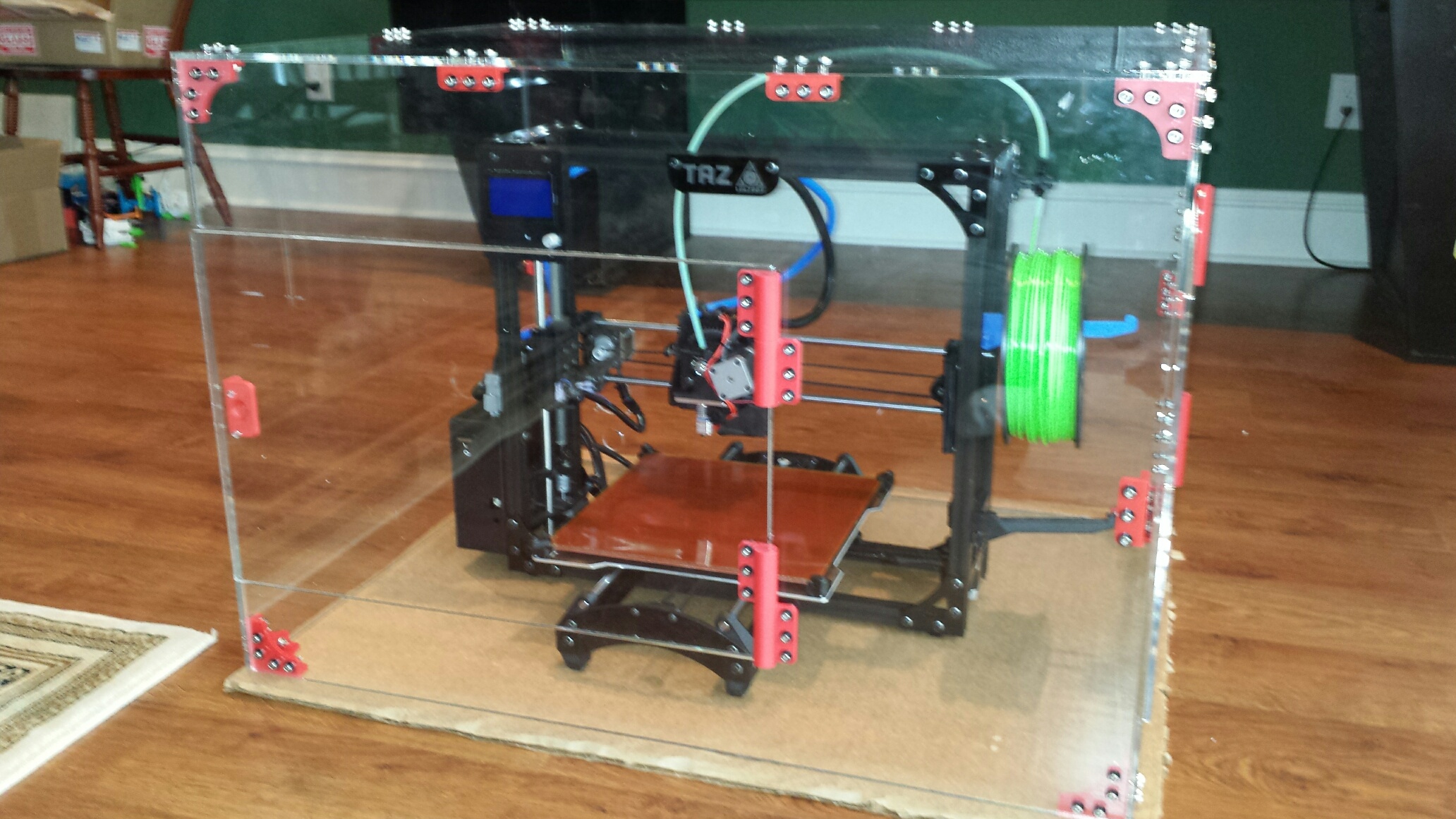

I’ve designed an enclosure and have the laser cut acrylic on order but haven’t received them yet. I am probably just going to post the drawings on thingverse once I prove out the design. I was thinking about offering them for sale, but frankly it ended up being so expensive I doubt there would be a big market for it. It uses someone else’s design for printed components for connecting an enclosure together: thingverse: http://www.thingiverse.com/thing:675652 to assemble the design. Note these parts are not my design, I just developed the drawings I needed for the panels. He gives the size of the sheets but of course doesn’t provide all the little details like hole locations etc. I’ve worked all that out on CAD.
The laser cut sheets were north of $400 (without shipping) and the printed parts took a couple of days of printing. The hardware is probably pushing $50 or so. Then there is the ventilation fan, magnets and the door handles. So in the end I would have had to charge close to $1000 to make it worth my while, which is ridiculous for a box.
But an enclosure is very important, not just for print quality but also your health. Printing with some of the exotic materials available you don’t want to breath those fumes. I’ve built in a vent fan mounting location on my enclosure and will run the vent through the wall of my shop and outside. Even ABS which is generally considered to be safe smells bad. And there are some who claim that printing any material is potentially dangerous because they emit nano-particles which could be potentially dangerous.
Once I receive my panels and assemble it and prove the design I will post the design here and on thingverse for anyone that might be interested.

I did go with Acrylic, 1/4: thick. I wanted an unobstructed view from any angle. I did add a second door on the right side, but kept it the same size. Also, because this is essentially a cake box, if the doors are too small I can always just lift it off the Taz if I need to work on it with more room.
I wanted laser cut because of the tight tolerances and clean finish. The doors will fit nice and tight since they are being cut with a shared line on two sides, leaving just 2mm total clearance (1mm all around).
Regarding the printed parts, they are nice. The only issue is the corner bracket is messed up (on that thingverse page) so I remodeled that one. (I found out later he fixed it and posted it elsewhere after the fact) If you want me to post my version of it here I can. Also I don’t know how well the hinges will hold up over time. I ended up reprinting the hinge part with the rod, and did the top 60% of that at 100% infill. There will be a lot of stress on those. I don’t know if they will break or not. It might be better to go with metal hinges for the doors.
I should have the panels on Friday and will assemble it this weekend. If it goes together without any problems I will post the dxf file of my panel drawings. Then anyone can get them cut, or mod it to there liking.

Ok great success. The enclosure panels fit absolutely perfectly and assembly went well, if not tedious, with well over 100 screws to assemble (closer to 200). I used 10-24 stainless hardware with nylon washers. The design is good. I would change one thing however. Currently the enclosure is roughly 34.5" wide x 27" deep x 24" high. If I had it to do over, I would make it 32.5" wide x 27" deep x 27" high. This is because at 24" high, the filament tube(s) will impinged on the ceiling of the enclosure. It probably won’t hurt anything, but I don’t like it. Also, 34.5" wide is really wasted space. 32.5" wide is plenty. But over all very happy with the design and it looks fantastic imo.
Attached is the DXF file I sent pololu to get the panels laser cut. Be warned, it’s quite expensive ($500+ + shipping) but also quite beautiful and precise. Of course you can buy the acrylic and cut it yourself, and save $300 or so, but you’ll never get the precision of the laser cut. The doors fit is amazing.
I’ve also attached a photo of my constructed enclosure.
ps. Be sure to download my version of the corner bracket from this thread instead of the one from thingverse if you use this dxf file to make your panels!

I used #10 screws with locknuts and nylon washers. I used 7/8" long but you could go .75"
You will need well over 100 screws and nuts, best to buy two boxes of 100 each.
Also I should mention I used the Taz nosepliers for a lot of the nuts, because there isn’t always enough room to use a socket unfortunately. It was a slow and tedious process. But the enclosure is fantastic I really like it.
Another side benefit, it cuts the noise of printing down to almost nothing.

Don’t know if I mentioned it here, but you may want to make the enclosure 3" taller and 2" narrower. The filament tube hits the ceiling of the enclosure on mine for taller prints. It still works ok though. But I think it would be an improvement. The 2" narrower is just to cancel out some of the material used to make it taller. It’s a nice width as is but wider than necessary.
